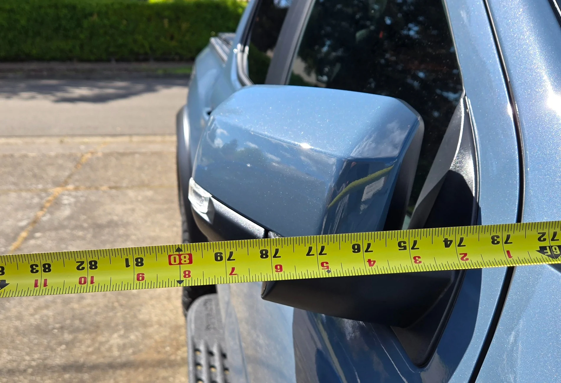

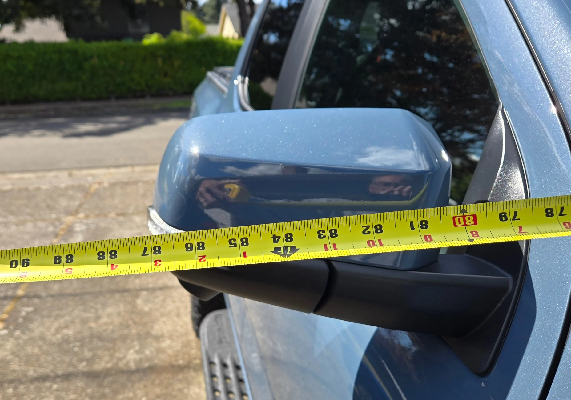

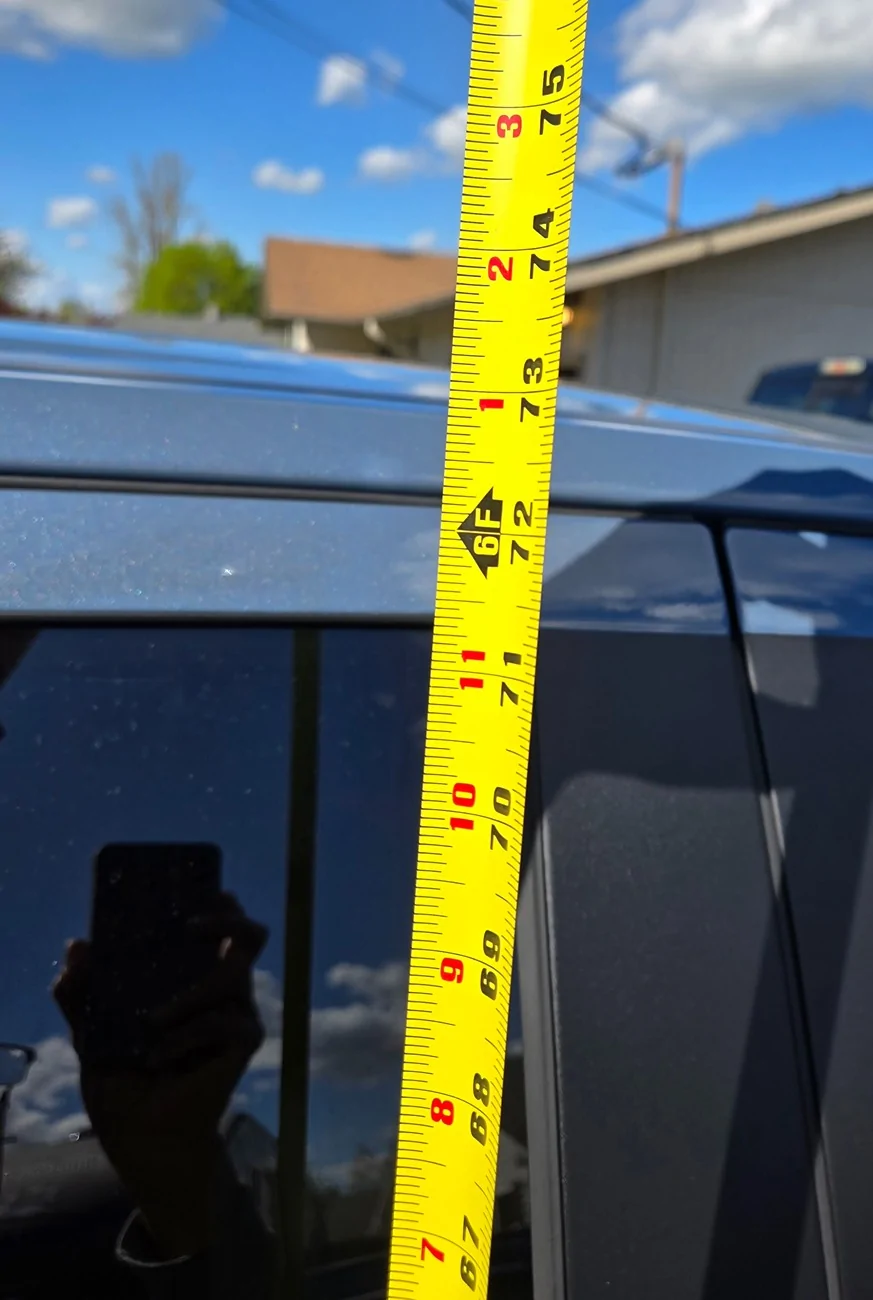

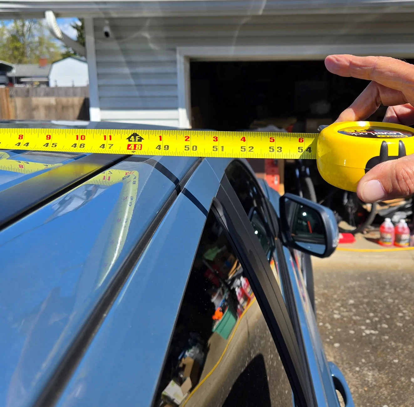

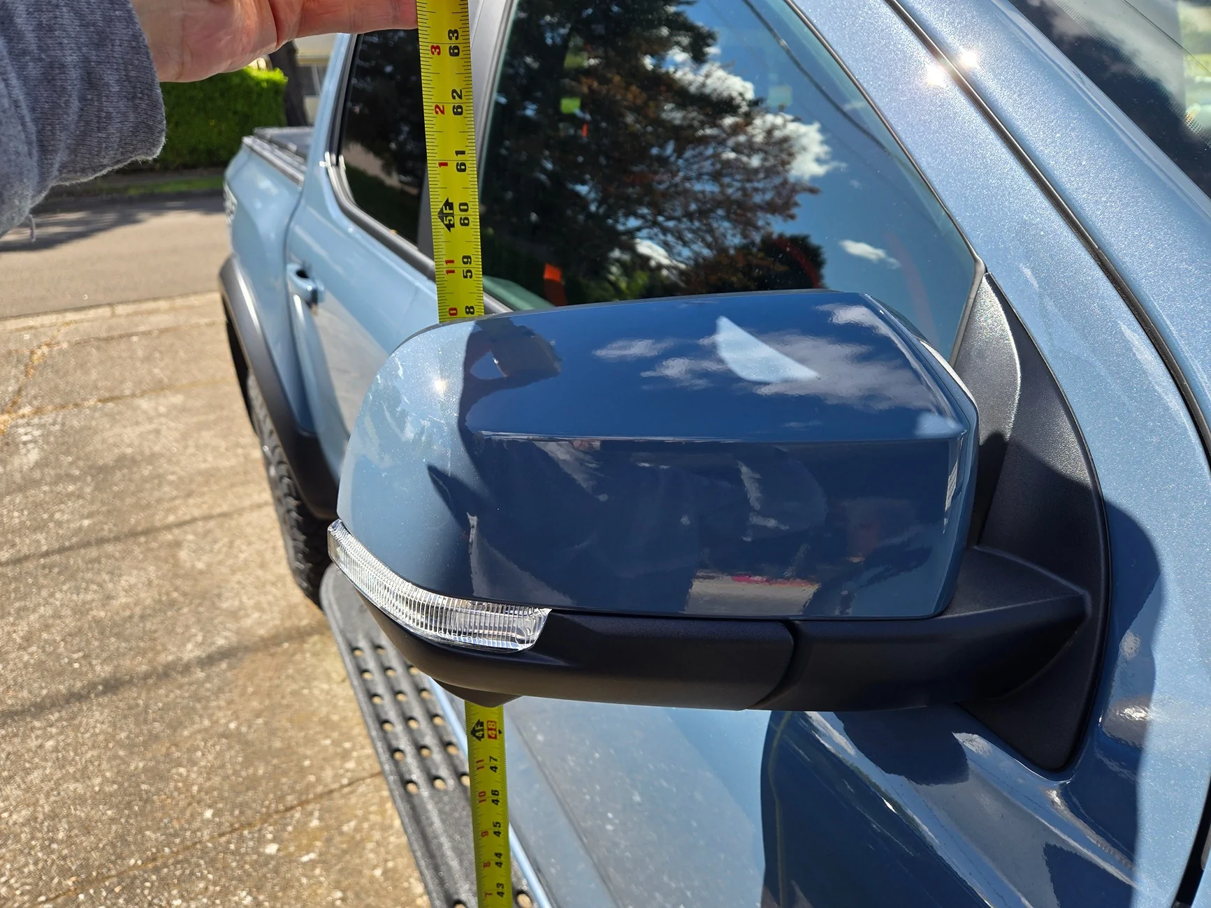

This is an odd request, but I have an arch shaped garage door that fits my Miata just fine, but I'm not sure about the Ranger Raptor. I have found the overall width of the truck online, but I don't know where along the arch of the garage that would be. I guess I need to know the height to the top of the mirrors, assuming that's the widest part of the truck.
Is that still the widest part with the mirrors folded?
Thank you,
Jonathan
OxygenMask
Phil
Feb 20, 2026
836
1,574
Eugene, Oregon
Here ya go. Mirrors in and out.
The widest part of the truck with mirrors folded are the rear fender flares. Using 2 framing squares and measuring I get 83- 1/2 inches. Couldn't get a picture, not enough hands...

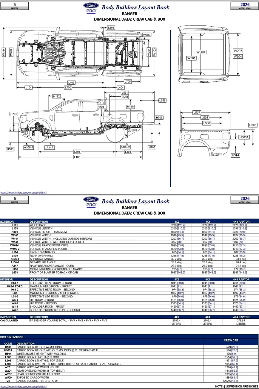

as per the buddy builder layout book, aka upfitter guide
Ford Ranger Height at the top of the mirrors? Screenshot_20260416_224404_Adobe Acrobat
