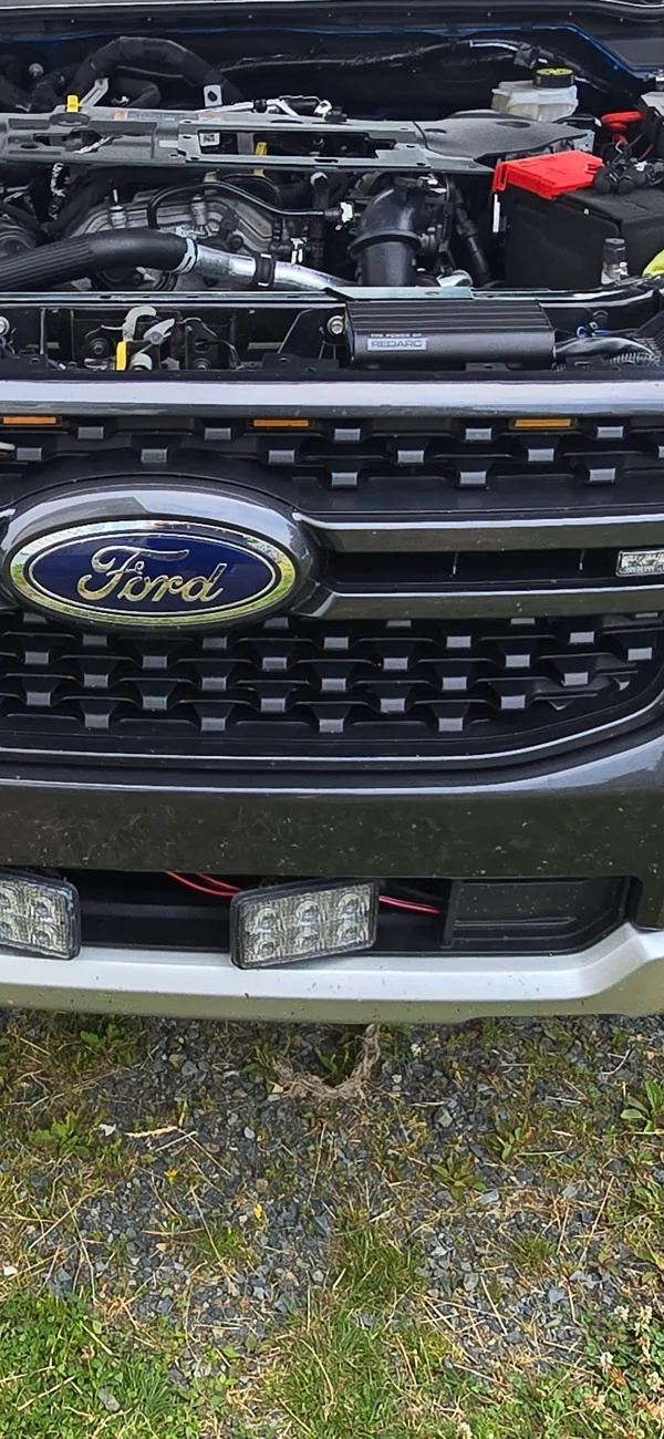

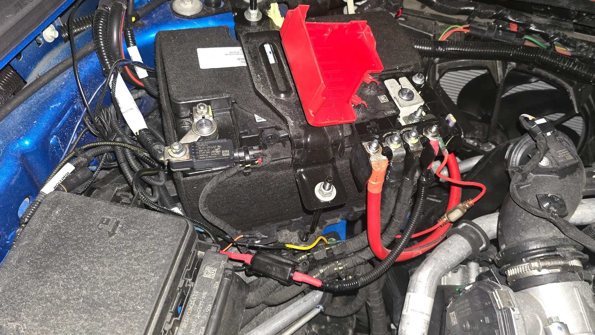

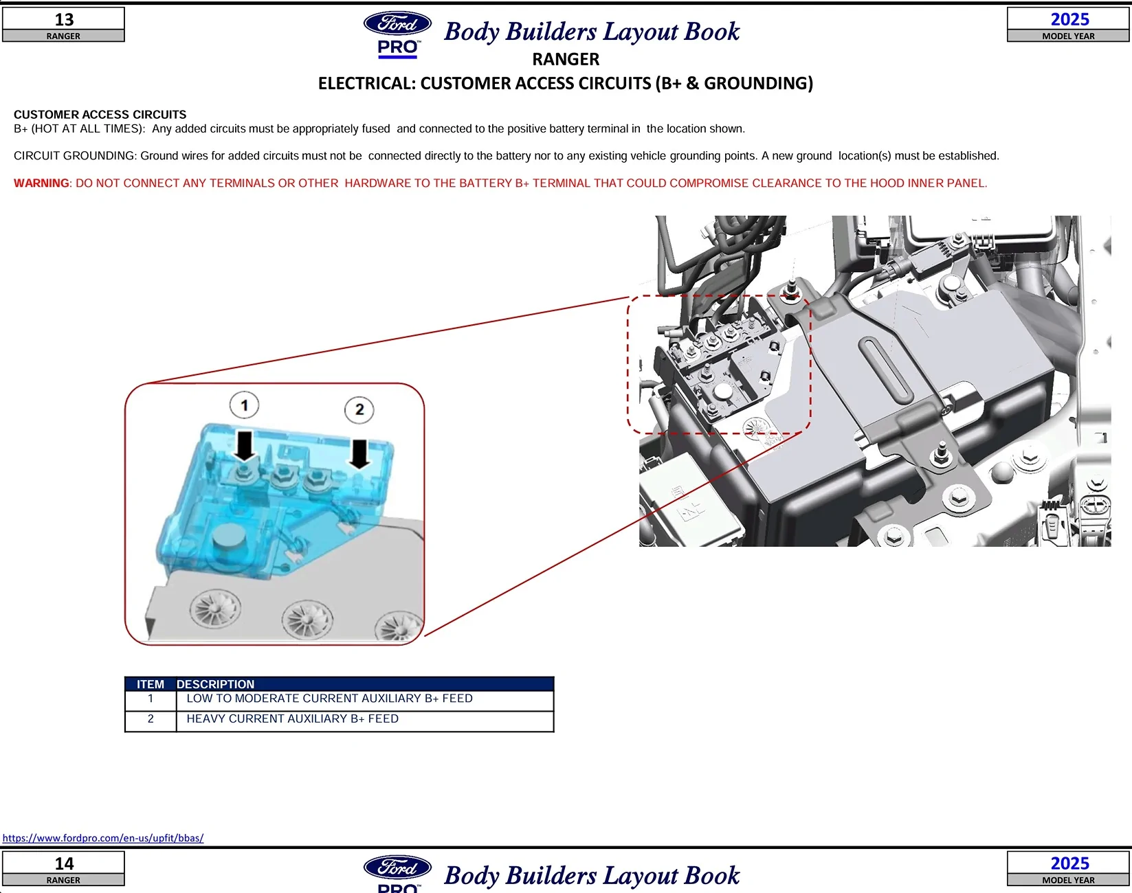

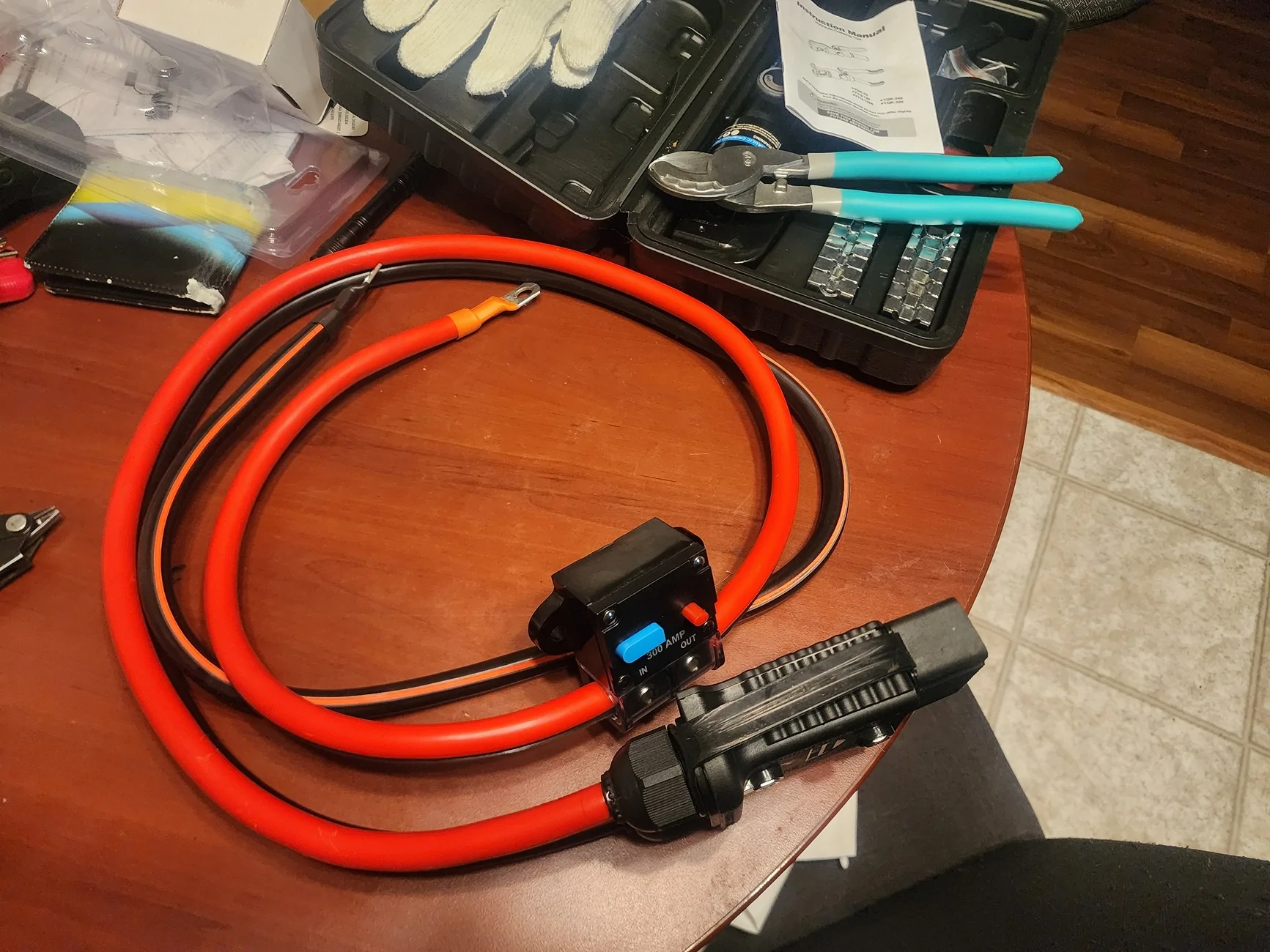

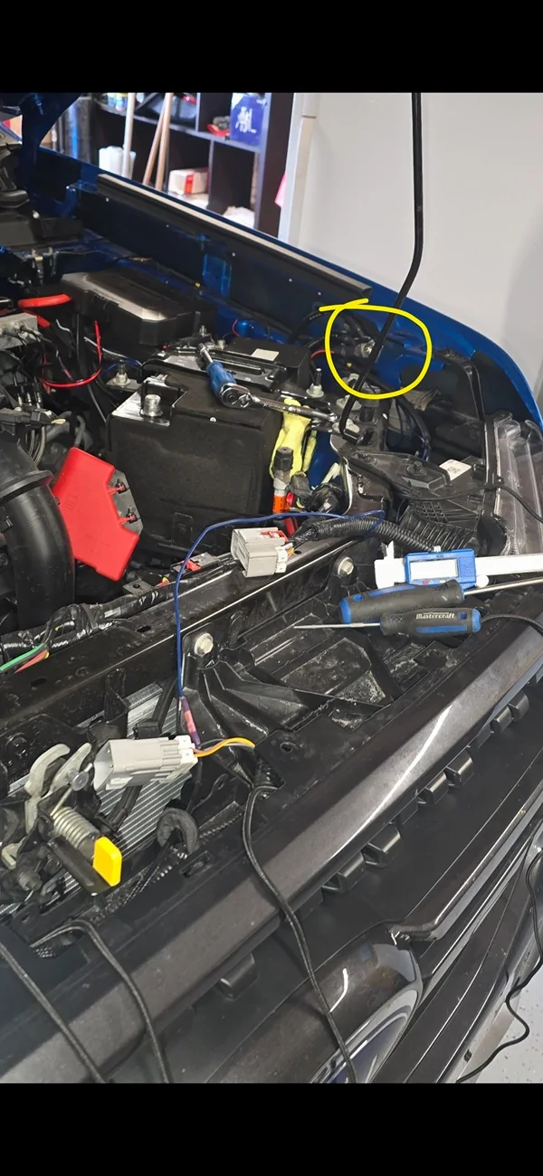

Got a set of engerizer quick connect booster cables, ypu can just see them behind the lights. depending how you are with basic hand tools and stuff, technically. I was able to run my booster cables with a small fish tape. I went through the rubber flap to behind the fog light, took off part of the wheelwell liner to get access behind fog to then feed the fish tape from the hole next to battery behind headlight, and route the cable up. it goes the left side of battery/driverside headlight(between battery and engine/grill not the left side of truck) and off to the battery. high draw stuff goes on the high draw side of the battery terminal, and low draw goes on the low draw if your using ring terminal. clamps go directly to the post.
and you're gunna use the ground on the fender. or after the BMS sensor on the negitive post(that block coming off it) the arb dual battery kit has you use then fender ground the battery is on. so my dual battery charger, and cables are on that ground.
