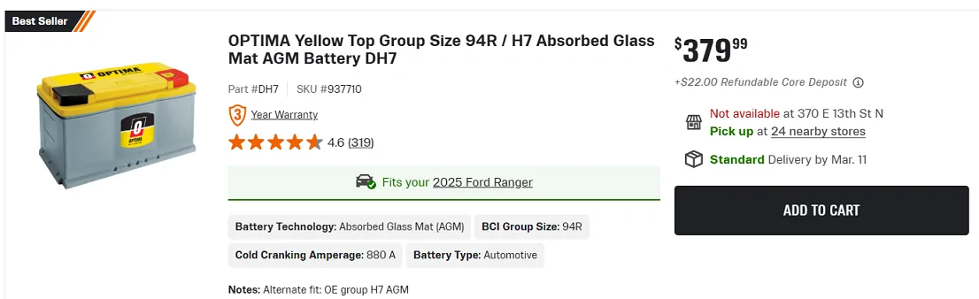

Ford Ranger H7 94R AGM Battery Conversion 1773093373606-24
The DH7 is the one Autozone is calling out for the Rangers.

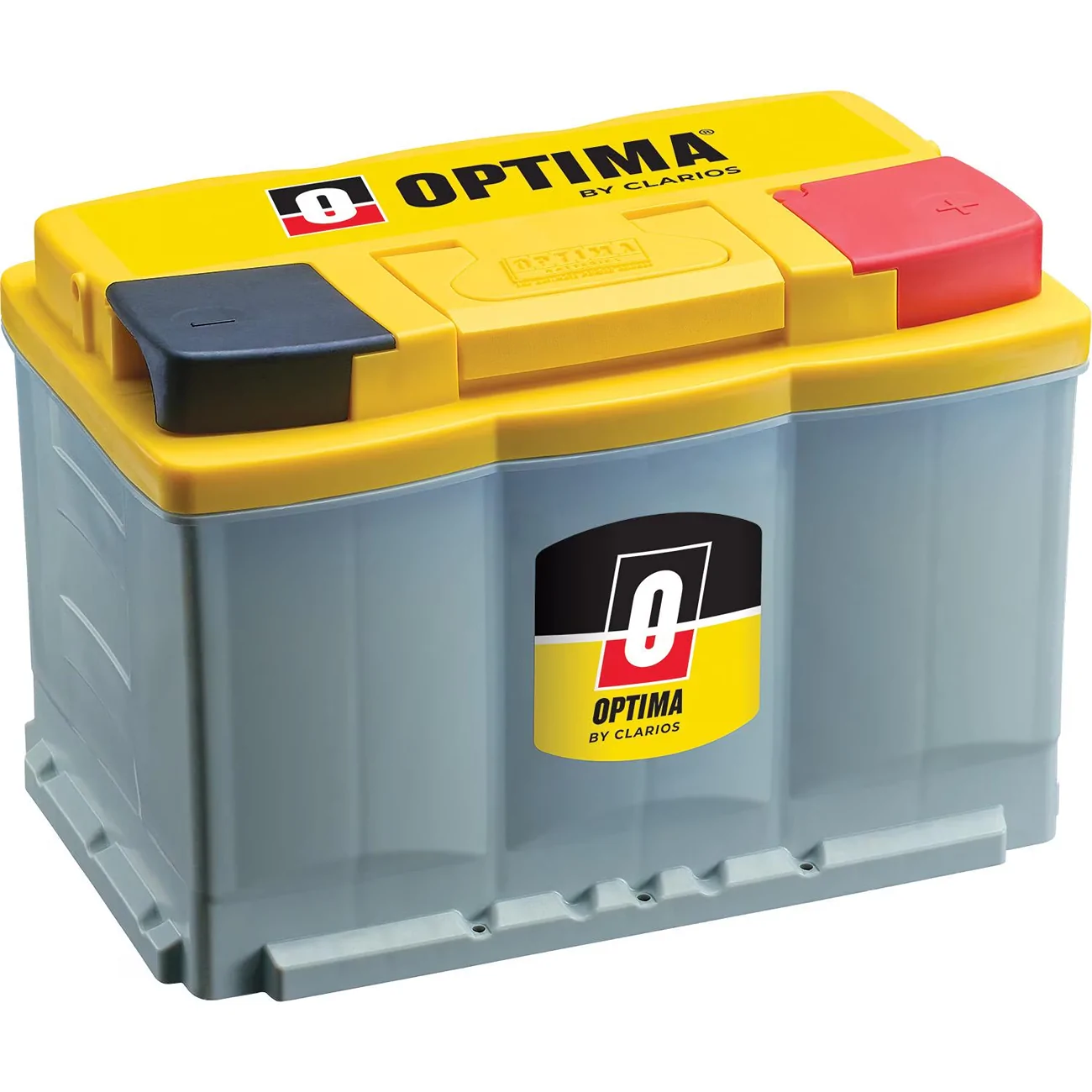

I am curious if odyssey has two different tiers if batteries like optima .
‘I never had much luck with Optima Red tops . 3rd red top warr in 2 years and the parts store manager suggest trying a yellow top instead , so I paid the difference and upgraded to the yellow top version.
15 years later and dozens of yellow tops since, and never had another optima needing warranted since Changing to the Yellow top series.
my son and i have a yellow top from 2011 still starting our little 318i bmw.

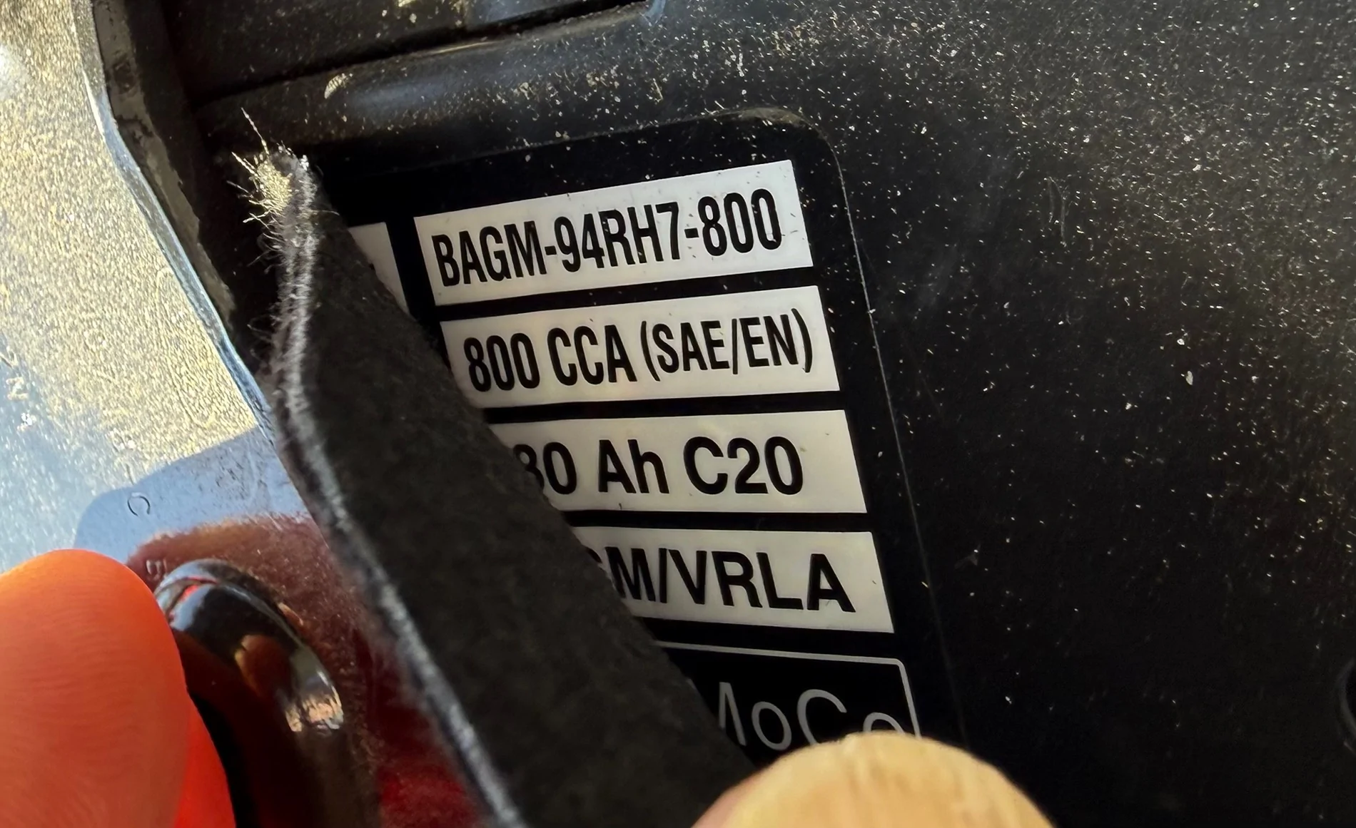

i was under the hood yesterday and i thought of this thread while i was hooking up the tender so i could play around in forscan some more.
i couldn't see the battery info sticker on the battery because of the cover but my battery looks just like the one in the first post, cover, wires, battery, the whole deal and when i was in forscan, i noticed my truck is set to agm already.
so i wonder if some stx/xl trucks come with the agm battery already? someday i will find out when i have to replace it but for now, is there a visual difference between the regular ol lead acid and the agm?
