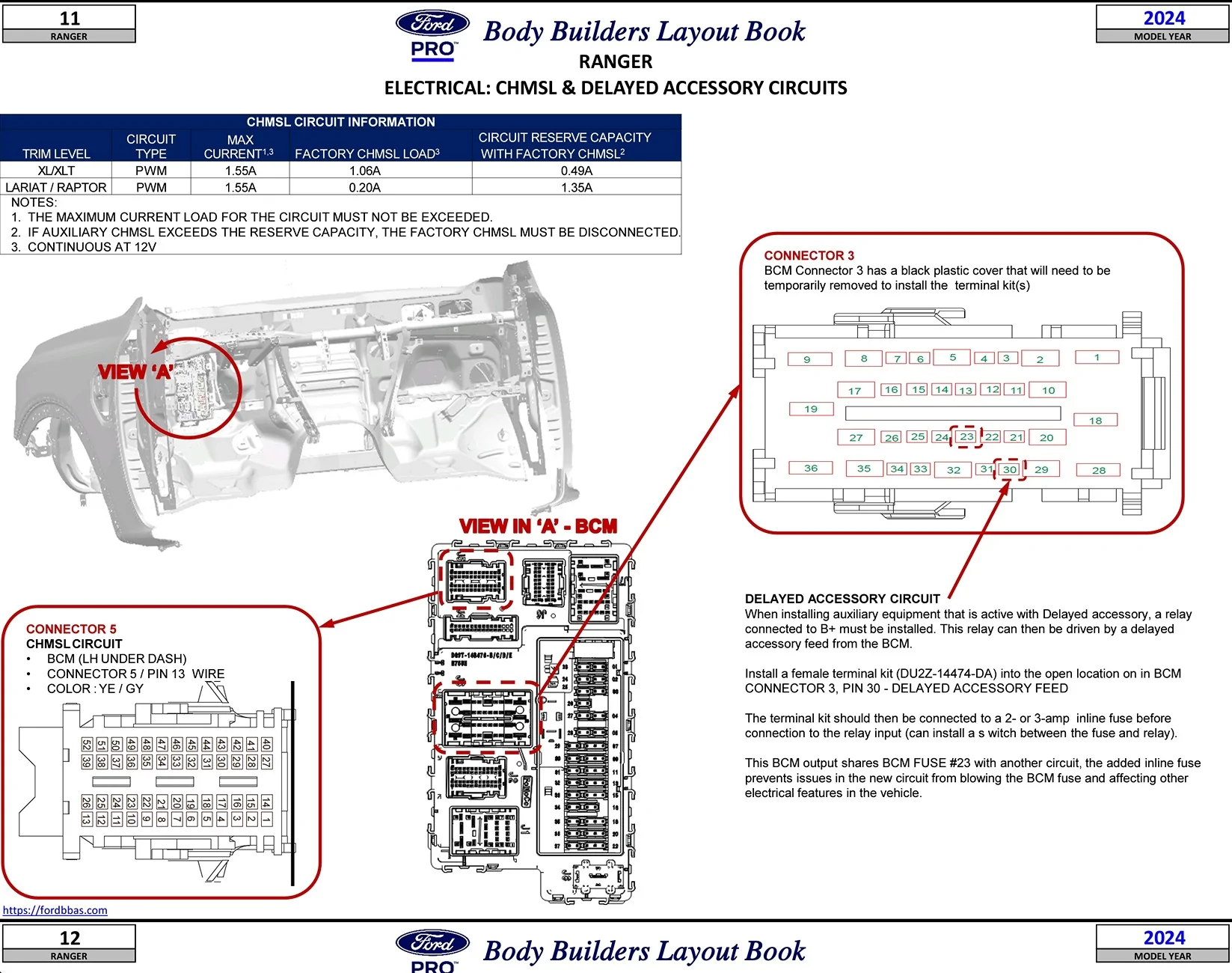

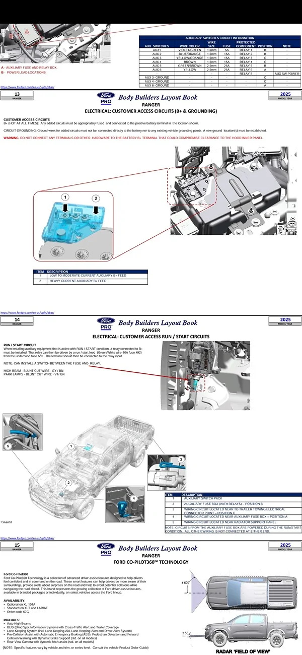

You only need to go at the bcm pons if your adding a cap for the 3rd brake, or a backrack with lights you want only brake.

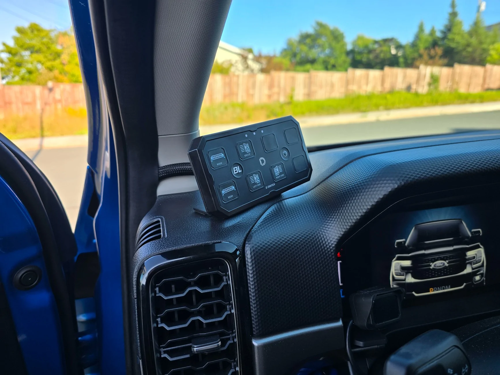

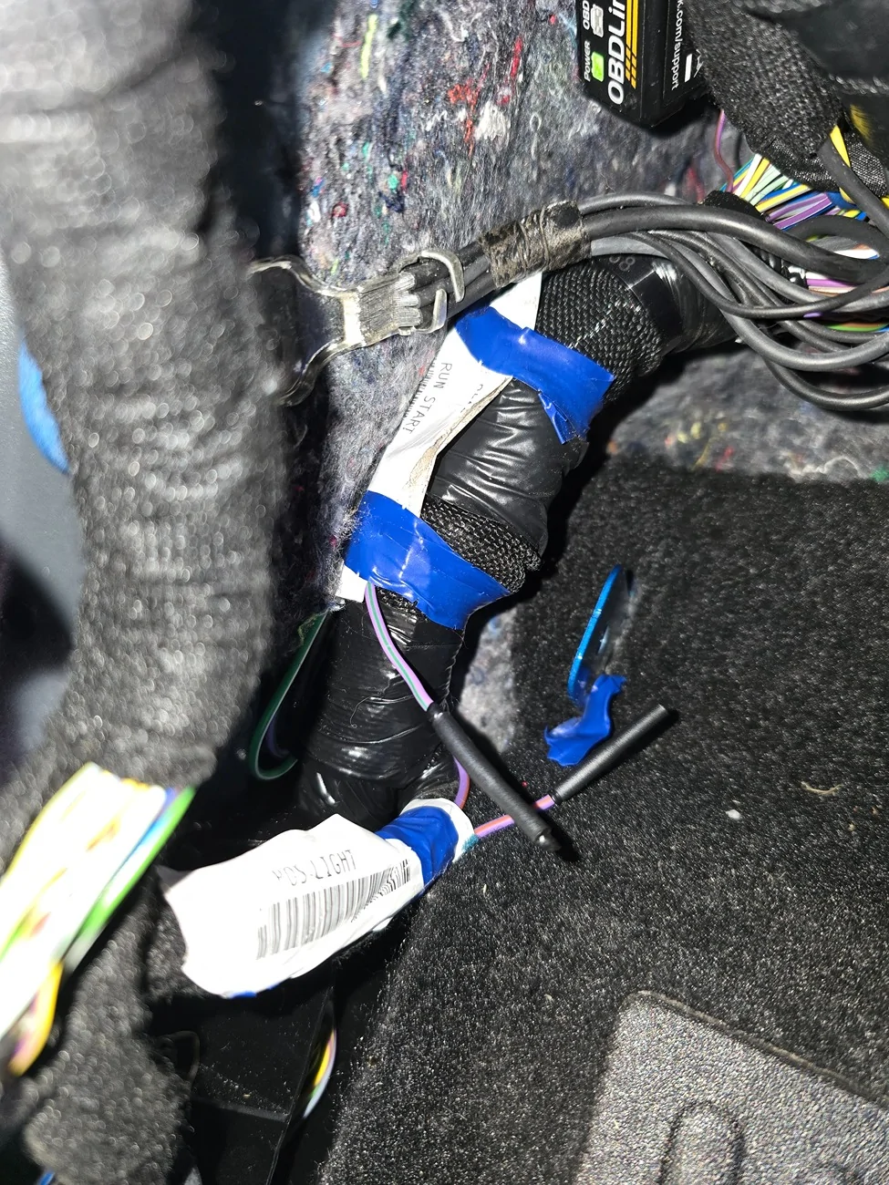

otherwise ford provides 3 blunt cut wires you can use to trigger a relay for marker, and highbeam, and a ignition run trigger. all 3 of these are hooked to my diode dynamics dswitch.
The ford body builder layoutbook aka upfitter guide got some great info in it.
my 25 xlt the physical labels ford put on the wires, they had marker and high beam mixed up, but the uppfitter guide had it correct.
Under the BCM/Trailer module behind the kick panel
oh awesome thank you so much!!
