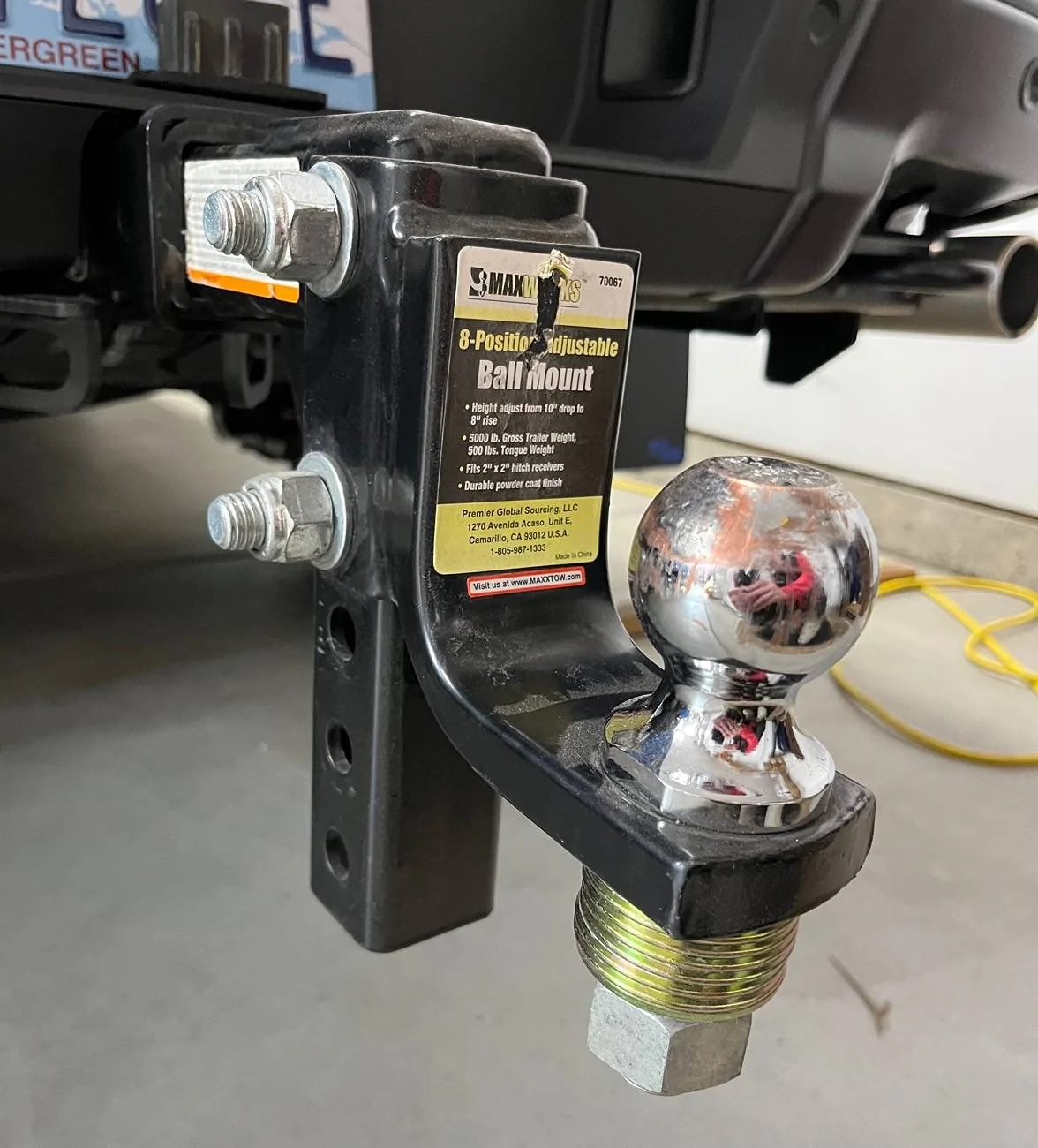

U Haul trailers are typically about 18” with a 2” surge brake coupler, what trailer are you going to be using? 19 to 20” (unloaded) off the pavement would be a good ballpark distance for your new ball mount. Depending on how much other stuff you plan to carry in the bed…. I like this 5000 pound rated one for lighter trailers.
Ford Ranger Towing Hitch Drop Needed? IMG_7139
For a tall truck, flip it over, I installed bolts in place of the pins, for security and noise reduction. The pins will drive you nuts on bumpy roads. I also used a long 1” shank 2” ball from eTrailer.com. By adding 1” ID HARDENED fender washers, shifting their location from the nut to under the ball, you can easily fine tune the trailer ride height so it is close to level. That is safer for a long trip, and it makes you look like a pro….
Ford Ranger Towing Hitch Drop Needed? IMG_7726
As shown in the last pic, the ball height is around 21”, with an empty bed, it might need to be dropped a hole for a U Haul trailer. FYI one of their car haulers is just over 2200 pounds empty. They tow very nicely, but I have not tried my RR yet. I used a 2013 Land Cruiser 200.

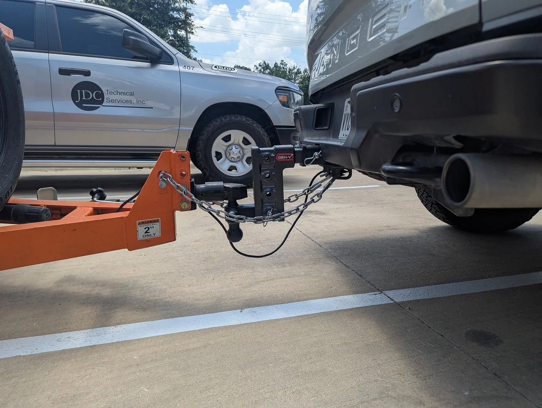

Update: picked up a 7.5" drop hitch from Gen-Y. It sits perfectly level with a 5x8 trailer from Home Depot.
