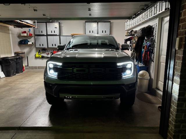

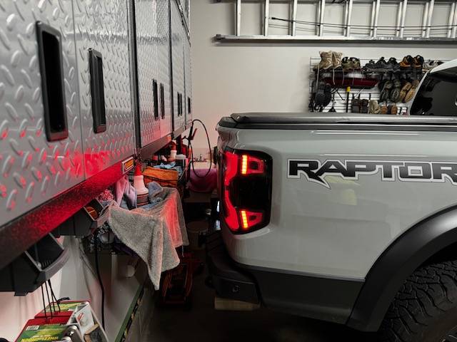

Had a similar question but with the tail gate in the closed position. I have cabinets that I park under with my current vehicle now. Allows me to pull in another foot from the garage door. From the garage floor to the bottom of the cabinet is 4” 3”. Does someone know the length from ground to the top of the closed tailgate? TIA
Measured mine at 56.5 inches.
1,858
1,714
According to Body builder guide it's 55.3 inches so I would go with above to be on safe side.
So at your measured 4 foot 3 inches it's not going to fit.

Yep... it won't fit underneath. Still fits in the garage but would have preferred being able to back up to give me more room around front. Had my friend's RR stop by last night and even though he has a cover on, the tail gate is still too high to slip underneath. I can move the baskets easily, but the cabinets are pretty much where they are going to stay.
