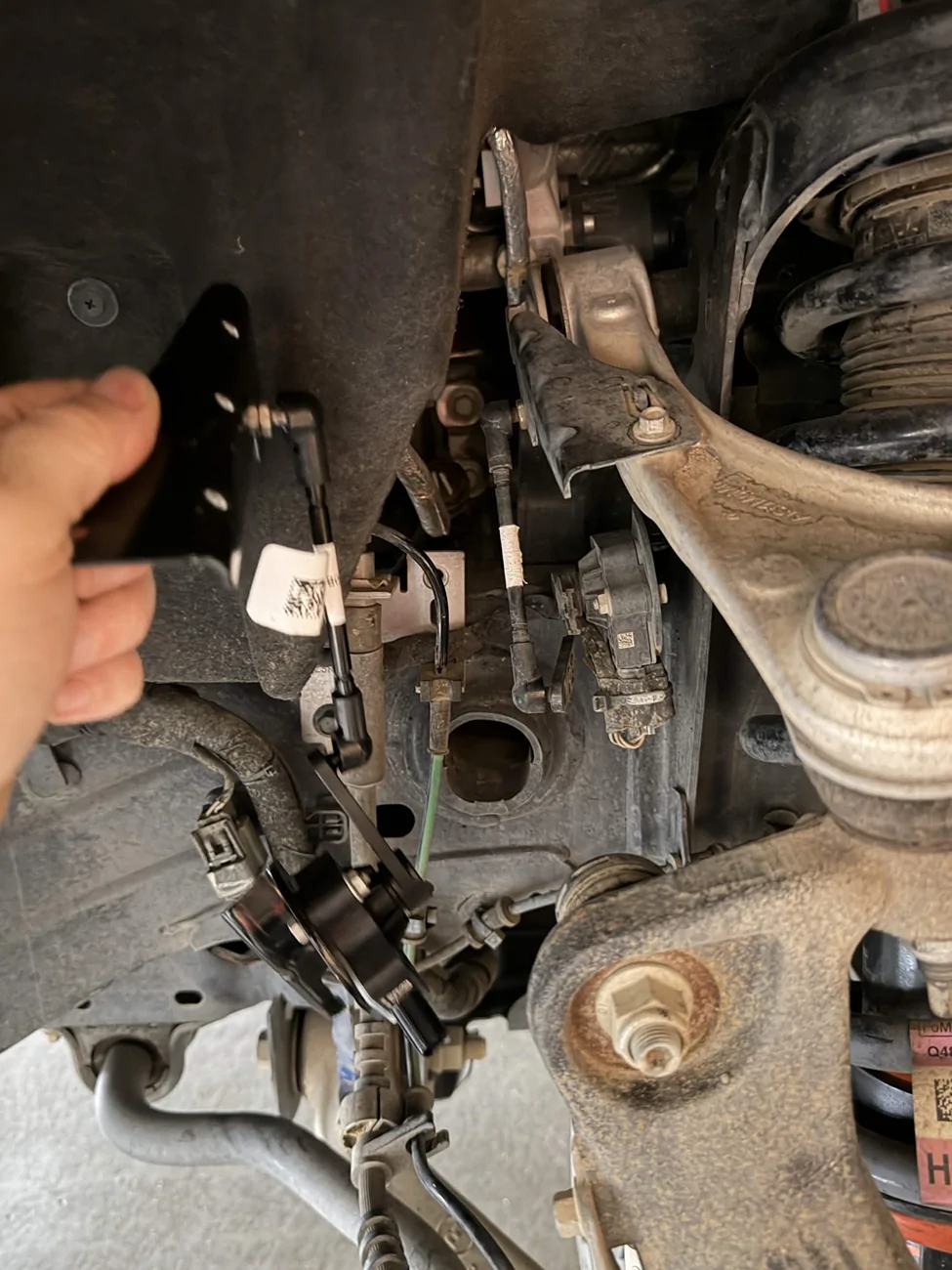

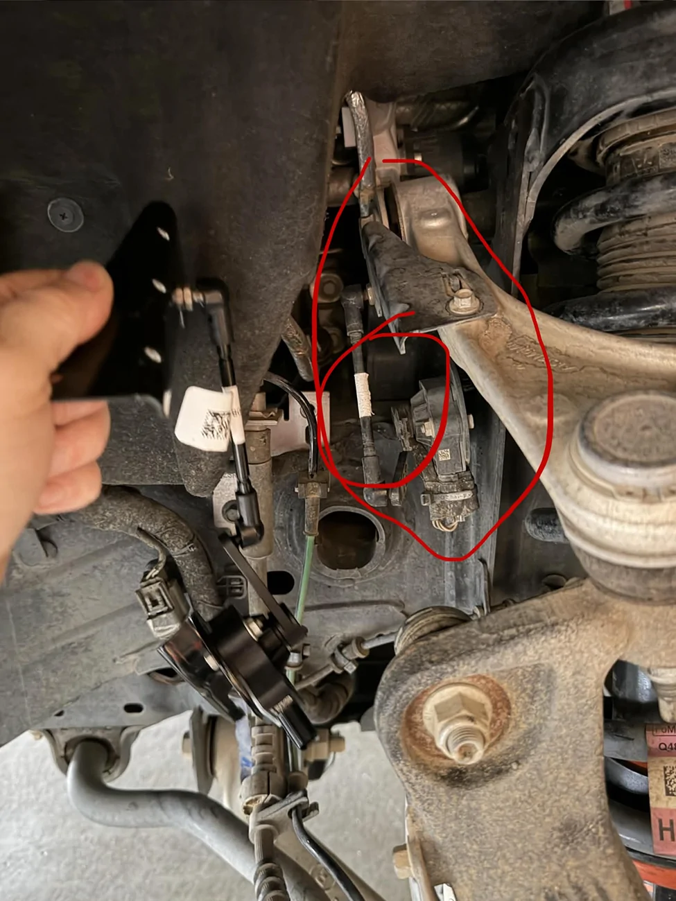

Anyone with a newish Raptor happen to be able to grab part number for me?
Looking for the part numbers listed on the white tag taped to the front right (passenger) ride height sensor?
Looking for this engineering part number highlighted below (wraps around the part) (this is from the incorrect sensor)
Levittown Ford seems to have ghosted me about figuring out the correct part or returning the incorrect part they sent me. The part number tag on my truck has disintegrated.

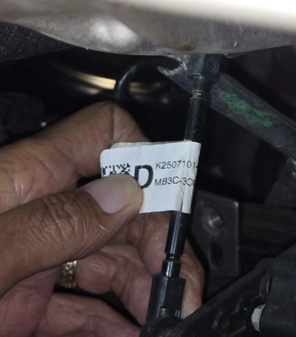

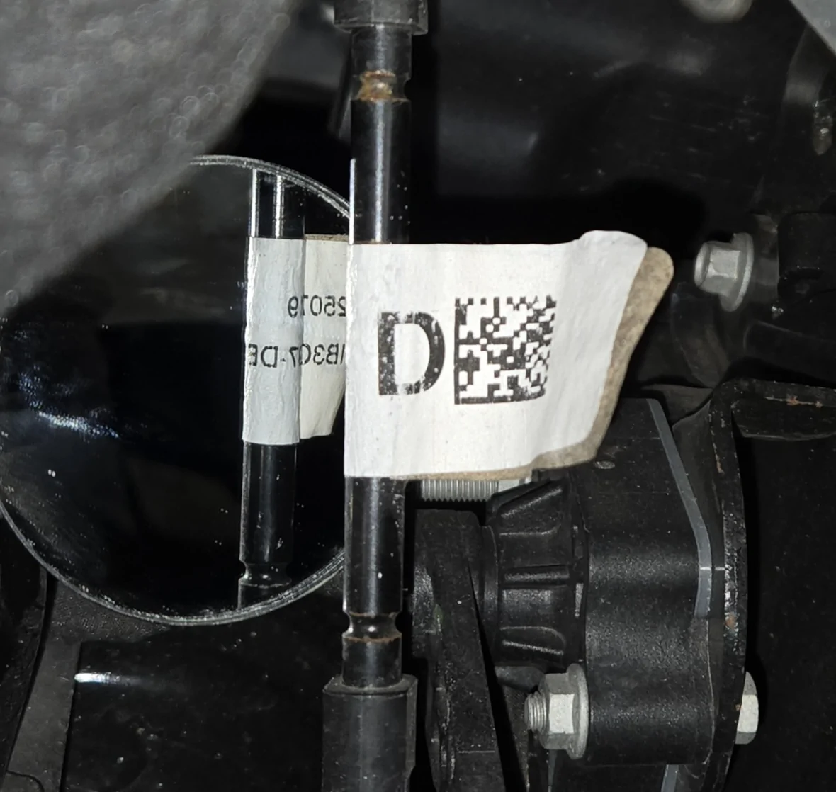

Mine's a 25.
Looks like MB3C-3C097-DB
(couldn't get a pic of the last 2, not enough hands, no one to hold my beer, but that's what it says :beer:

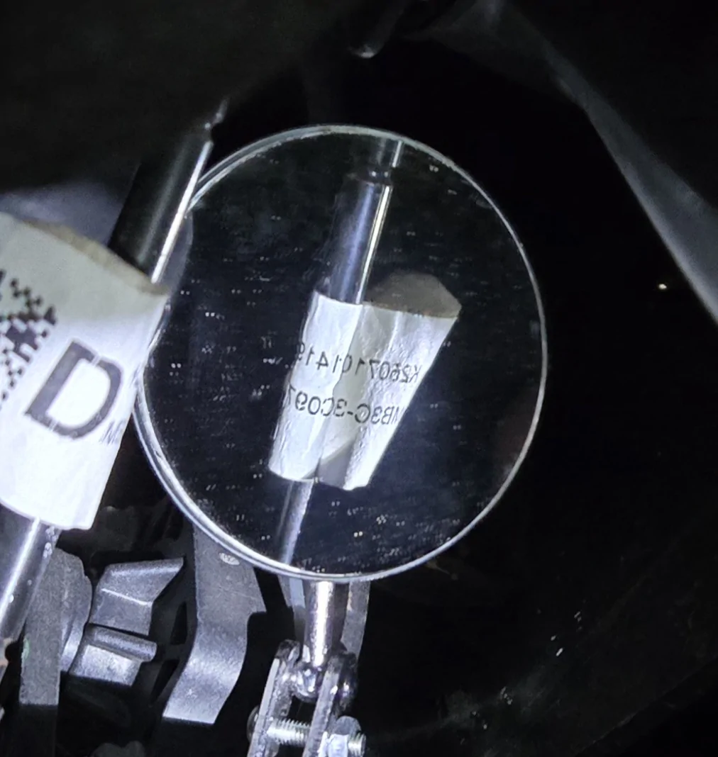

Almost...

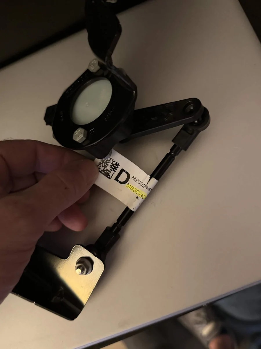

I just posted in a new/seperate thread about this same issue
https://www.ranger6g.com/forum/threads/pissed-at-ford-engineers.31722/

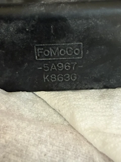

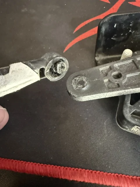

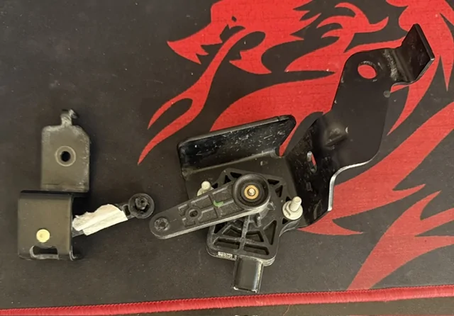

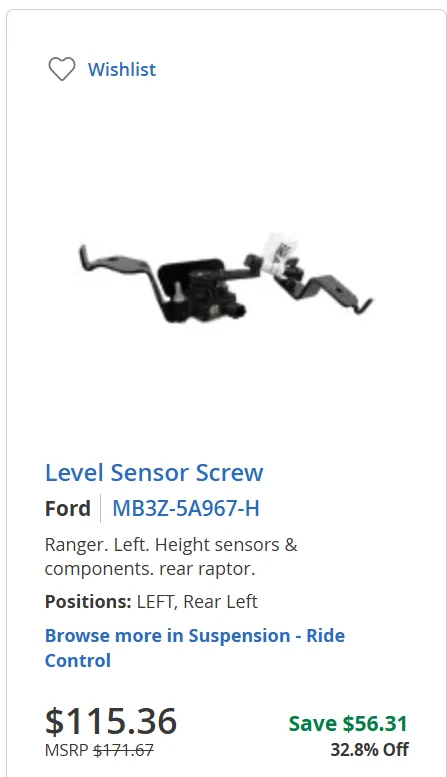

Mine was snapped somewhere between the mechanic I paid to install the rear 1" shock/strut spacer (I did the 2" front myself - no issues) and buying new 35" tires from Costco and having them mounted there. No errors and didn't even know it was broke until I hooked up ODB & FORScan to adjust my VDM ride height after the lift and bigger tires.
Right Rear part # MB3Z5A967G (its actually stamped on the metal portion of the sensor mount - see photo)$171 from dealer.
I'm waiting on the part - I also called Ford tech hotline direct to discuss the poor design and vulnerability of this part and to see if they would cover the cost.....we'll see. I spoke to a nice guy and he asked me to email him all the details.
