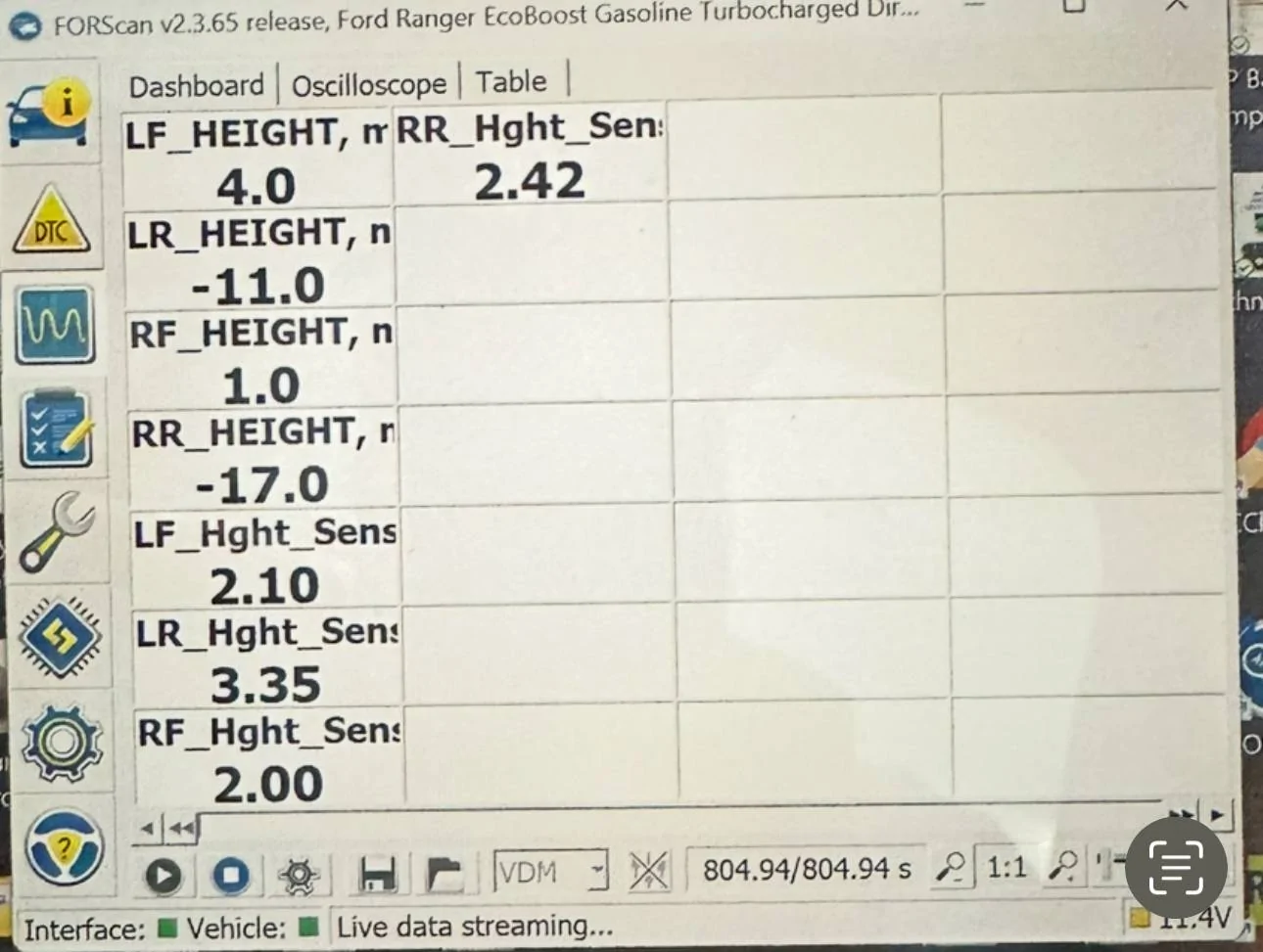

Hi all, can anyone please post there ride height calibration from forscan including sensor voltages from the VDM ?
one of my rear trailing arm sensors became loose and I need to re tighten it with factory voltage specifications as the ride has gone stiff. If anyone with a stock ranger raptor could send me some details that would be much appreciated. Thank you

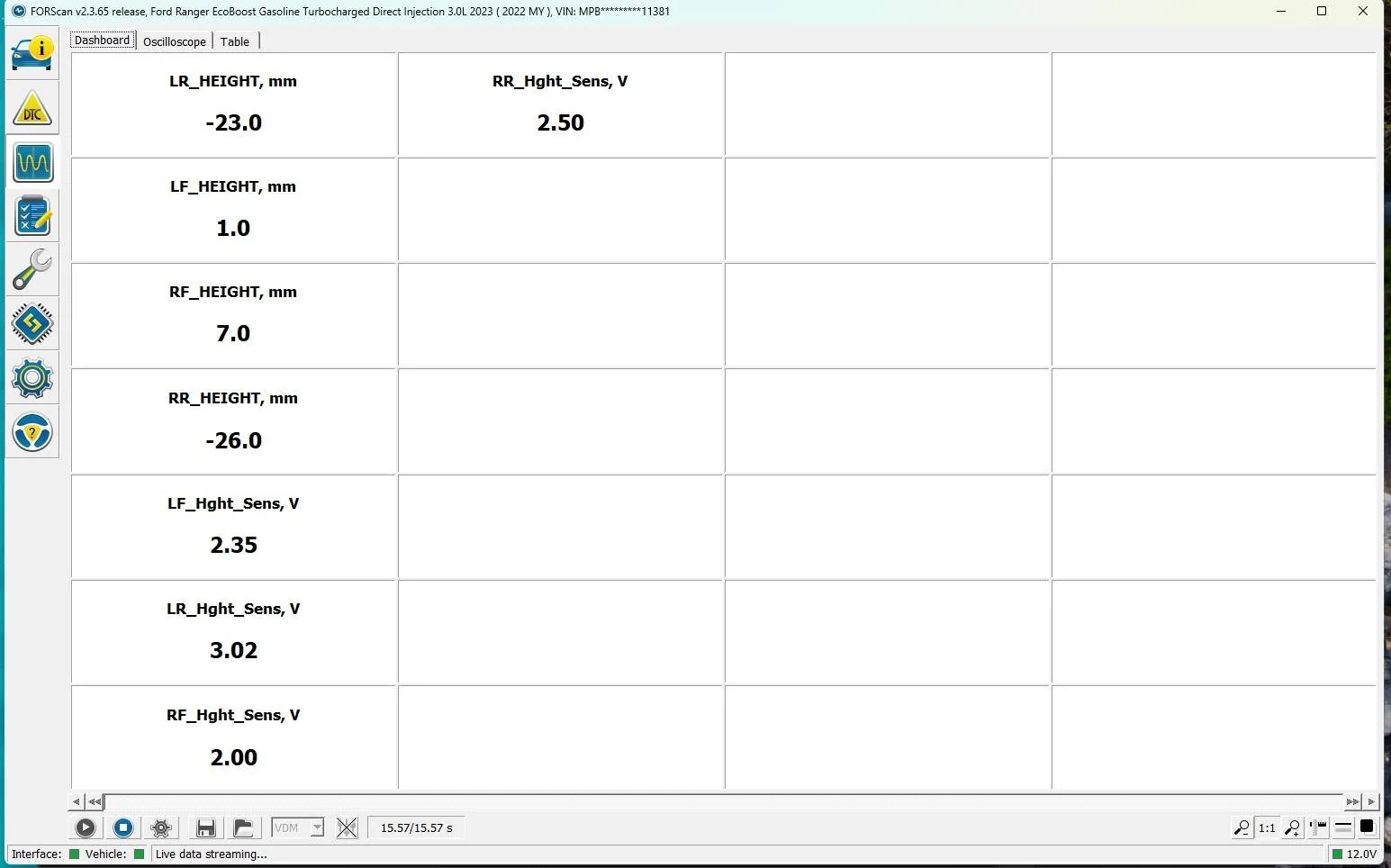

That’s great, thank you so much. Can you confirm was this on flat ground and do you have a roller shutter ? Thanks
stuartmunto
Stuart
Aug 25, 2024
258
377
Perth, Western Australia
2023 Ford Ranger Raptor
Was parked on flat ground (parked in my garage when took reading - so as flat as can be) and I do have a factory roller shutter plus about 150kg of parts and tools in the bed
I was also standing outside the drivers side door and not seated in the driver seat when taking the reading

Thanks heaps mate, really appreciate it.
