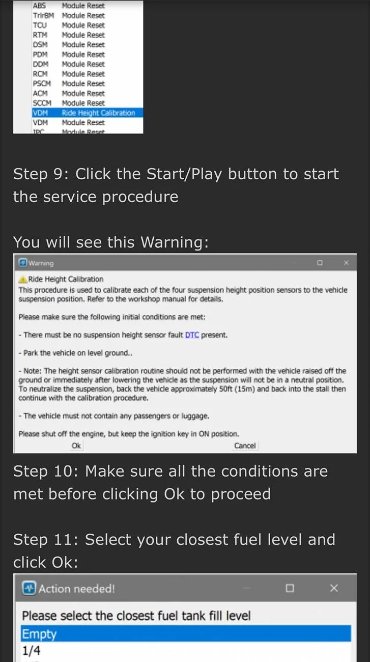

But in other hand, use a collar will change the internal piston position of the live shock and it change the position relative to all bypass technology from fox. I think that all the lift modes will change something, but the top spacer didn’t change the internal of the live valve shock technology. Any way that you use to lift the Raptor will change the height of the body relative to floor by the sensors and should need a Forscan recalibration after this…
All of this is true except for the leveling sensors.
Those sensors don’t look at ride height, they look at suspension travel speed. There is no calibration for them within the live valve components or in Forscan.

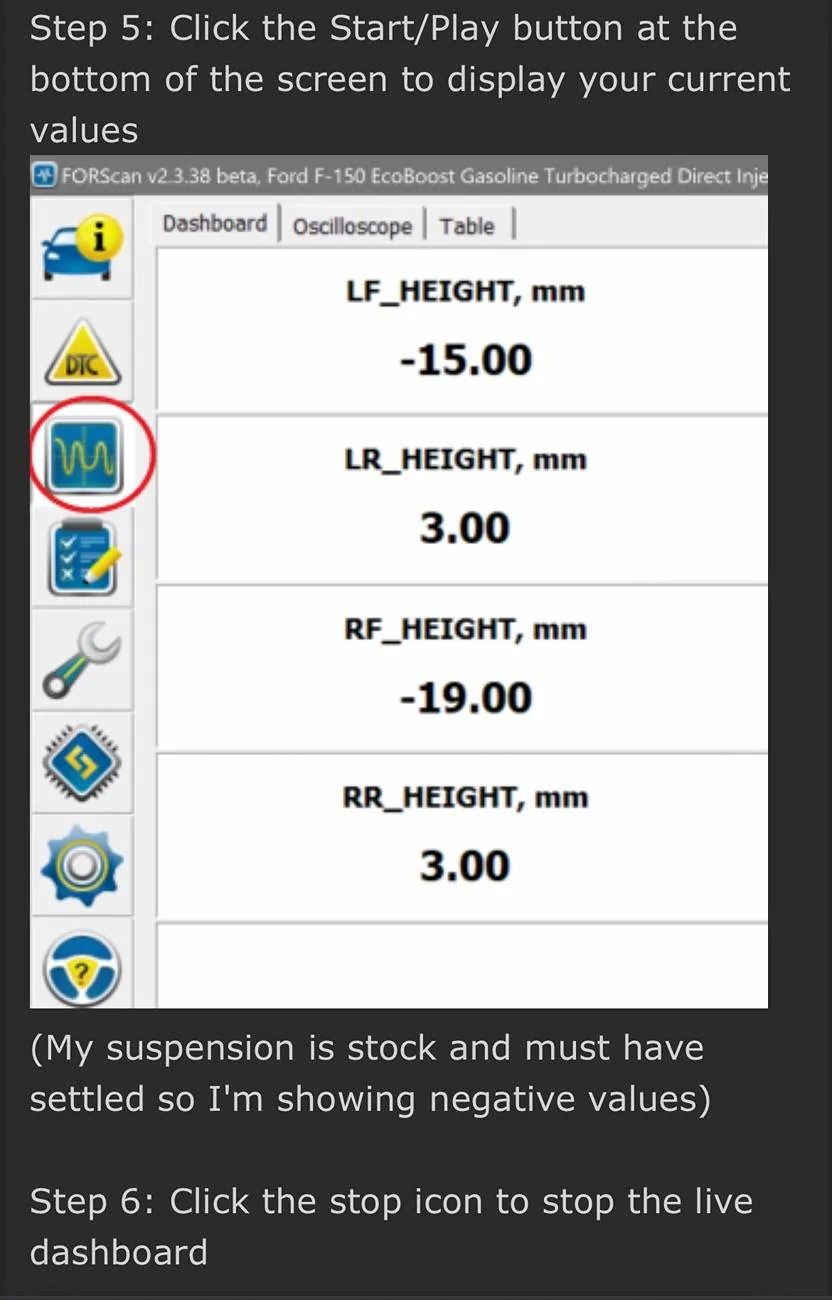

Why am I not surprised to see you posting your “authoritative” personal interpretations of second hand knowledge from a Fox tech/engineer who admitted Ford had final design and execution control of the live valve control system as implemented in this platform (and other Raptor models), that is adjustable by mode selections.
I’m going to be receiving my OBD cable so I can confirm this in FORScan with the RR, but from the F150 Raptor forum and what Aussie shops have been doing the ride height sensors, (not positioning or travel speed sensors), do measure height changes and can be calibrated:
Ford Ranger 2024 Ranger Raptor-Will it need a leveling Kit IMG_1927
Ford Ranger 2024 Ranger Raptor-Will it need a leveling Kit IMG_1926
It is entirely possible that the Live Valve dampening only collects certain data from sensors and this calibration doesn’t modify how they react; or it may, and the engineer you spoke with didn’t know how Ford uses the ride height sensor data to send control signals to the shocks.
Perhaps all this does is adjust the active LED headlight leveling and front facing camera zero points. If that were true, I wouldn’t expect sensors on all 4 corners and could easily just use a single front and rear sensor.
Once I have my FMI collars installed I will be testing this myself. Again I concede it will have a slight negative impact on the internal bypass positioning, and I am fine with that even if it means early shock replacement/servicing.
