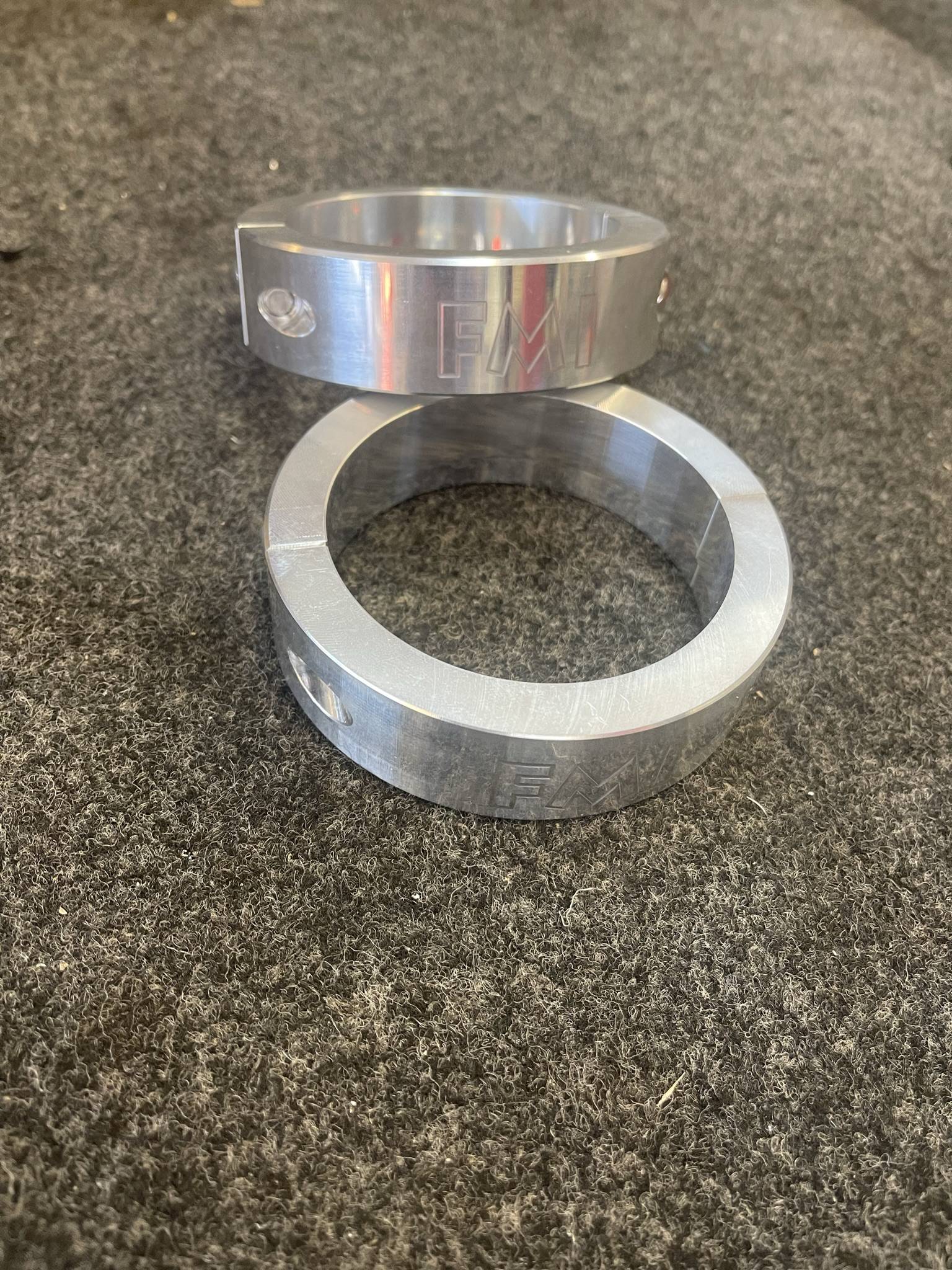

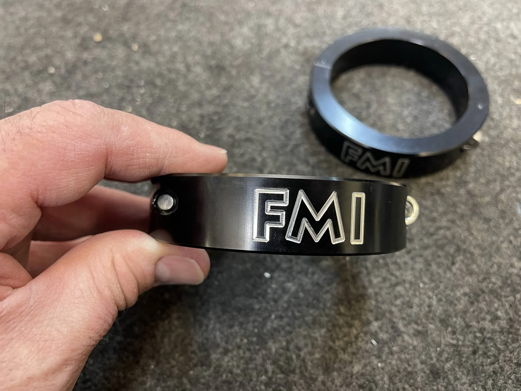

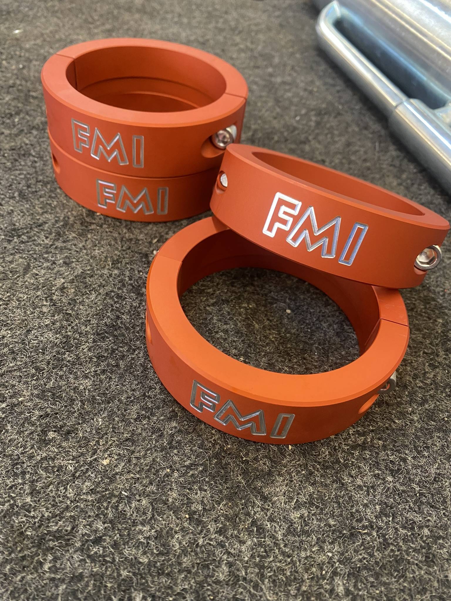

Couple guys on YouTube have. But I would not use perch collars on Live Valve unless you know for sure what you’re doing. If you moved the shock out of its ride zone you may experience a terrible ride. You also need to reprogram the ride height sensor in FORSCAN. If the ride height sensor sense the vehicle is above what it expects, it think you’re accelerating and stiffens the shocks but that will also be true of any lift. I’d go shock spacers.

Hey Greg what about the regular 2024 Ranger ?
I havent confirmed the shock package on that one yet, but we will make one as soon as I can get my hands on a truck. If anyone is in the Mesa Arizona area and getting one please let me know and we can work out a deal for some parts in exchange for letting us test fit the parts on your new Ranger

I may have missed it somewhere in this post. But if you need a regular Ranger to make these parts, how did you make the parts for the Ranger Raptor?

Lets just say I have some cool friends.
