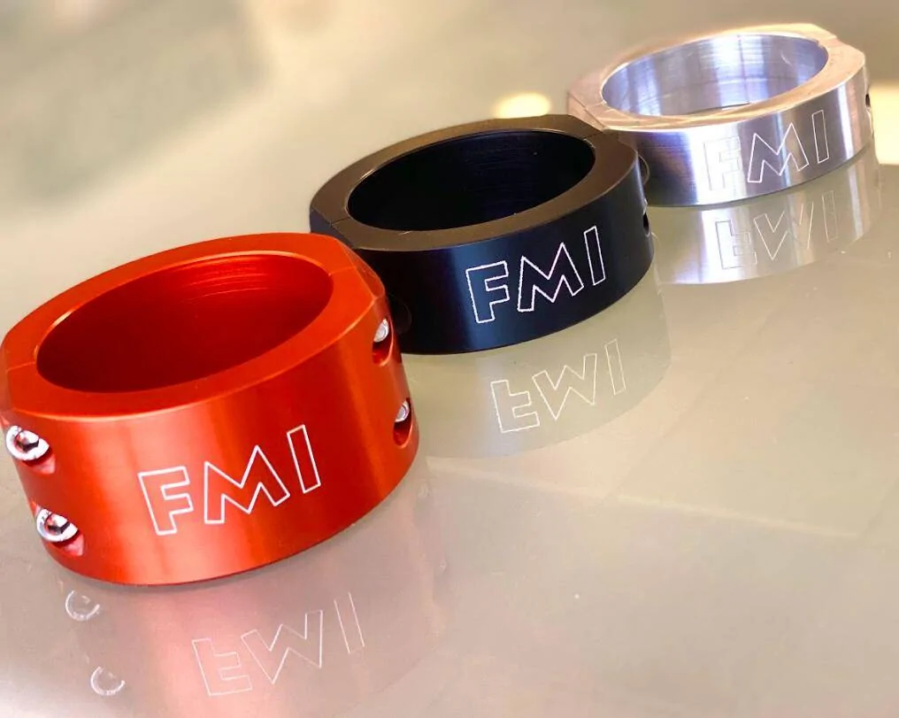

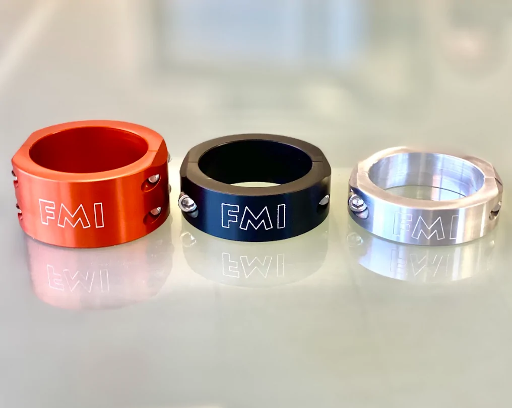

so is this like a perch collar kit? Does it install within the body of the
shock itself?
yes it fits below the stock spring retainer on the body of the shock to add some pre-load to the spring.

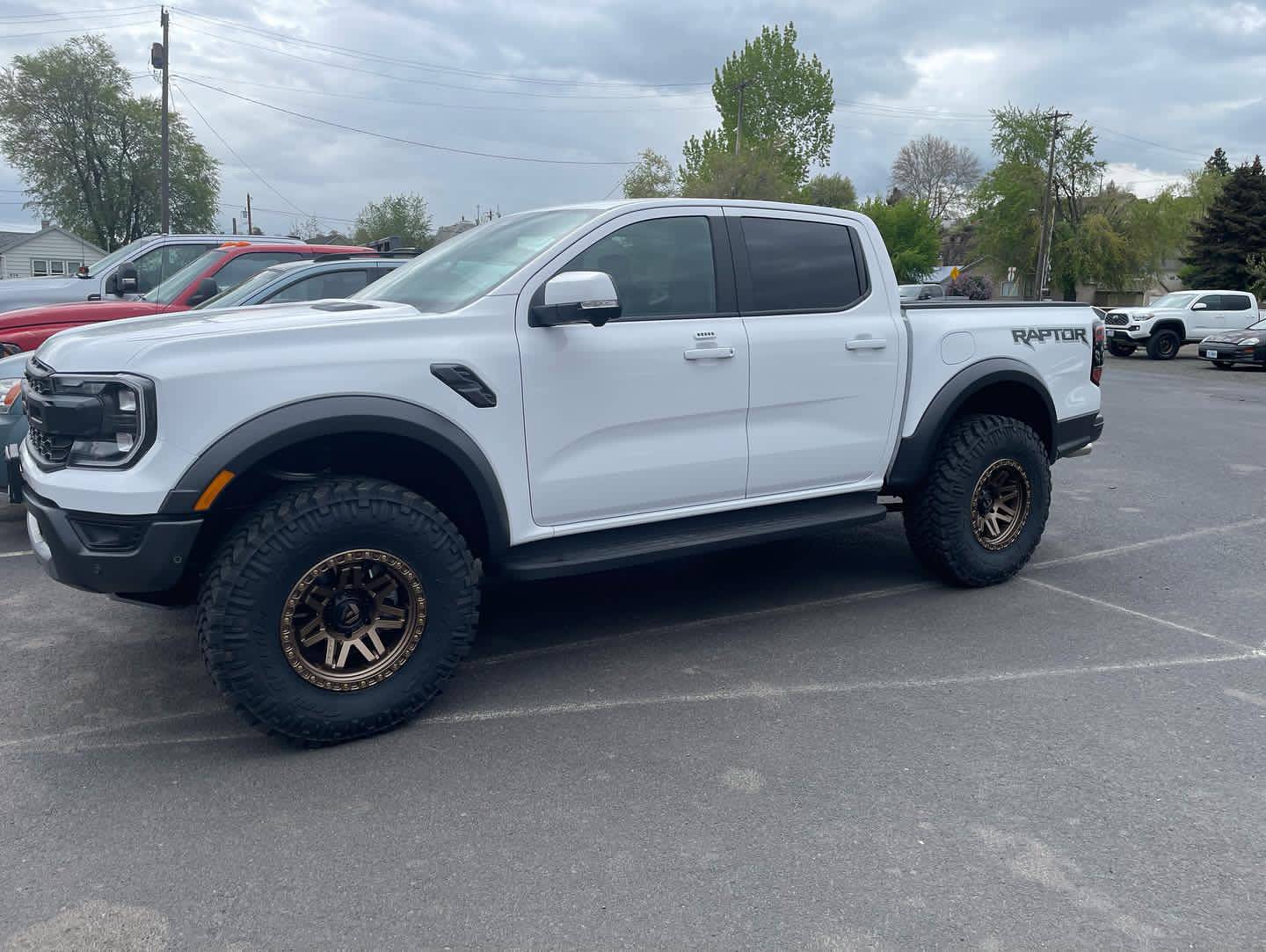

So my 2019 Ranger really benefited by a leveling kit (dealer installed). Besides looking better, the ride was noticeably improved. Curious if the Raptor will also have the same nose heavy stance....requiring at minimum a 2" front lift? Looks pretty level in most of the U.S. posts and videos....but hard to tell.
My 2024 Ranger Raptor looked fairly level at delivery, with only a slight front rake. After 6000km on-road, the front suspension settled 3/4" and appeared a bit too low in my opinion. I installed a set of 15mm spacers and it regained 1". It drives exactly the same as stock.

Any photos of trucks with these collars installed?
We have one getting installed this week and I will get you some pics of that one. I didnt get any when we were doing the initial test fitting. Forgot due to time crunch to get it done.
Awesome, thanks!
