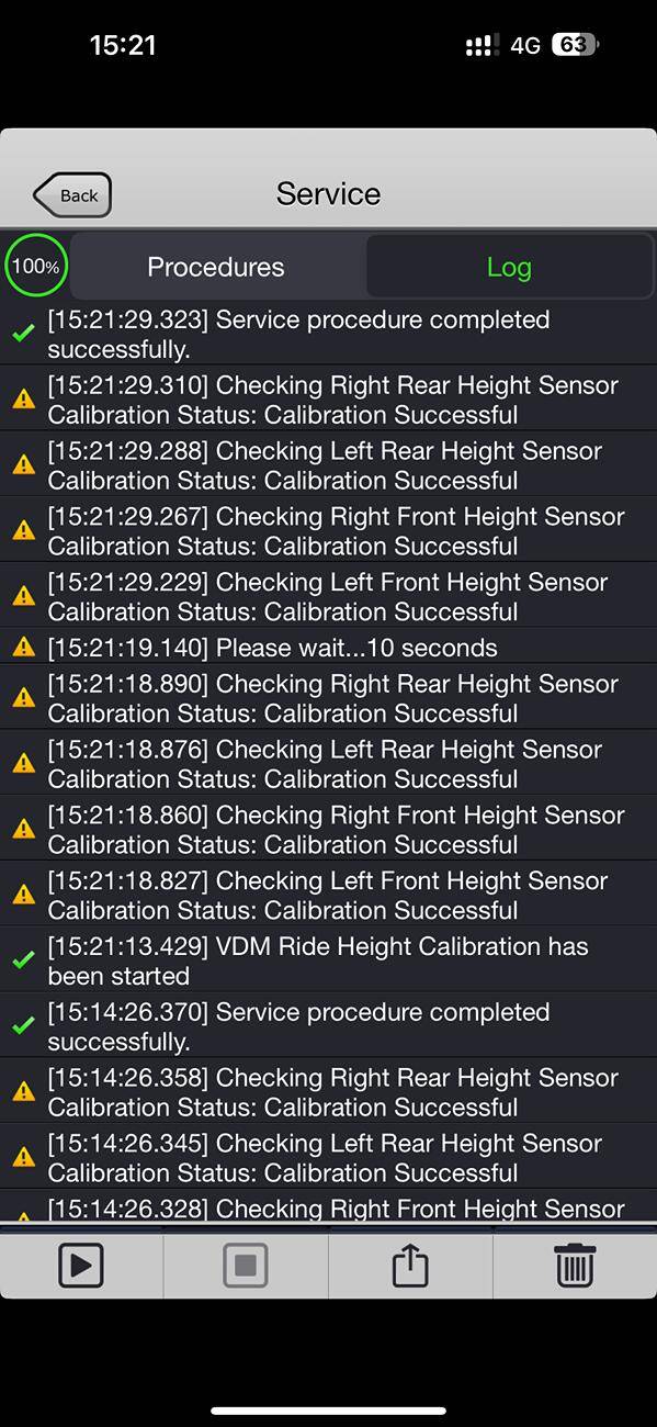

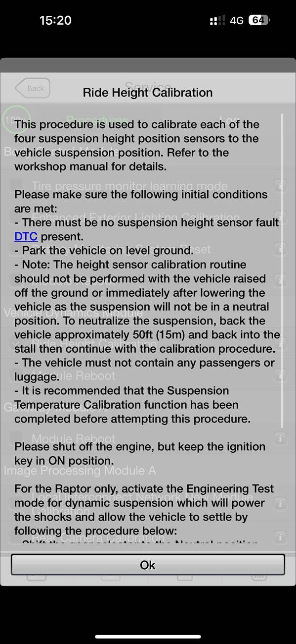

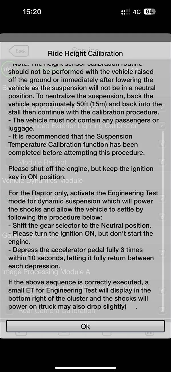

All of this is true except for the leveling sensors.
Those sensors don’t look at ride height, they look at suspension travel speed. There is no calibration for them within the live valve components or in Forscan.
I clearly found a height sensor calibration on Foscan Lite and more than this, found a Ford Technical manual showing how to proceed the calibration.
Interesting!
My guess is that has to do with the Ford size of the electronics then and not the Fox side of things.
Fox does not utilize ride height sensors in their other Live Valve applications..

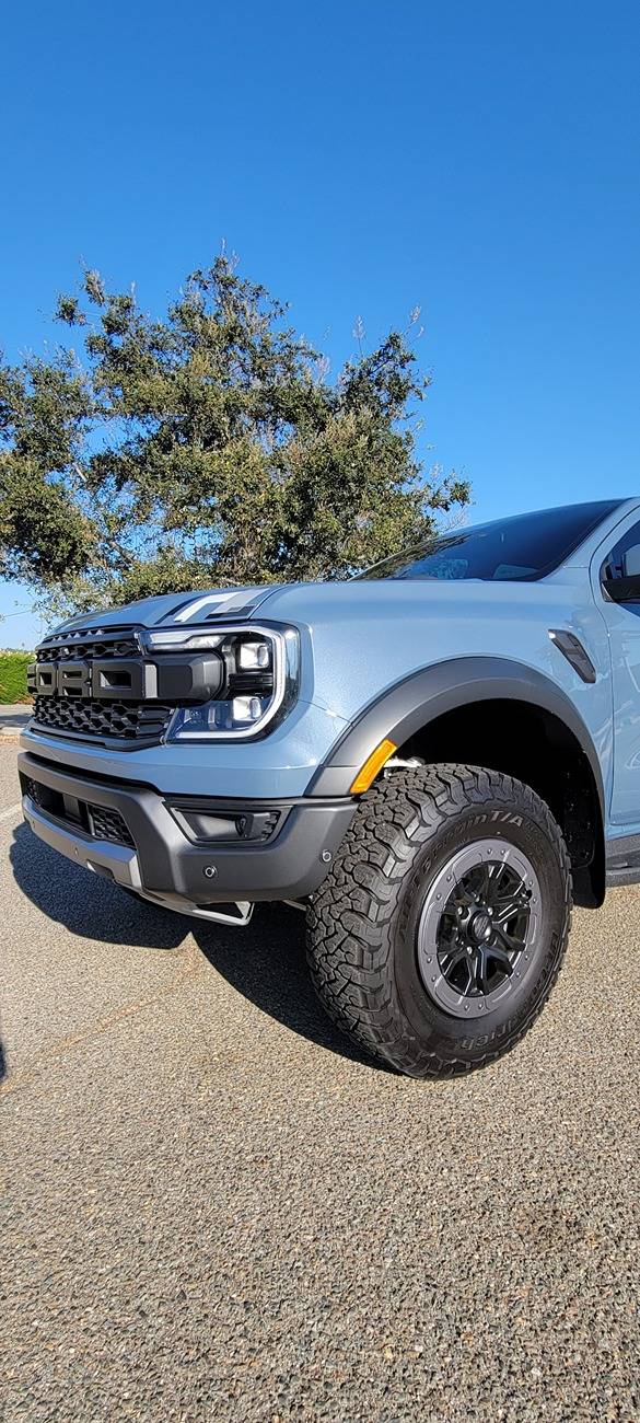

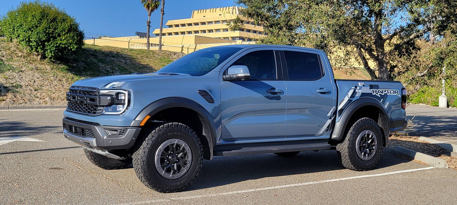

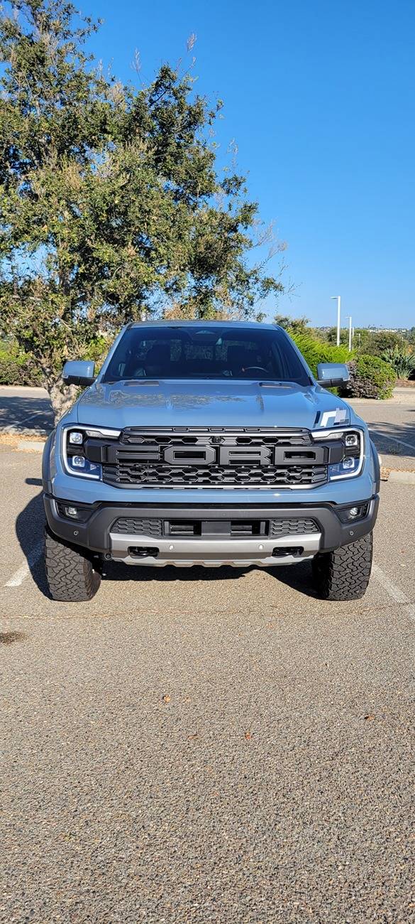

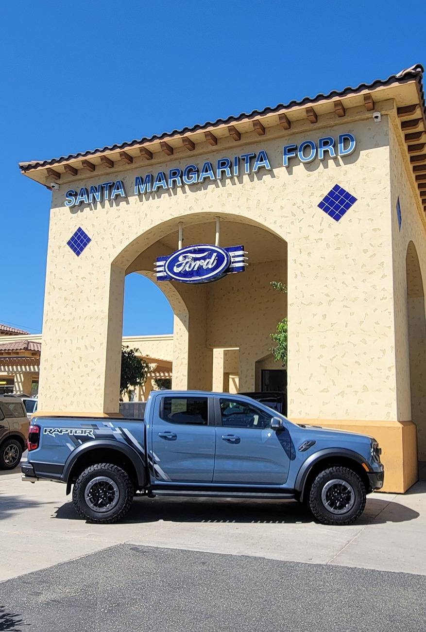

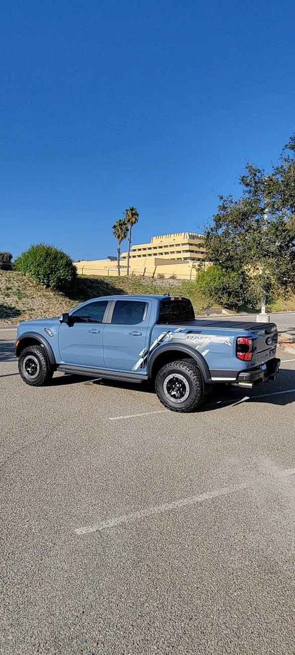

finally got the 2" front level lift installed...looks great and drives/rides just like stock.....but I'm not into "heavy" off roading so I can just judge based on street driving......still has a slight rake which is exactly what I wanted!
here's what I bought and had installed.. https://fordrangerlifts.com/shop/ols/products/xn-2024-ranger-raptor-2-level-lift-eb2t-5348cc
my mechanic charged me $500 to install and that included a front end alignment.....seemed fair to me but what do I know?!
The pic under the "Santa Margarita Ford" sign is stock before the 2" level lift (It was the day I bought it)....the rest of the pics are from today (After the 2" level lift)

sorry, but I didn't.....just texted Robbie at www.FordRangerLifts.com before I had it installed and he assured me it would leave a little bit of rake.....I used his front level/lift before for my previous 2021 Ranger Lariat Tremor so I knew what to expect.....my mechanic said the rears from the top of the tire to bottom of the fender wall measured 9 1/2" inches before he started.....that same measurement in the front is about 1/2-3/4" less

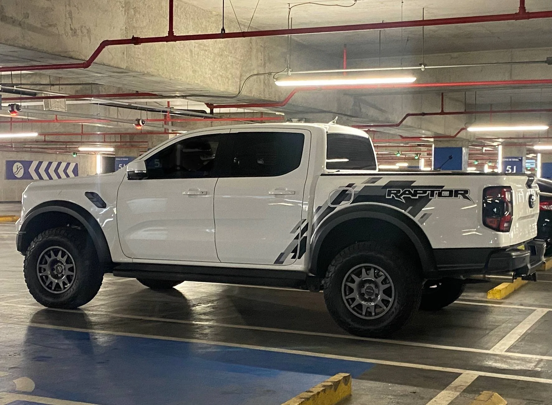

galion
Eddy
Jun 2, 2023
120
162
Charlotte NC - Lima PE
It’s not my intention to spark a debate, but the engineering seems quite simple: to maintain the performance of Internal Bypass shocks, the piston must remain in the same position as stock, which doesn’t happen with a perch lift or springs, as they lower the travel by the same amount as the lift. This affects performance due to the loss of down travel and also impacts ride comfort because of spring compression. In my case, I opted for a 1” lift using a 15mm front strut spacer. While the suspension geometry is slightly altered, which isn’t ideal, the impact is negligible due to the spacer’s thickness. My truck looks almost leveled, and the ride feels exactly the same as before.
