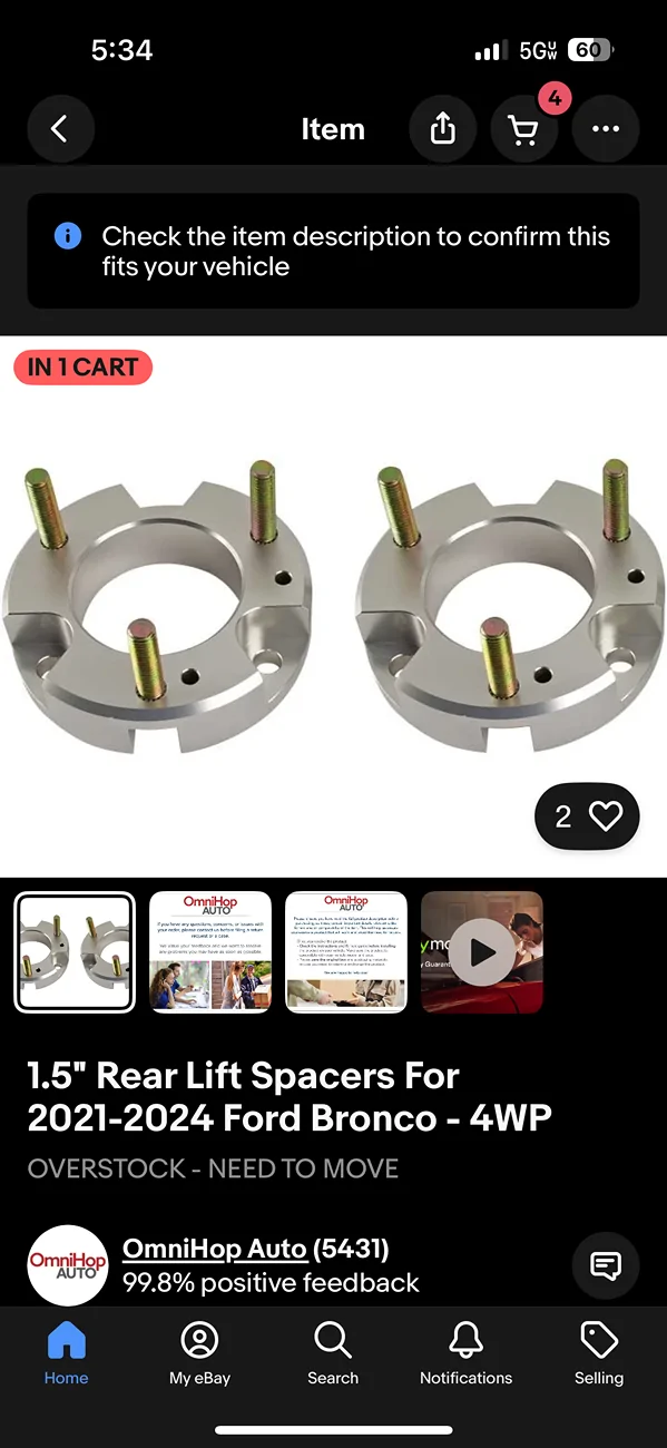

I’ve read a few threads on here about people using a bronco level kit on a ranger raptor. I was wondering if anyone had any further insight on this. Looking to get this spacer. Thanks

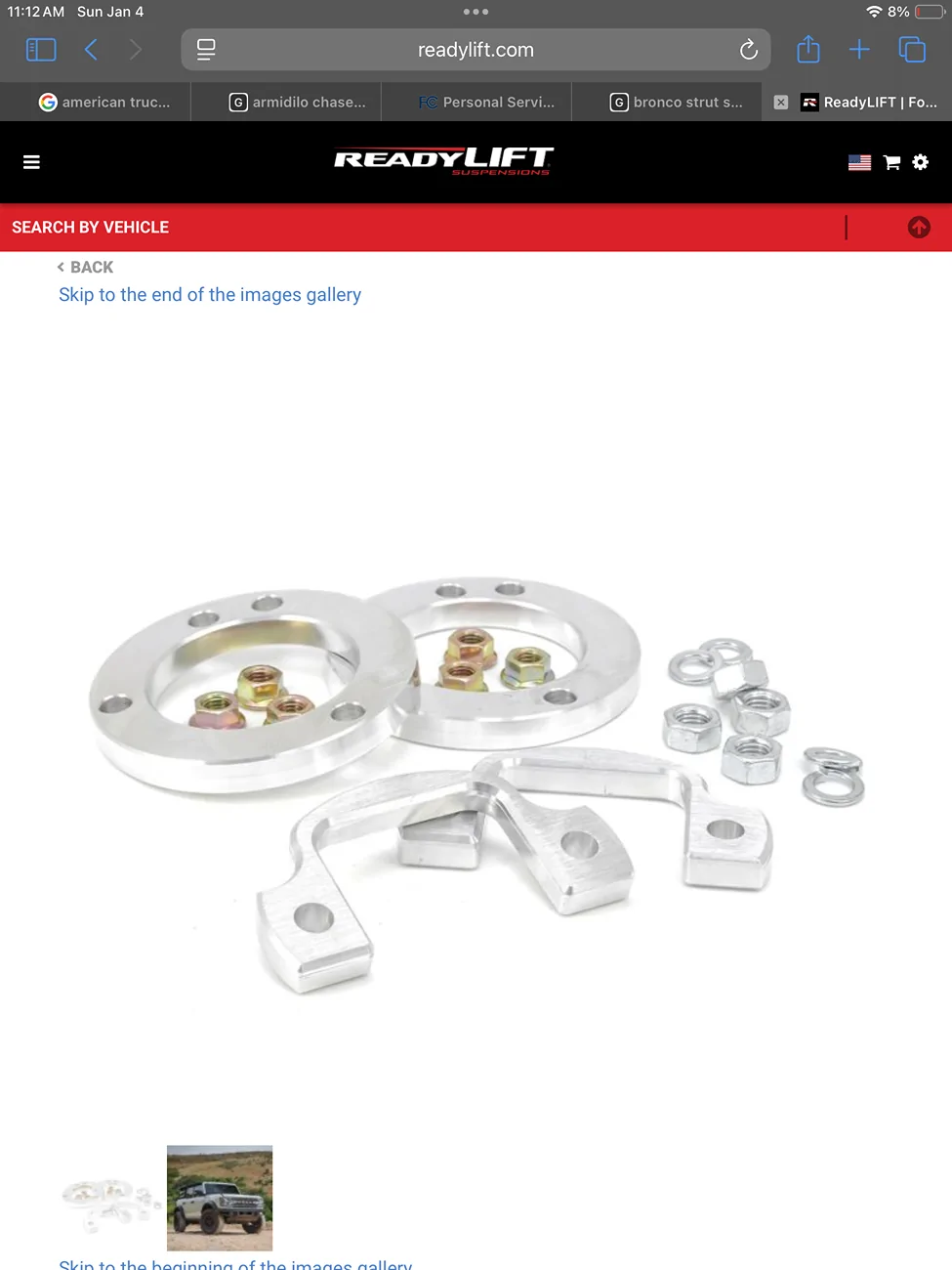

I’m running the 1/2” bronco plate on top, nets almost 1” of lift. Same tower top configuration.

What spacer are you running? Im looking for about 2in of ride height increase

I don’t remember the brand. It was the type with an upper ring and piece for the lower. Badlands kit not a Raptor kit. I didn’t want to have to compress the spring and rotate the strut. Completed this statement and remembered I had a pic of it.

I'm running the Fabtech 1.5" Bronco front spacers. Got about 1" of lift.
98hd
Oct 1, 2024
US
24 RR
FTL5212. Everything seems fine with the angles but I wasn't really concerned about them either, as there are several similar spacers on the market with the same lift height. Alignment was within specs as well.

Thanks! Appreciate it! I knew there had to be a way to get a billet spacer for an affordable price
