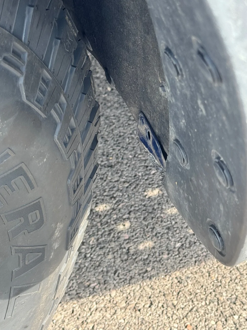

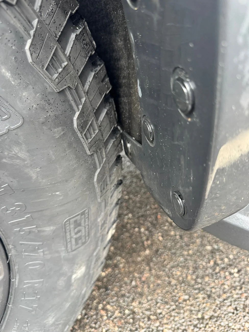

Yeah no rubbing. They did with the spacers so I removed them. Also Grabbers don't seem to like wheel spacers and it rides alot smoother without. I do have my front mud flaps removed and did trim a little bit inside which I am annoyed with myself about as I didn't have to do that.
In that thread where they are mud tyres it could be they have more sidewall. I'll have to dig out some pictures
dsmclark
Sam
May 16, 2024
Dorset
Ford Ranger Raptor
Here you go. As you can see the spacer makes it so close that it would touch on an uneven surface. Then I removed the spacers (after trimming 🥲) and it has loads of room
