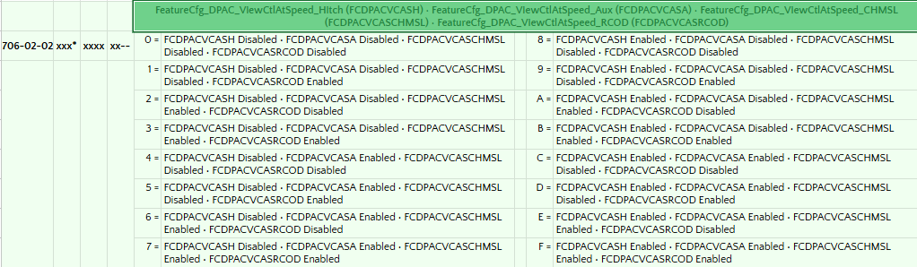

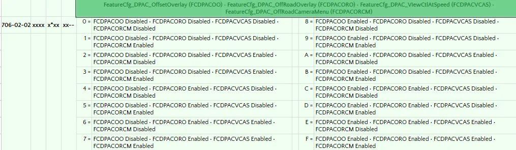

following this thread. hate the camera interface and modes that ford put in. wondering if we could play with Forscan or add modifications to make it better.
The options to enable cameras at speed in the IPMA are there in the 2024 Ranger spreadsheet.

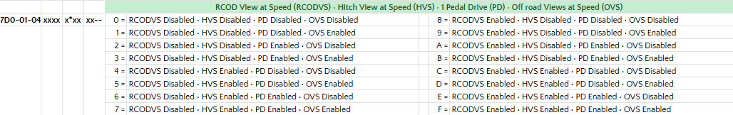

You'd also have to enable the specific views you want to see in the APIM. Example, RCOD (rear camera on demand) and hitch view (if hittch view is enabled) at speed are enabled here.
Ford Ranger Camera ON/OFF 1781204228061-q1
Edit: This will not work on Rangers that use the IPMA/IPMB combo. I believe it's the 2024 and up Ranger that have the newer IPMA only architecture, but not 100% sure.

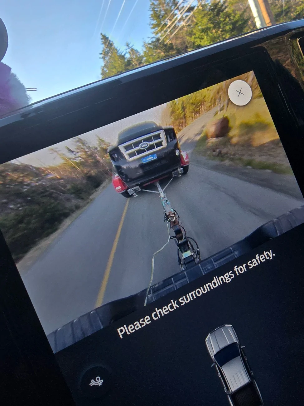

Absolutely right. I never was that much of a camera guy—but not anymore. I find that when I am parking or maneuvering in tight areas, especially towards the front, I turn on the front camera to see how close I am. Far better than having the wife get out there and say “keep coming”, “keep coming”, “you got a long ways-keep coming” !!(CRASH)!!! “Ok, You Can Stop Now”!
One thing that wasn’t mentioned above is that stupid warning label that turns on in the backup camera screen. The warning bar goes from side to side blocking the view of vehicles farther than 30-50 feet or so. I tried to use it once on the highway when I had cargo that blocked my entire rear window view. With that warning label blocking the camera view, I couldn’t see far enough back to determine if cars were there or not to make a safe lane change. Get rid of the warning bar.
I did activate both hitch and rear camera at speed with this
