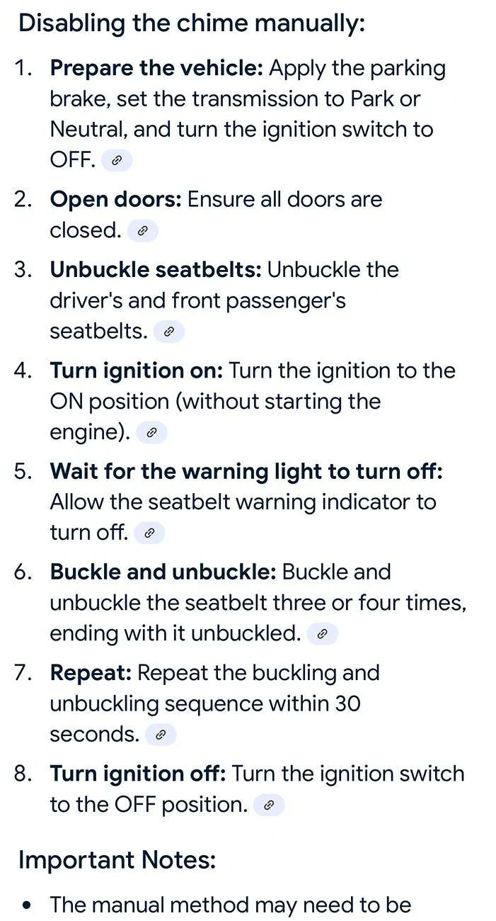

Thatch11b
Nov 23, 2024
Limerick PA
that speaks only of the chime. forscan lets you turn off the junk on the screen that you have to hit ok for each time you start the truck
My bad I thought that’s what he was talking about
904
615
Aircraft examiner
its ok. you posted something useful, i didn't know about that way you posted to get rid of the chime
