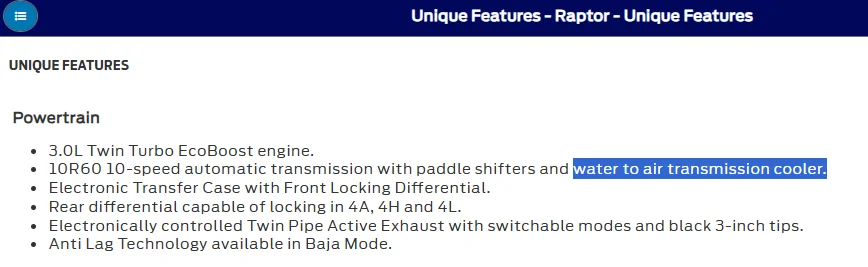

Unless your RR's are different than the US, it already has a Water to Air transmission oil cooler. There are two cooling blocks on my RR.
The bottom on down by the skid plate is for the tranmission, the top one mounted to the engine is for the engine oil. They both use the radiator coolant to pull heat from the engine and transmission, but since the radiator is air cooled, ultimately both coolers are considered liquid to air cooling even though they use the coolant as transfer medium.
I believe both are also independently thermostat controlled, so the PCM can adjust flow rates to either or as needed independently.
