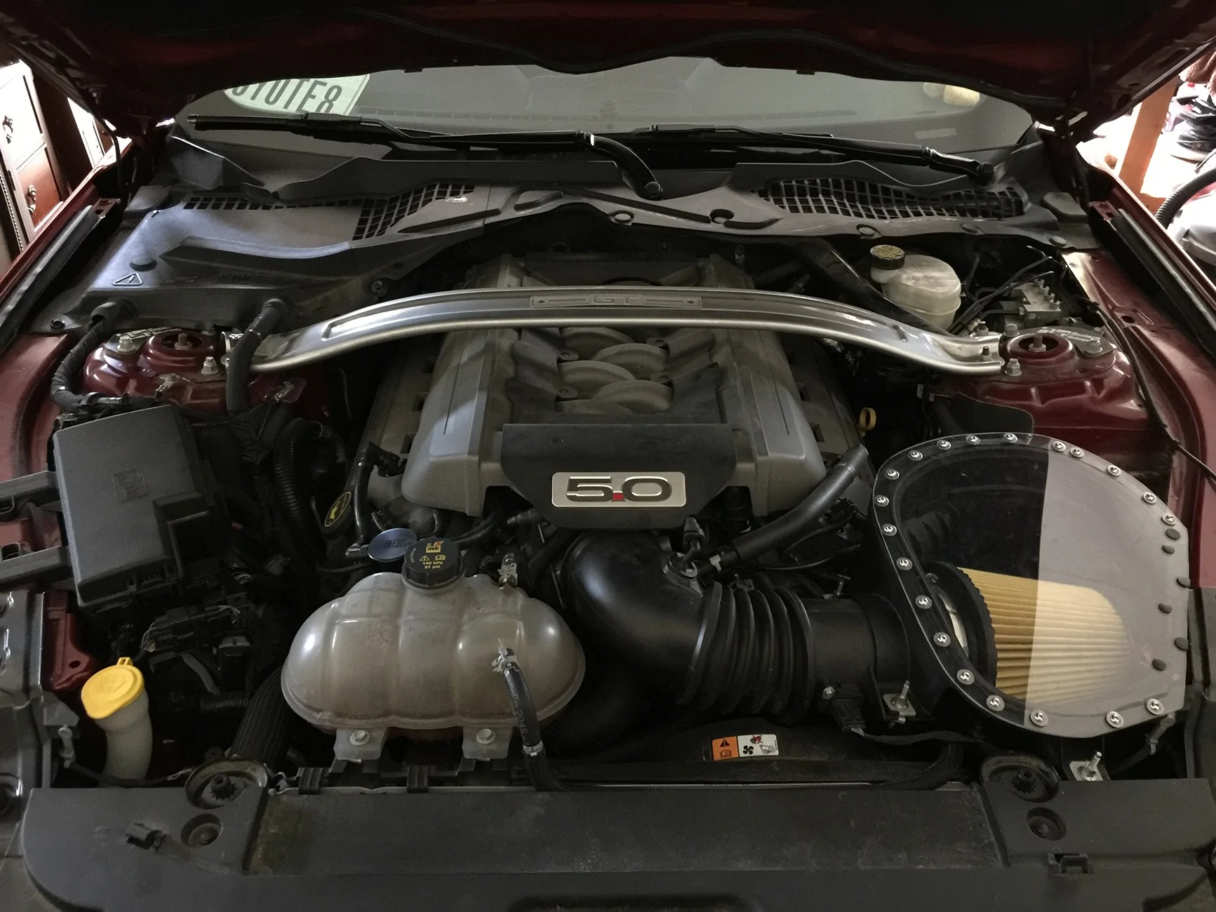

That was one issue I had back in my Mustang GT days, I had a 2016 GT PP with a FP Stage 2 Power Pack. But that was a semi-permanent mod. You could flash back to stock....but the car wouldn't run right as it had the GT350 throttle body and intake, unlike the Raptor, it was more than just a simple ECU flash.
Ford Ranger Which Fuel Grade do you use in your Ranger Raptor? IMG_0074
That's one thing I really like about the FP Pro Cal on the RR, it's ONLY software and fuel grade. So it leaves that option open to flash back to stock for an unexpected emergency where with the Mustang, FP told me that you could run a lower fuel grade in an emergency IF you only use light throttle just to limp to a station with higher octane, but they wouldn't have covered damage to the engine if it occurred (granted, the 5.0 was NA, so I think it was less likely to be damaged from doing that under light load as turbo engines are more knock sensitive and the RR is a lot heavier, so it's going to load the engine more even during normal driving).

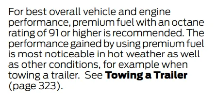

Curious, for those that are not tuned, why are you running a higher octane than what the OEM lists out (87)? Better gas mileage (despite higher overall cost)? Engine longevity/reliability concerns? More pep? Because it feels right?
I know others have their reasons but my reason for running 91 on my stock/non-tuned RR is because the folks at Ford recommend it (See Pg. 174 of the '25 RR owner's manual)
