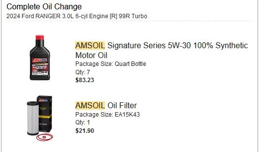

Can't go wrong with Amsoil, use this in my RRaptor and getting ready to swap the GT500 over to it on it's first change in my ownership.
I'm also at 551 ft above sea level and it barley gets below 0F. If it ever got 20 below 0 (Freedom Units) people here would lose their mind.
