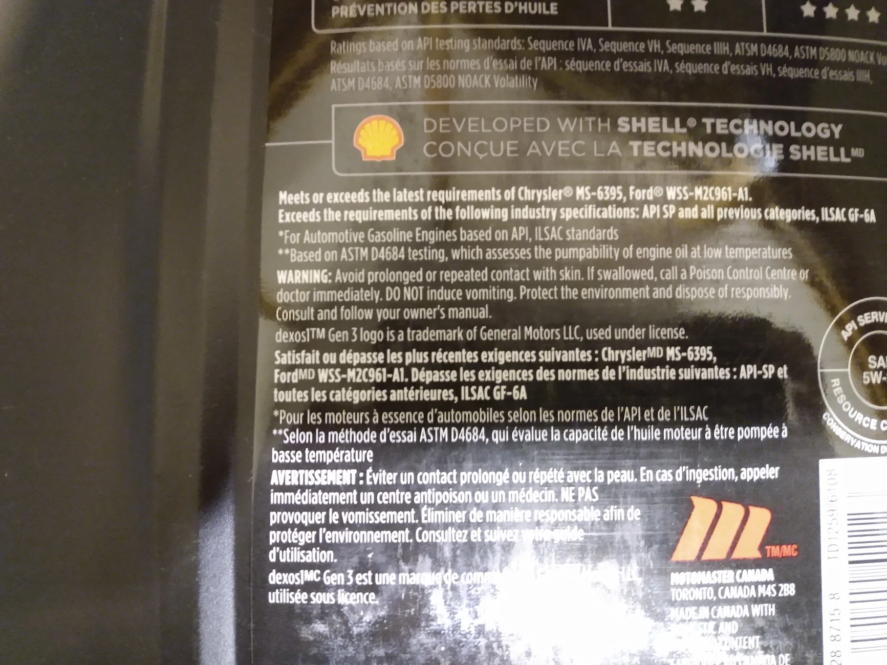

Can you share a photo? I'm really intrigued by an oil meeting WSS-M2C961-A1 that isn't of Ford's approved/recommended viscosity. Every page I see for that oil shows that it meets WSS-M2C945-B and WSS-M2C945-B1.

Here it is not the best pic but best I can do.

I see what you did there, cutting off the image at 5W- 😉
Didn't notice I did will take another one when I get back from work if I remember.

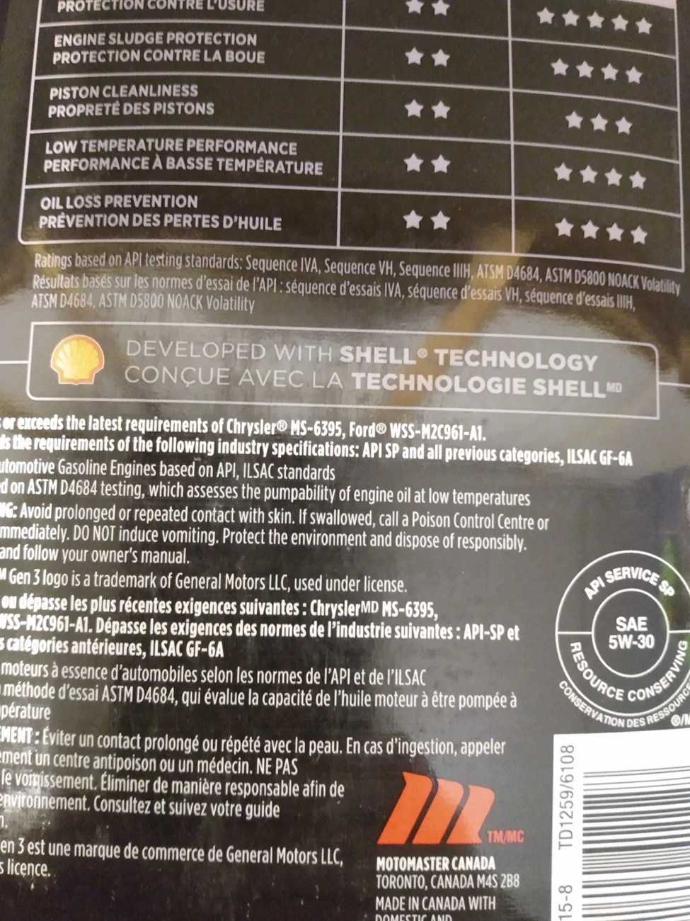

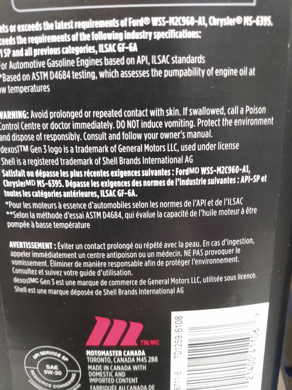

OK so the 1L container says something different than the 5L container. The 5W20 meets 960 and the 5W30 meets the 961. They can't make up their mind :clap:

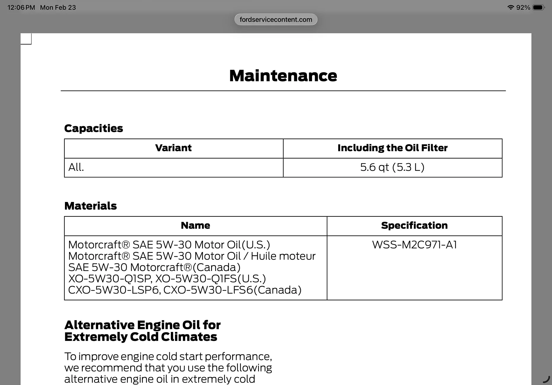

I notice in the new 2026 ford ranger manual.
WSS-M2C971-A1 is now listed as the oil spec
i do not think motorcraft Synthetic blend meets WSS-M2C971-A1 or the 961 specs?
even though it is listed as a suitable oil
If Motorcraft SB wouldn't meet the new 971 spec, why would they fill the oil pan with it at the factory?
