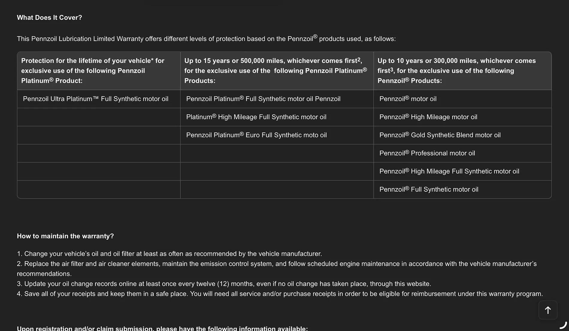

I wonder if anyone has successfully made a claim on the Pennzoil lifetime warranty….
