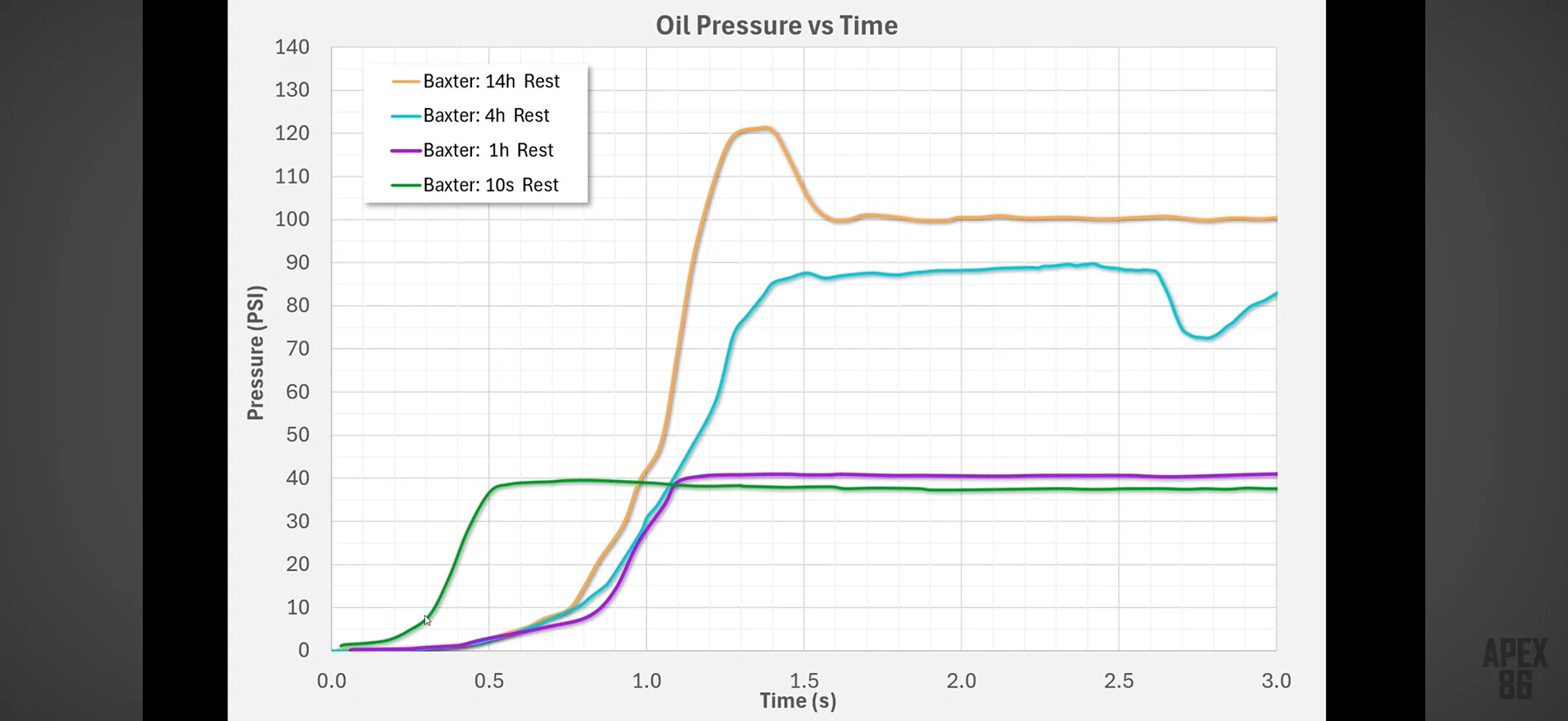

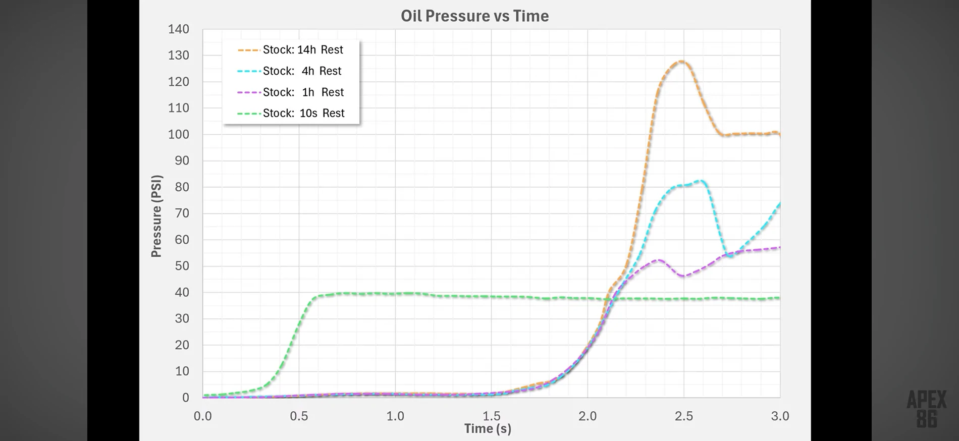

I am curious where the Oil Pressure Sending Unit is, does anyone know? There is a guy on here that pulled some Oil Pressure Data after installing the Baxter Filter Relocation Adapter.
Ford Ranger Engine oil pressure? IMG_2663
Ford Ranger Engine oil pressure? IMG_2665

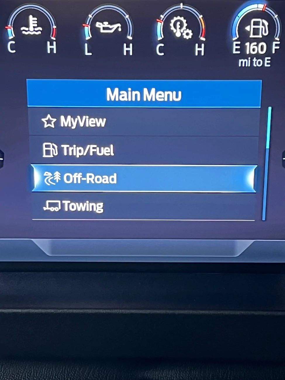

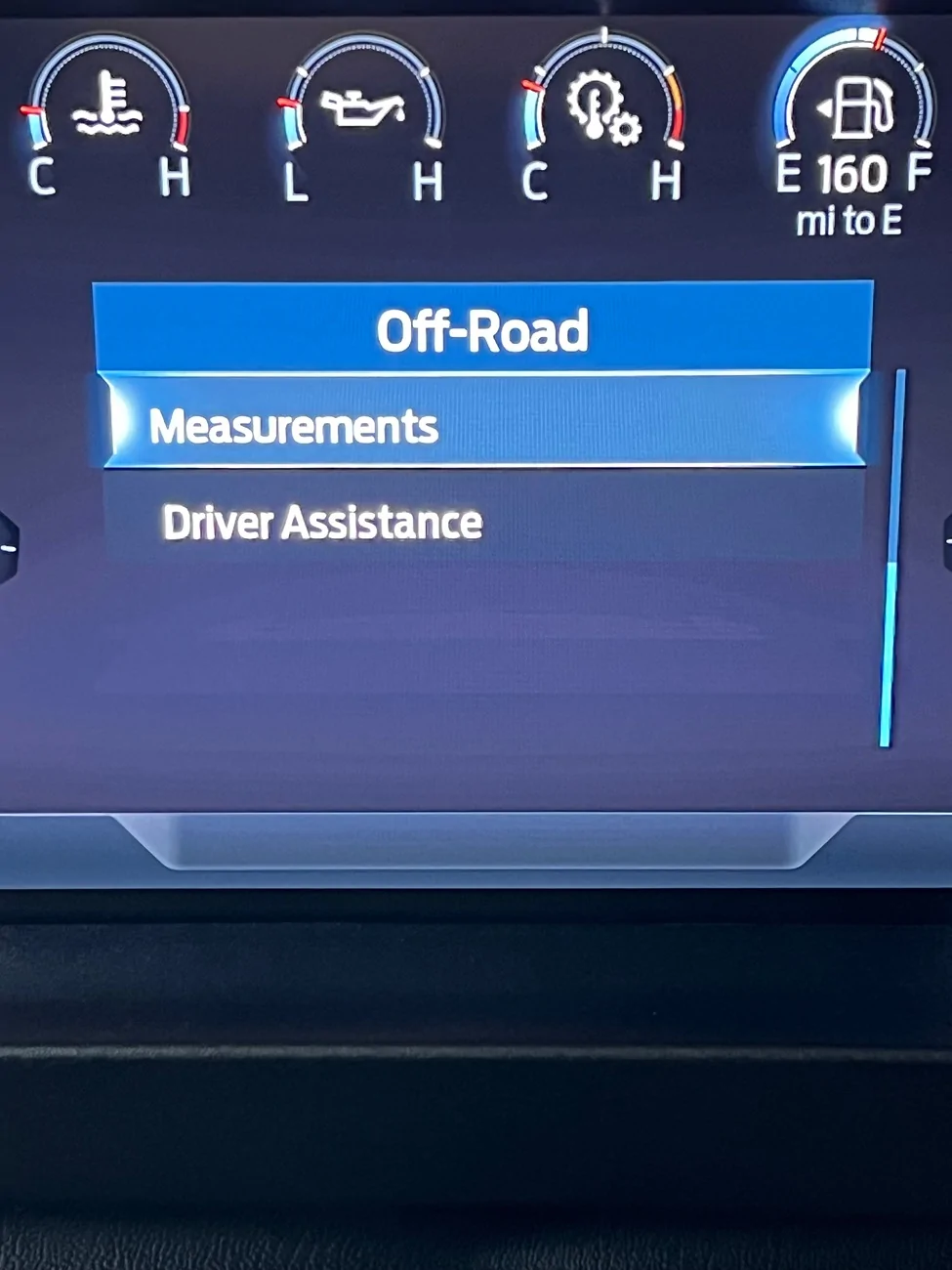

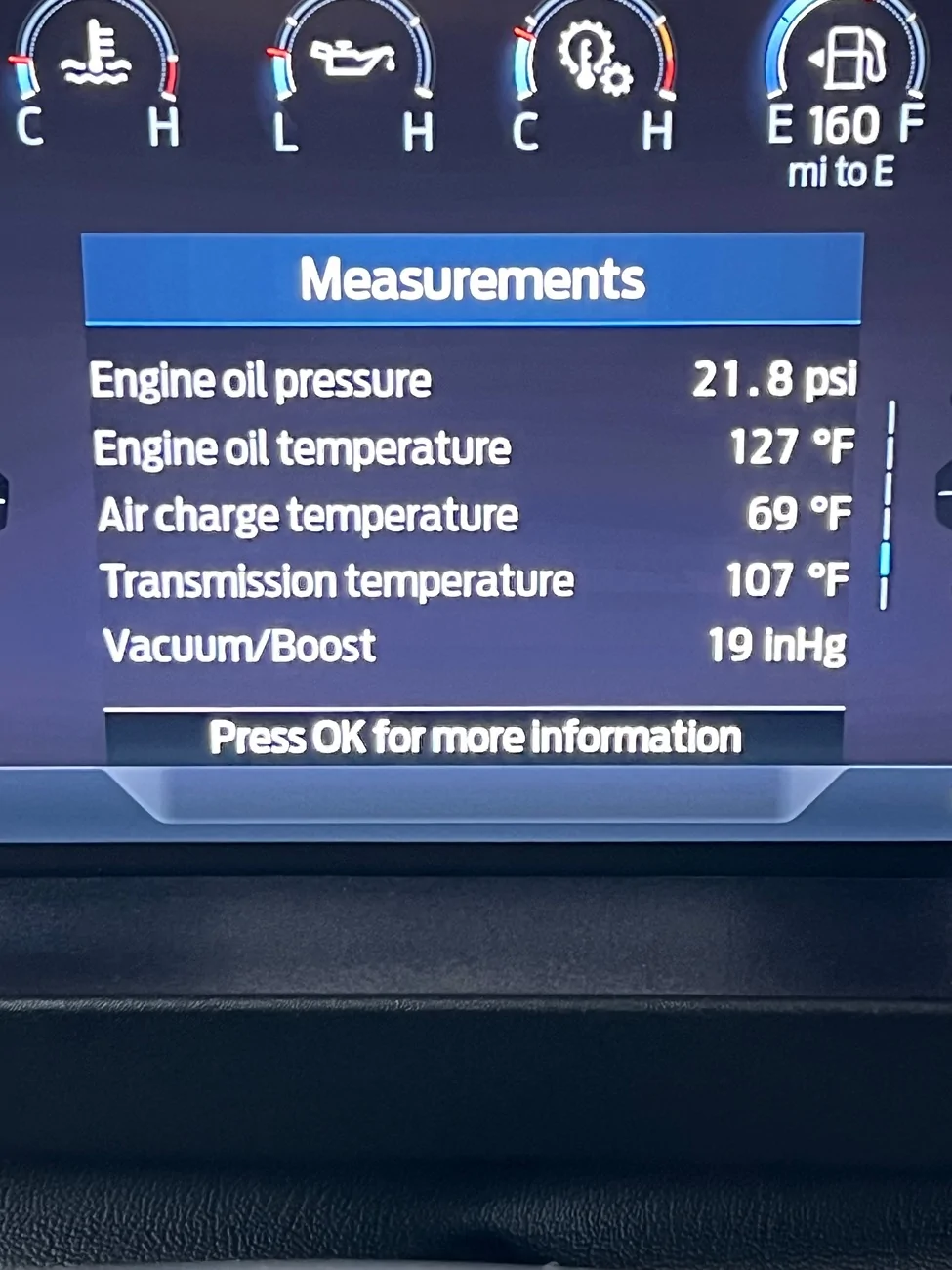

This is super handy info to witness. This is what I leave it on, on my dash readout. This is my readout at idle. Gives you realtime readouts & fluctuations on the fly. Here’s how you get to it. All through the steering wheel.
Hope this helps.
If you get the Procal, there is a realtime psi gauge you can select to monitor oil pressure in numbers. It is showing higher psi than the factory truck gauges are on my RR. Idle is 35 to 40 psi. When I'm on it, it goes up above 60 psi.
