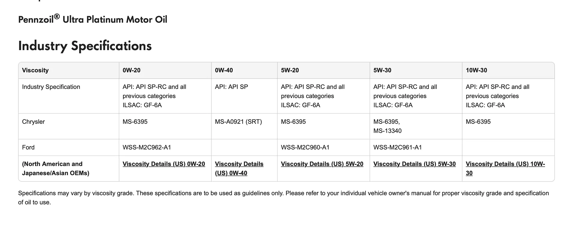

I always liked Pennzoil for years but I almost positive it does not meet Fords WSS-M2C961-A1 specification. Wouldn't want to give Ford an excuse for using oil that doesn't meet spec. However, haven't looked in quite a while, they may have updated to meet that spec now.

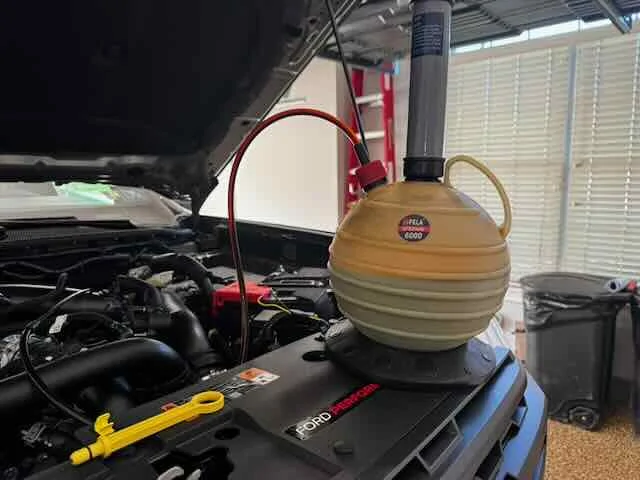

Did my first 1k oil change and swapped in the Ronin adapter. This is my second RR so I'm pretty familiar with procedure, but this time i took pics of some of the steps using Pella 6k extractor.
We are all very familiar with removing the OEM plug and having a gusher of oil come out. The Ronin will fix that... but for the first oil change I used my beloved Pella 6k oil extractor that has been in my garage for over 2 decades performing oil extractions on many different vehicles and small engines. Love this thing. I have to dump it twice in order to get nearly all the oil out. My truck was on ramps as well.
After using the extractor when I did remove the OEM plug a little less than an 1 oz. dribbled out. I was prepared with foil around the cross member to ensure it would not get soaked.... hardly needed it. I've read posts where people were asking about oil extraction on our engine and what was left in the pan after you start sucking air. Honestly... I could use just the extractor on future changes because of little was remaining in the pan.
First extraction. I have a larger container I use to dump and transport my oil to a facility that takes used oil. For real, this pump is over 20 years old and continues to work flawlessly.

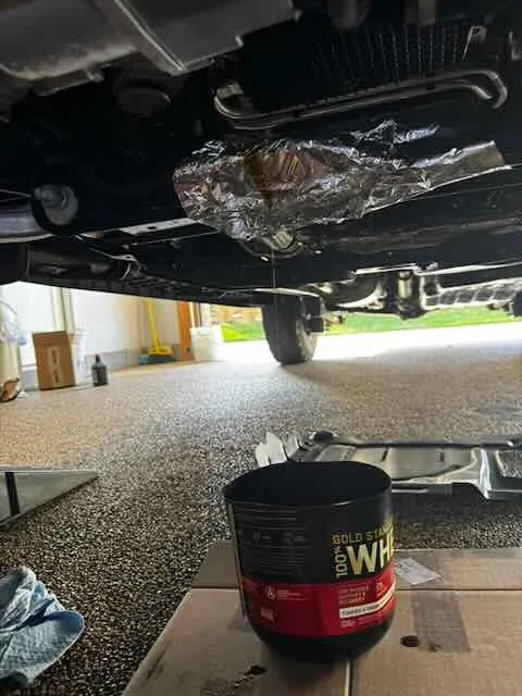

Preparing to remove the OEM plug..
Ford Ranger So What Engine Oil Are Y'all Running/Planning on Running? IMG_1486
I have a smaller plastic container I use to catch whatever is left in the pan after I extract the oil.

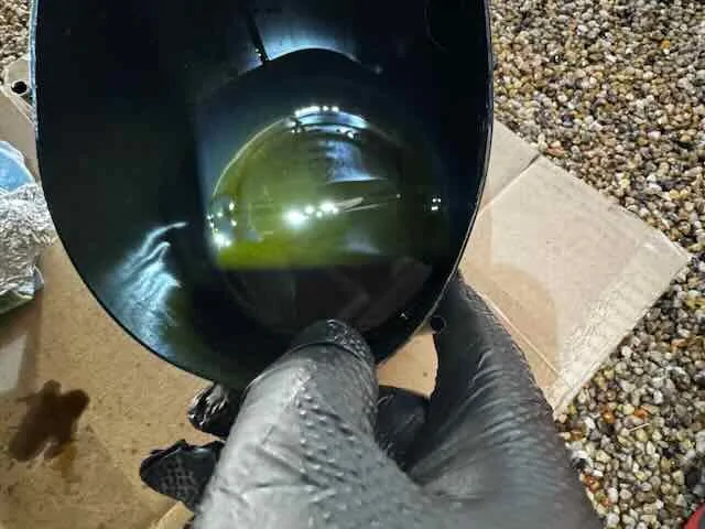

Hard to tell, but that's less than 1 oz. remaining in the pan after extraction.

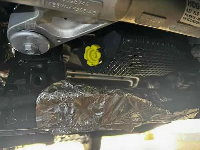

All set for next change. This will be faster than extracting as I'll have a tube going right into my larger plastic container I use for disposal.

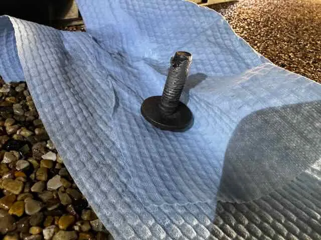

I've had many 4Runners and Tacomas and it was a must for anti-seize on the skid plate bolts for changing the oil. Keeping up the practice.

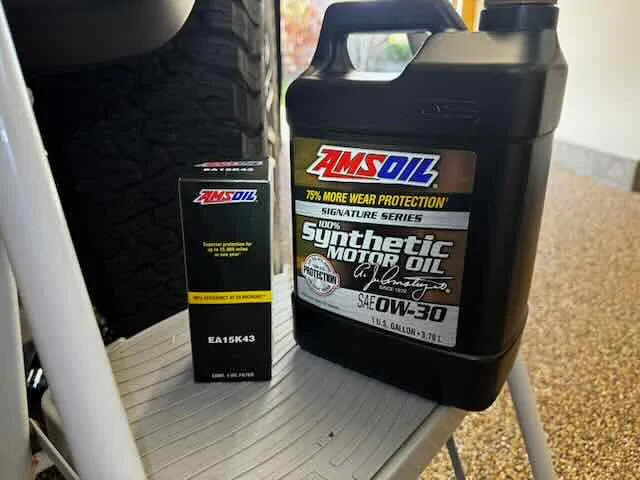

My choice for oil and filter

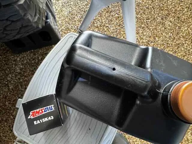

Little tip... put a hole in the top of the 4 gallon jug of oil to make pouring a lot easier.

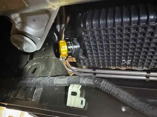

I just checked out the UPR valve. Nice! Wish I would have saw that before.
For me, Redline Euro-Series 5W30 and an Amsoil filter with the UPR drain plug.
https://www.redlineoil.com/euro-series-5w30-motor-oil
https://www.uprproducts.com/product...-for-mustang-f150-raptor-edge-explorer-bronco
I tried the Ronin drain plug, but switched the UPR plug. I like that the UPR plug is a single piece with a ball valve compared to the Ronin plug which is a two piece design - where you need to screw in the second piece to open up the valve for draining.
Nice! Did not know about the UPR plug. Might switch to that after a few changes. I like the one piece design. Thanks for posting that.
