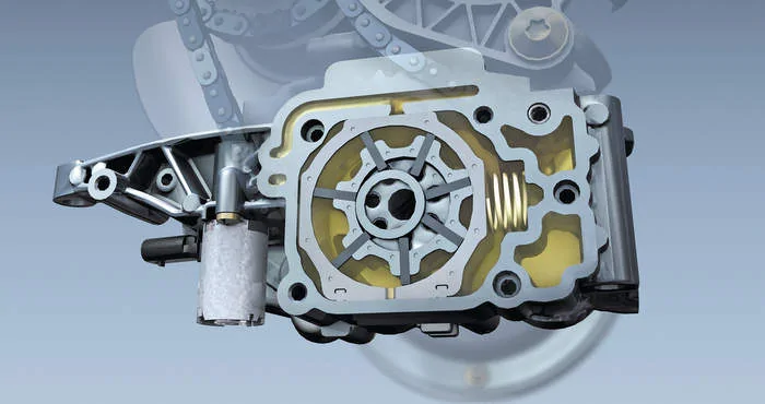

The newer engines all have variable geometry oil pumps that allow changes in pressure based on load. At WOT, my Raptor is around 55~65 psi (depending on oil temp and RPM), but on the highway, typically 30's ~ 40's. Idle, 21.8 psi (unless it's very hot, like 240F oil temp, it will drop a bit to 19ish).
The variable geometry pumps can reduce pressure during lighter load conditions to allow better fuel economy (reduction in pumping losses) without causing issues with lubrication. You don't need 60 ~ 65 psi all the time. They also can lower pressure on cold oil until it warms up as the viscosity is far higher.

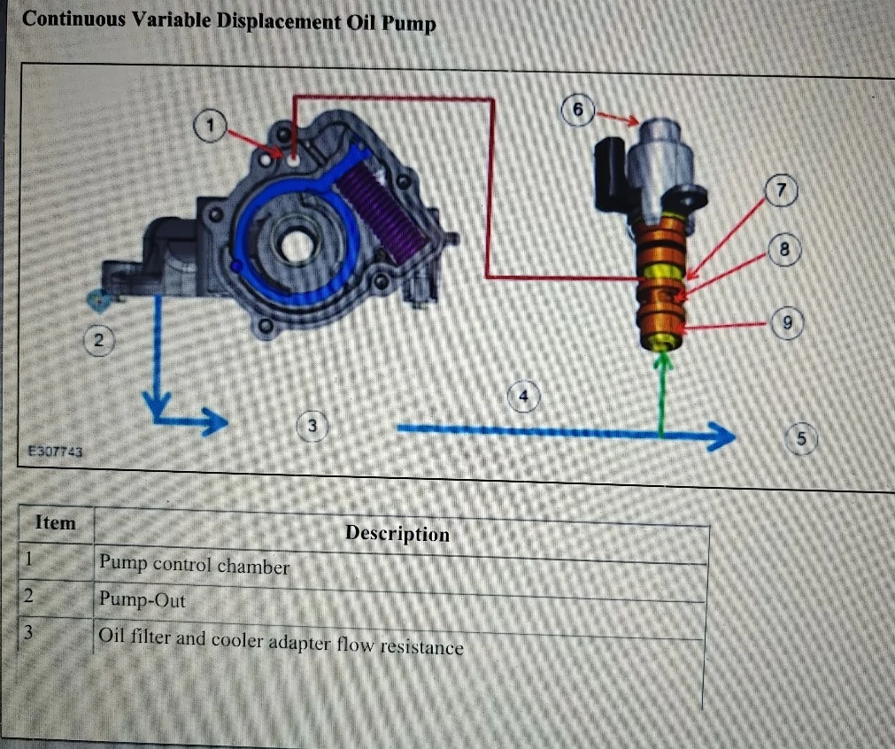

Variable Geometry Oil Pump:
Ford Ranger Engine oil pressure? 1765563330388-a8

Ford no longer uses a break in oil per say its usually the semi synthetic. Right out of the service manual.
The 2.3l, 2.7l and 3.0l Eco all use a Variable Displacement Oil Pump. Controlled by an electronic selonoid proportion valve.
2.3l at 121.9-175.9F, 1500rpm, 15.2-37psi
2.7l at 121.9-175.9F, 1500rpm, 16-24.7psi
3.0l at 121.9-175.9F, 1500rpm, 16-24.7psi
Be aware that is with Fords recommended oils and viscosity. My 2.3 usually when reading with a computer always reads higher than specs in manual, lowest Ive seen is 27psi.
