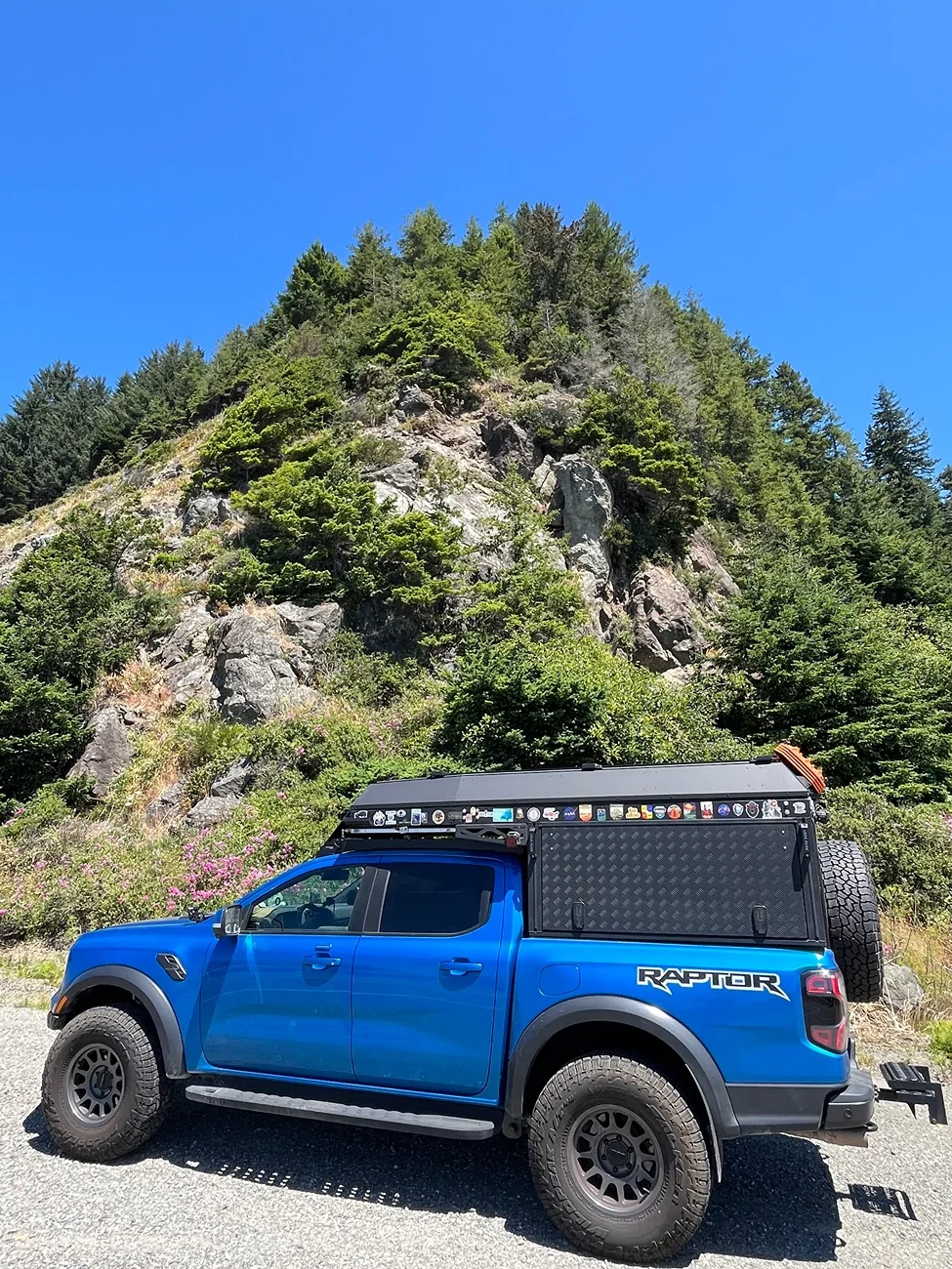

Hi guys, my situation is a little different as I am carrying a camper. While traveling out west the oil is getting hot and I’m getting a check engine light. This is particularly true when climbing the mountains out here.
Ford Ranger Is there an engine oil cooler for the Ranger Raptor? IMG_4077
I’m wondering if I need to get a larger radiator or some other solution.

CSF makes a pretty nice all aluminum radiator. The only aftermarket performance one I've seen so far.

I've got similar issues, no CEL though.
So far I switched to a Moshimoto transmission pan (aluminum, cooling fins, drain plug, 2qrts more) with AMSoil synthetic.
Planning to add a CSF radiator, bigger intercooler and charge pipes along with a CAI. (later this year when I have more time).
So far the oil pan is helping, been keeping an eye on temps with OBDlink.
Keep us updated with your progress!

Try also using TriboTEX DLC films in the transmission. It reduces friction losses by forming DLC films on wear surfaces, which helps maintain fluid temps. The Miss Madison poweboat team used it during development since they were cooking race gearboxes every race, at 40k per gearbox....gets expensive. After using In Situ DLC films their service life trippled and they only needed to replace it ever 3rd race. The fluid temps dropped a whopping 20C, better maintaining film strength. For reference, these are 2,700 HP jet turbine power boats hitting speeds of over 200 mph...on water...that use gear reduction boxes to drive the prop (kinda like the 1,200 HP gas turbine in the M1A1 main battle tank).
I've been using Sythetic MSH to achieve super lubricoty since 2019 in all my vehicles now. My 2016 GT was the test case. Did the entire powertrain on my Raptor at 5k miles, so as long as your past initial break-in, this may help with your temps.

There is a larger oil pan for the 3.0 liter engine in the ST. The ST guys love it. Adds 2 quarts of oil capacity so it should help keep things a little cooler. I haven't tried it, don't know if it will fit our trucks, it's the same engine, but there may be other fitment issues based on the frame being different.

Try using manual shifting mode and climb up mountains in lower gears. Modulate the throttle input to keep the torque convertible locked as much as possible (i.e. minimizing TC slip which generated heat in the transmission)
I drove up and down Rocky mountains with RTT & fully loaded truck bed w/o any over heating issue.
