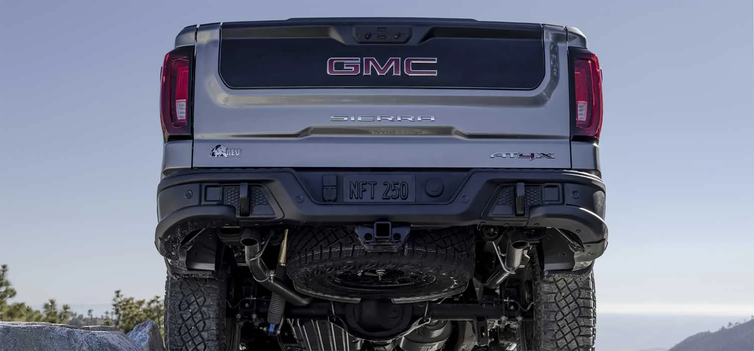

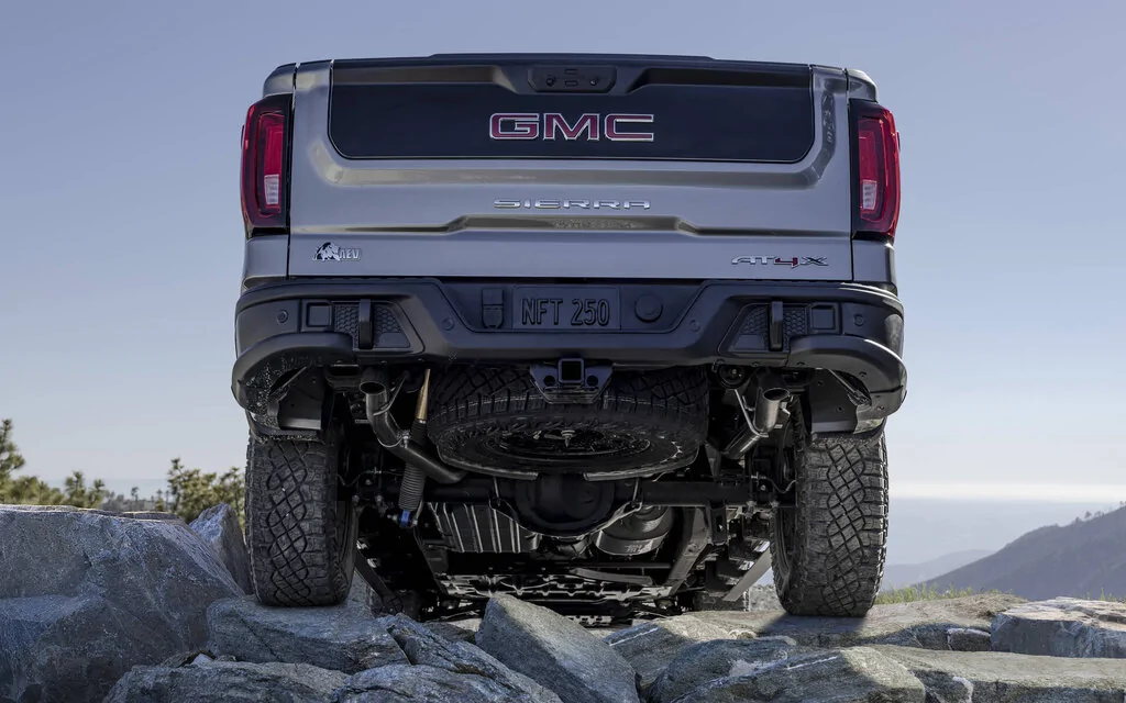

Would love to see tucked turndown dual exhaust like seen on the GMC AT4X .

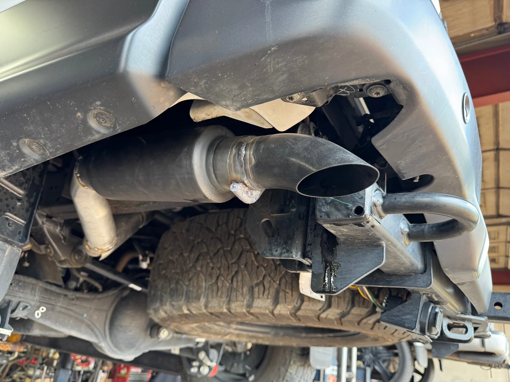

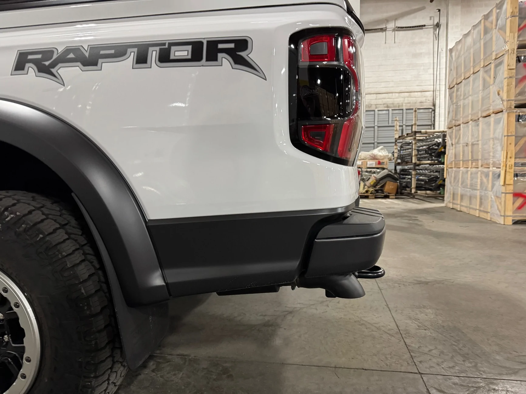

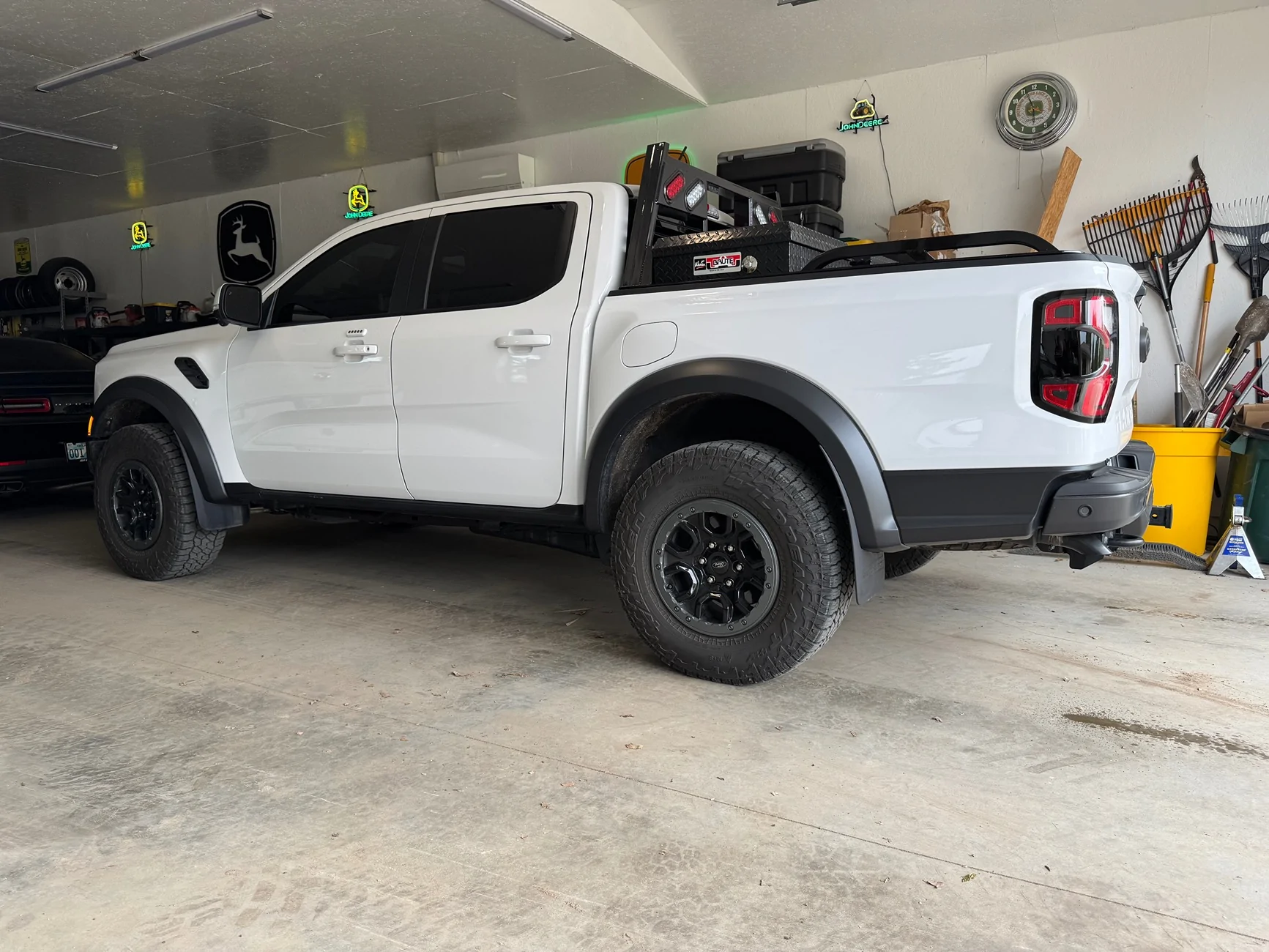

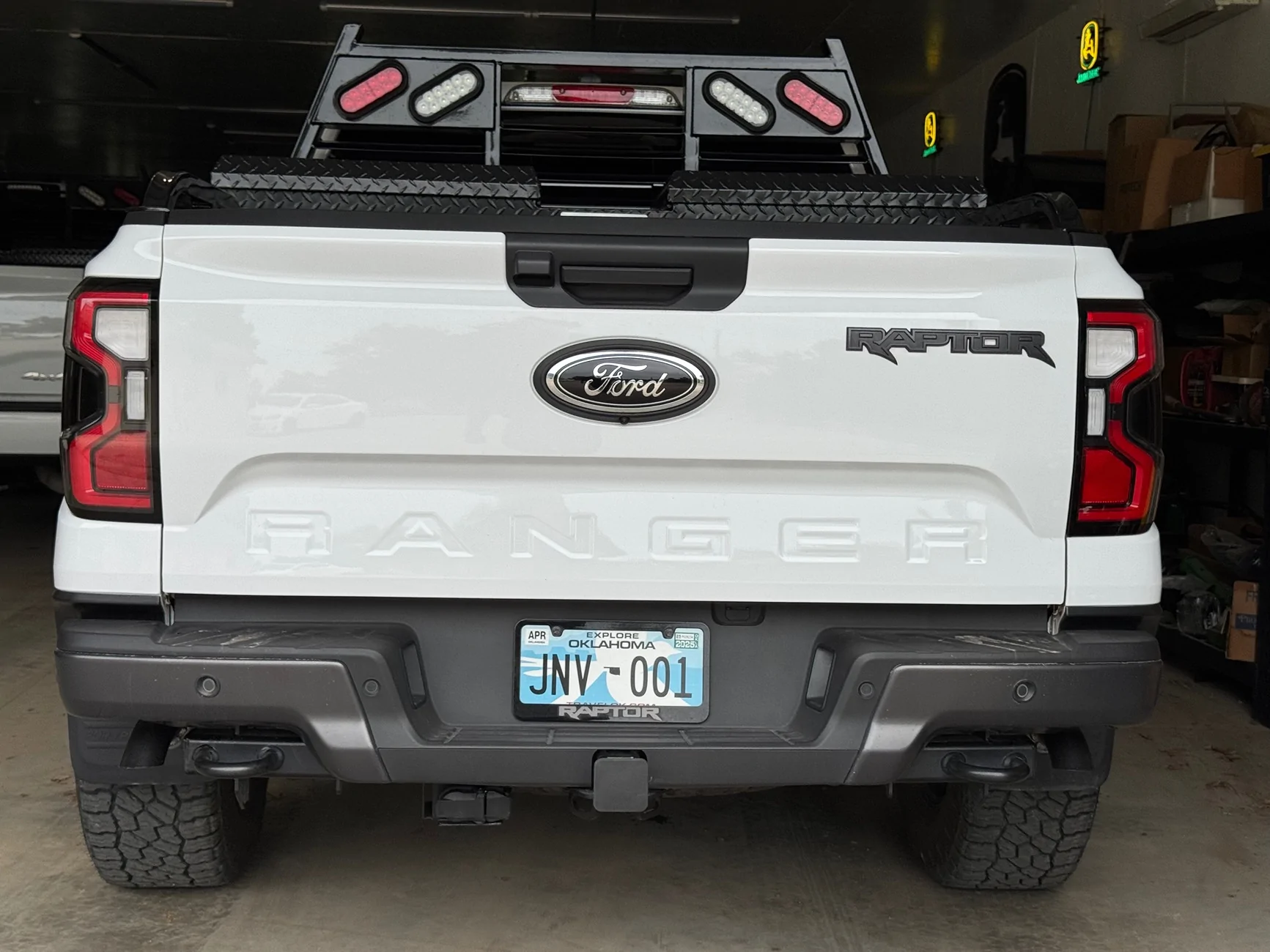

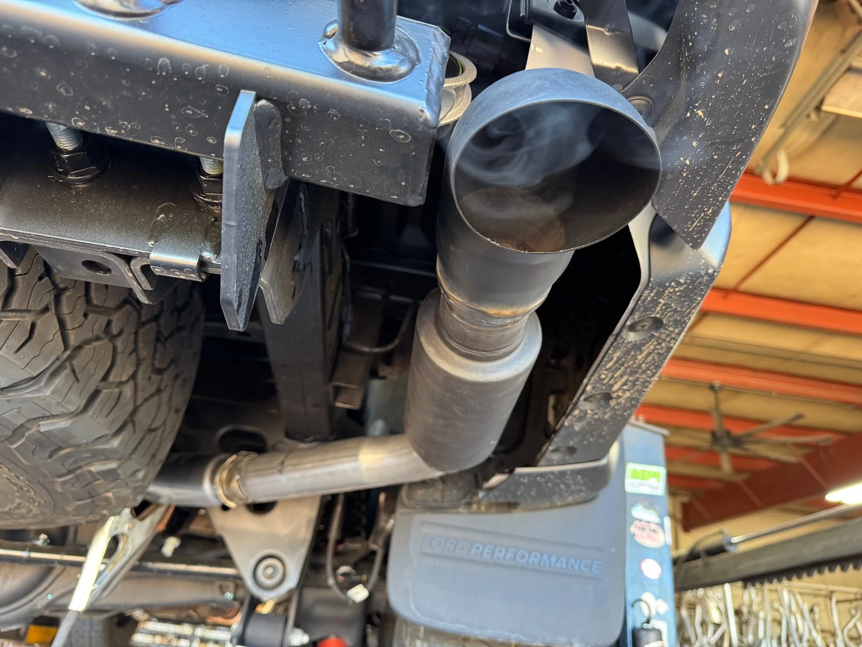

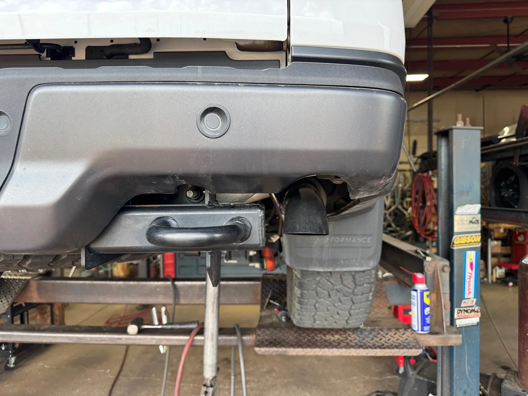

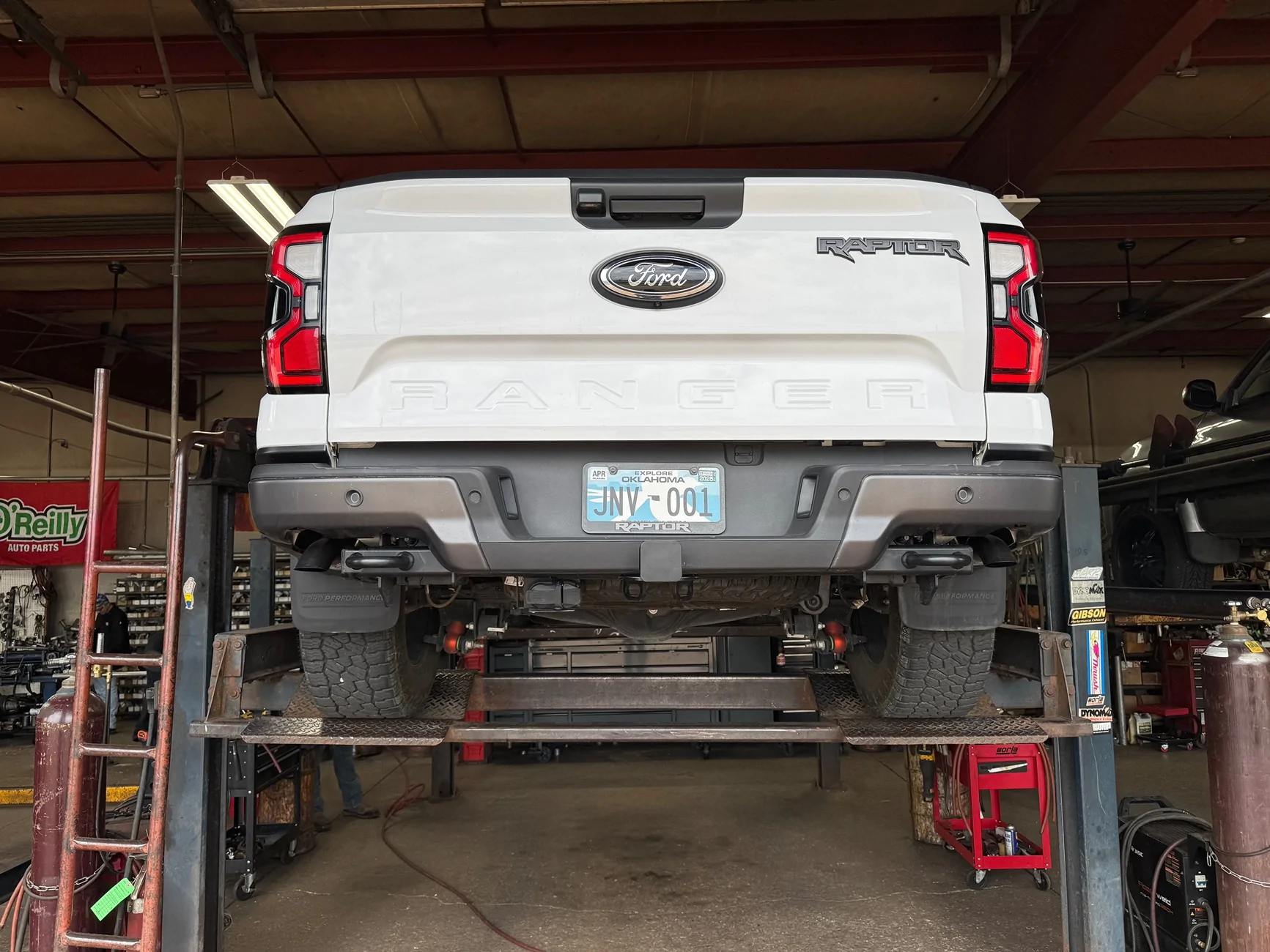

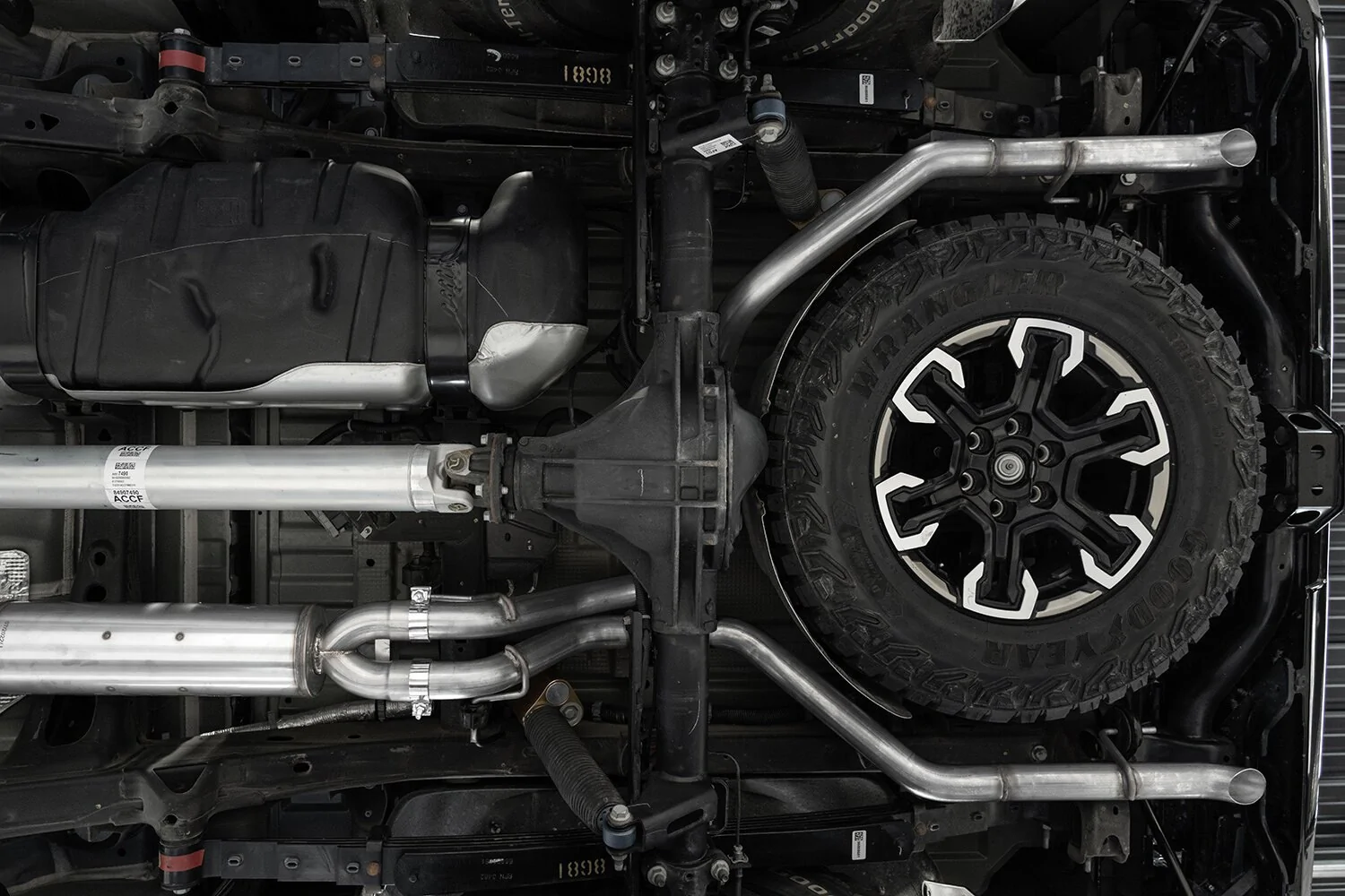

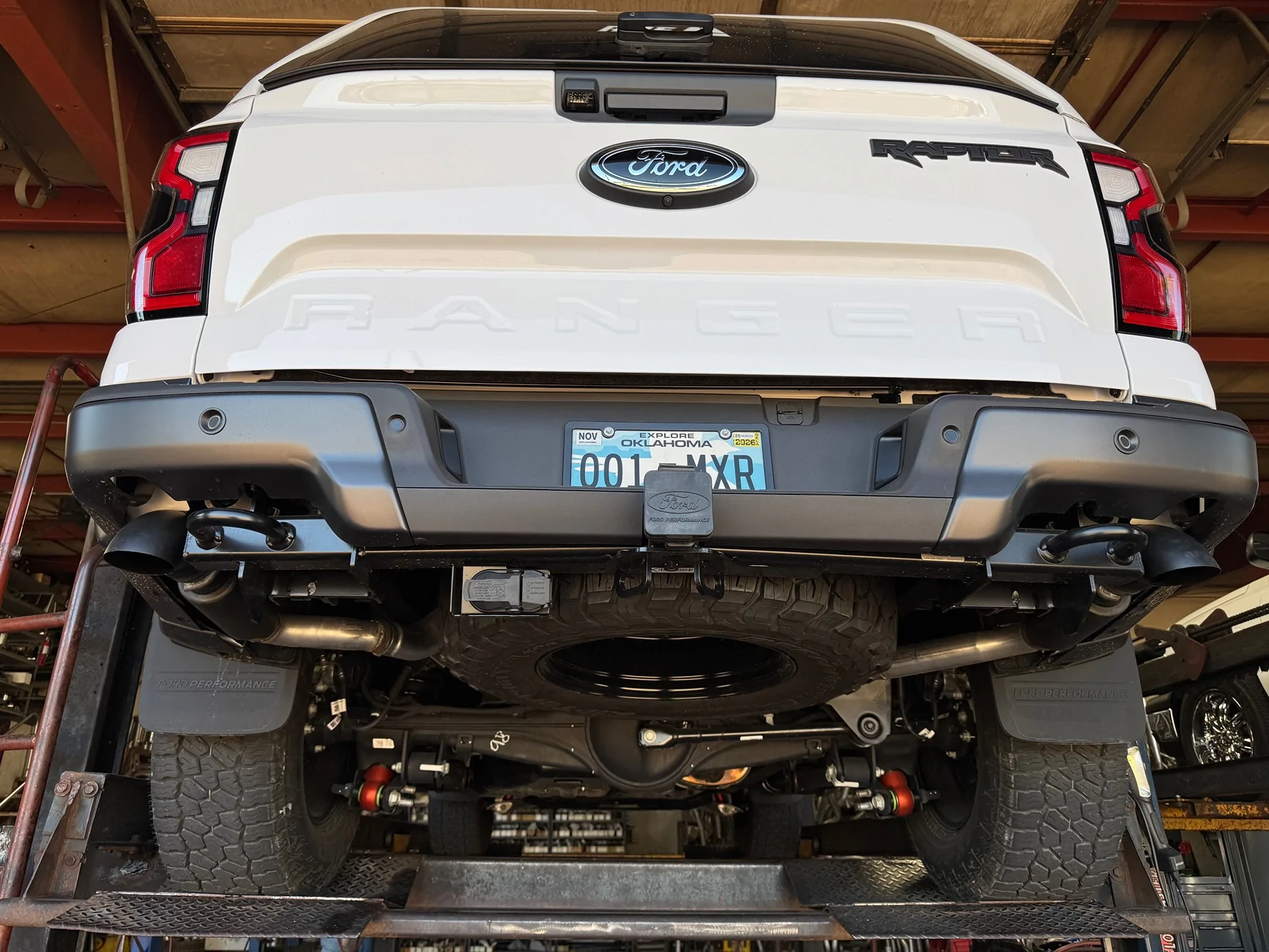

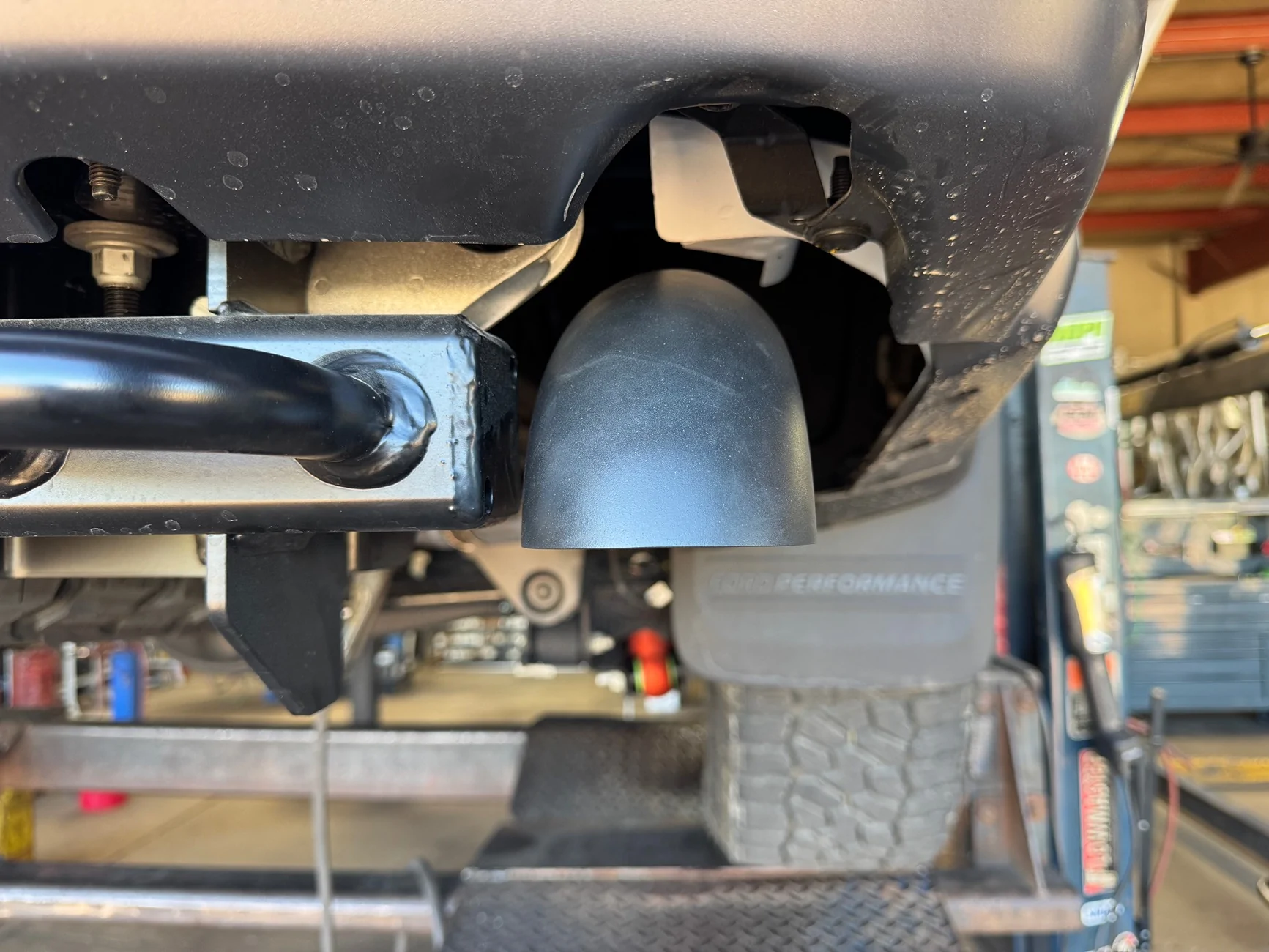

I went a custom route with some larger resonator cans and some custom pipe work and turn down tips to get quiet mode quieter, tone dealer, and cleaner look.
Space is much tighter under the RRs compared to that AT4x but we got it close as we could.
Used 3” turn down tips on one and 2.5” turn down tips on the other.

These are the 2.5” turn down tips and 2” longer cans.

Overall happy with the results on both trucks.

I love that exhaust, especially how it is right in line with the tow bar.
White looks really good with the black accents, flares, and no raptor sticker.
