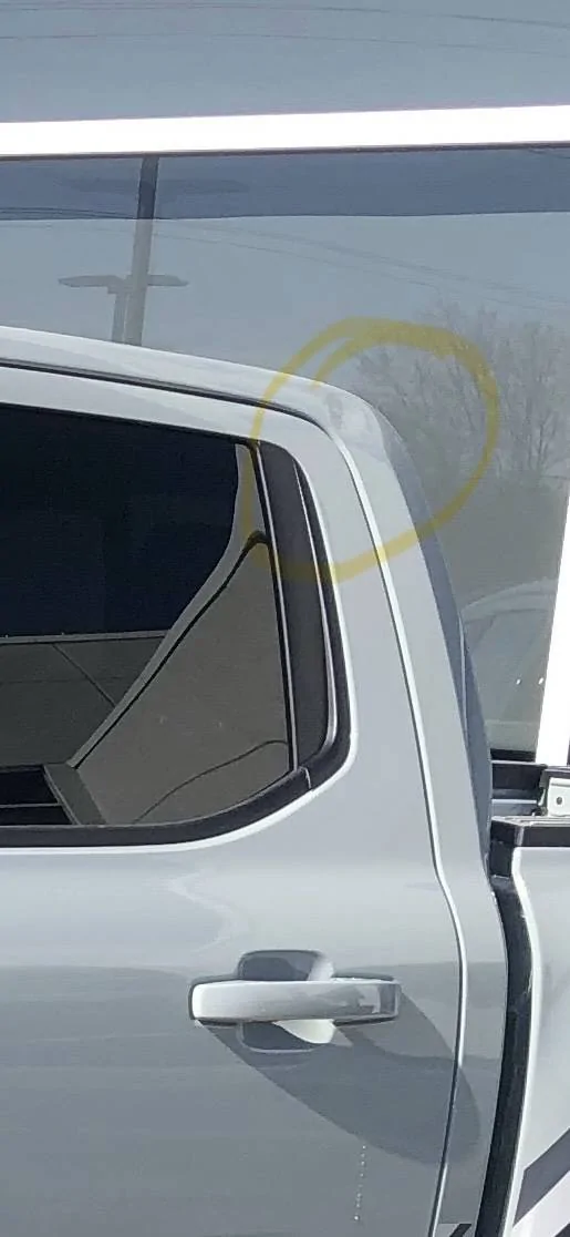

I took delivery in April from a Jan/Feb built date. Have similar issues as those above with the back seat not latching, door, tailgate and hood alignment, BUT also have a huge dent and weird buzzing noise from the charging pad. Any phone calls coming in or using the Navigation it will crackle.
I purchased my RR out of state and didn’t notice the dent until yesterday when I took in to get a clear bra and ceramic coating on it. The tech bee 🐝 lines it to the dent and says did you notice this? I was like WHAT! He said he had a guy drop his RR from out of state and it had the exact same dent and scratch in the exact same places! . I called @Ford Motor Company (@Ford) / X and was told since I didn’t purchase the “dent coverage” it was going to be out of pocket! Then she proceeds to tell me that I had great coverage for everything else I purchased with the extended warranty! I love everything about driving this RR but that dent but a dent in my “heart” about Ford!

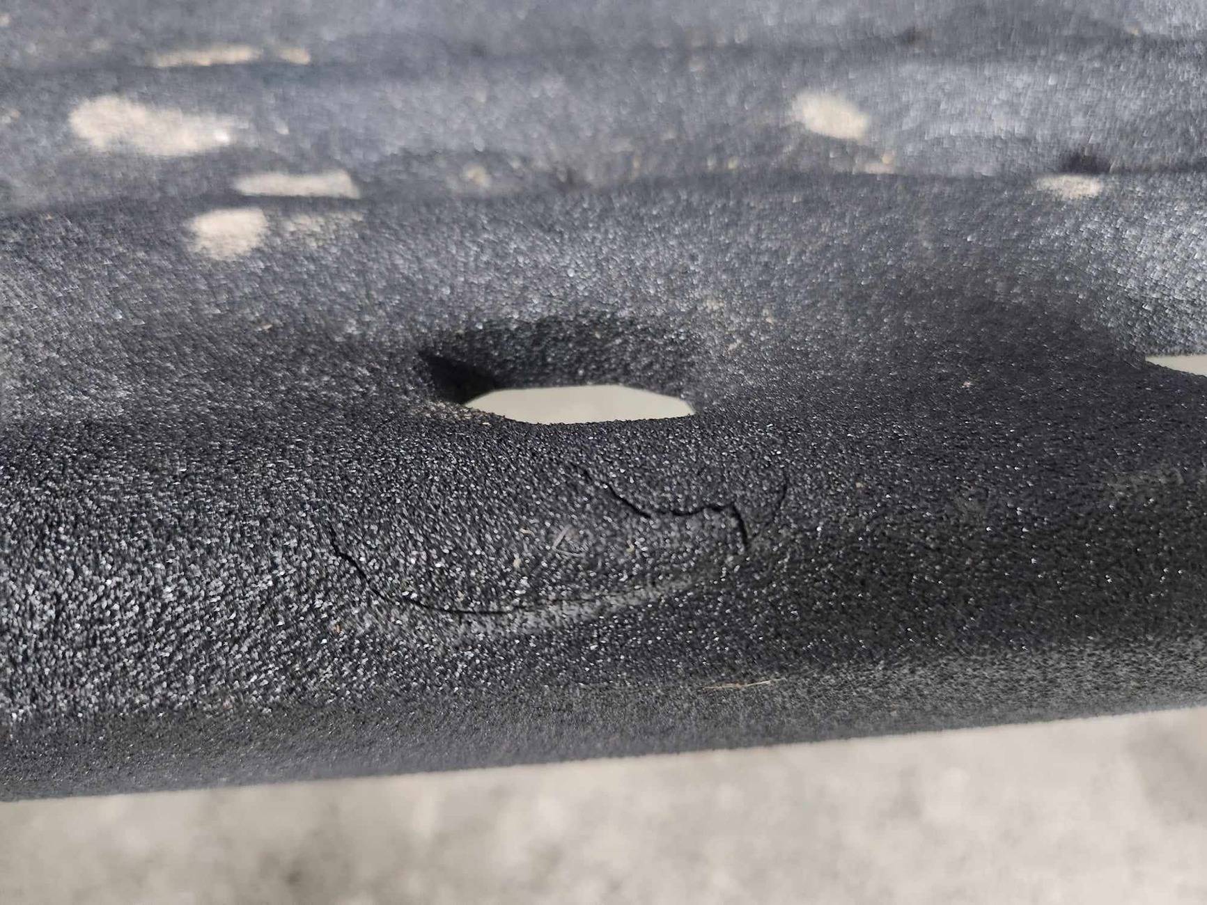

Check the side steps. My driver side had a pretty decent sized defect where the textured material did not adhere to the step itself. The dealership ordered me a new one under warranty. I found it during the delivery inspection.
