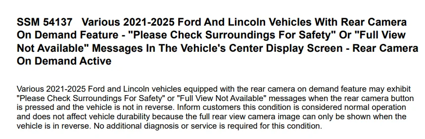

2025 Lariat. This message is letterboxed on the screen when turning on the auxiliary cameras while driving.
What does this message mean?
Is there a way to disable it? I can't find a way to click "OK" to make it go away.

forscan. look in the spread sheet/asbuilt thread.

Pretty sure this was removed on a software update? Have a look to see if you have the latest software

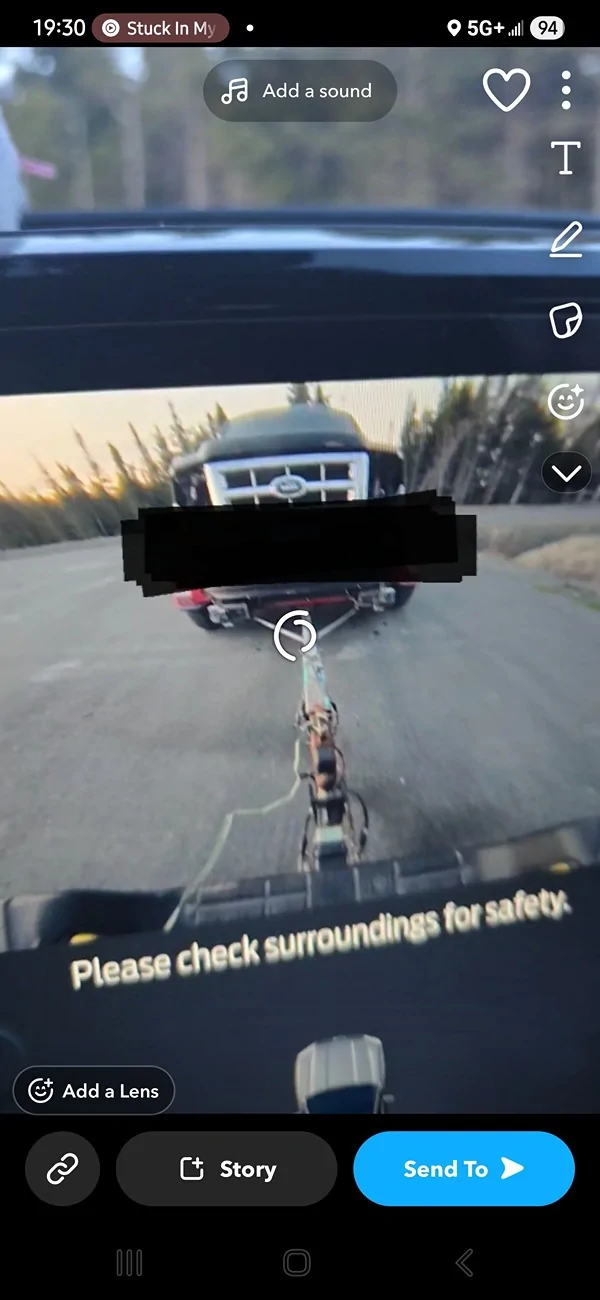

What does it mean...
For me it was a safety hazard. I use my camera to sporadically. checking on my trailer, to make sure my straps didnt come loose on some expensive cabniets, or my atv, or when I was towing my old parts suv to the recyclers. and that display was right in the middle of where the tiedowns were. so I disabled it using forscan. I didnt have the bright yellow straps on yet in this one. but right where the box is too, would of blocked them. or like when I was hauling custom hardwork expensive cabinets in my trailer, and wanted to make sure they didnt shift..
