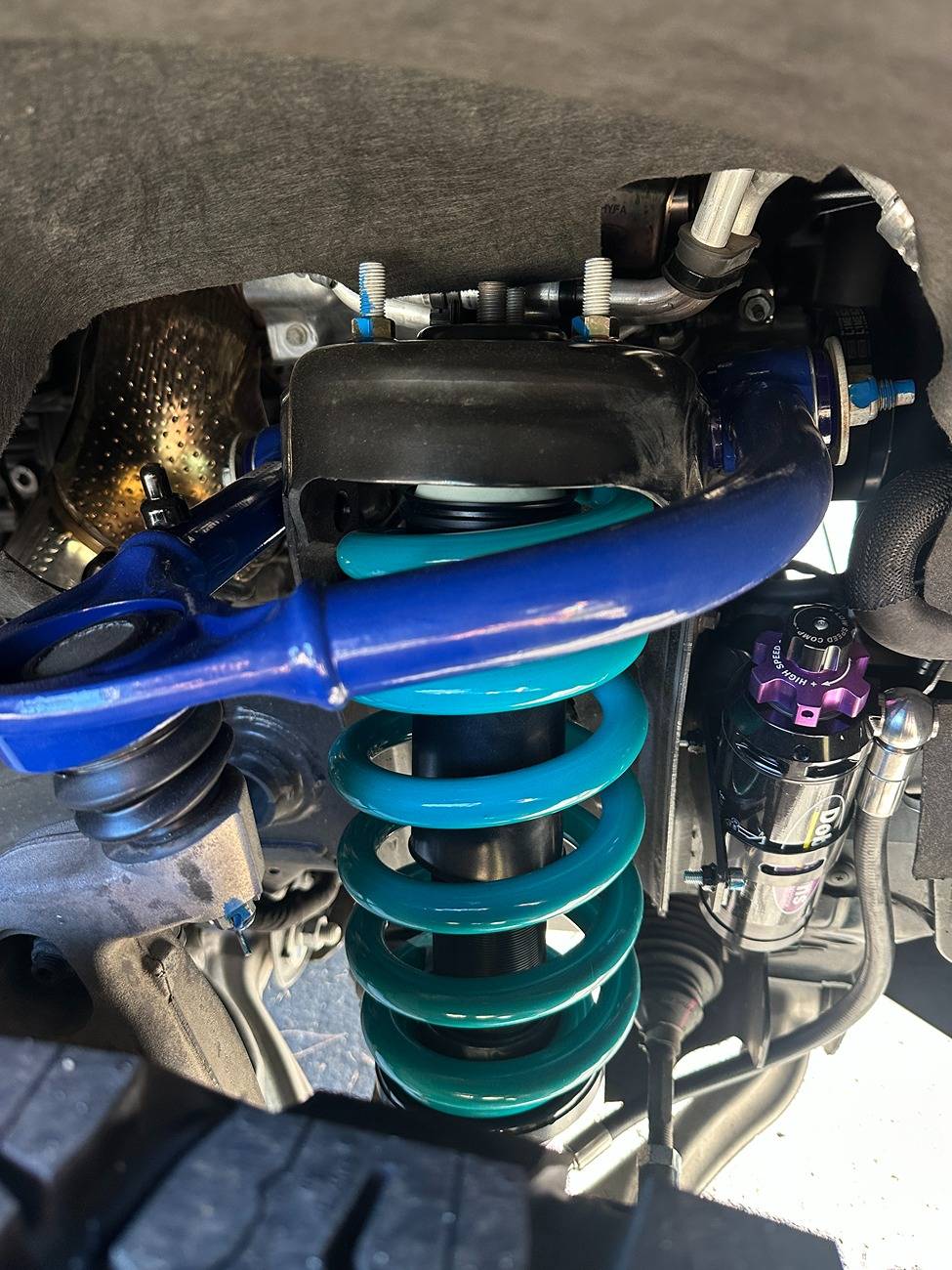

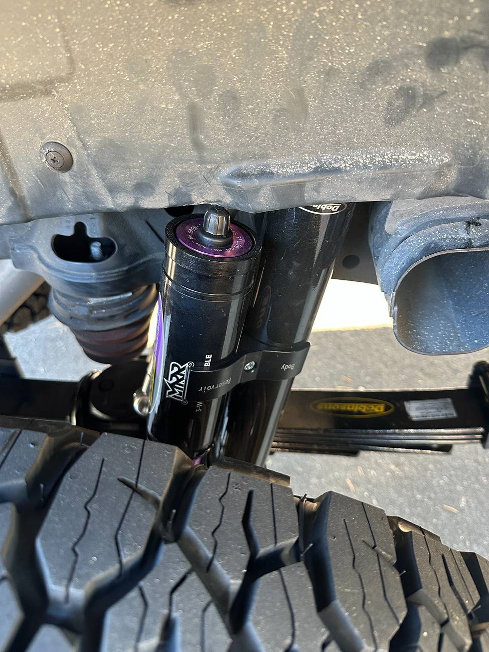

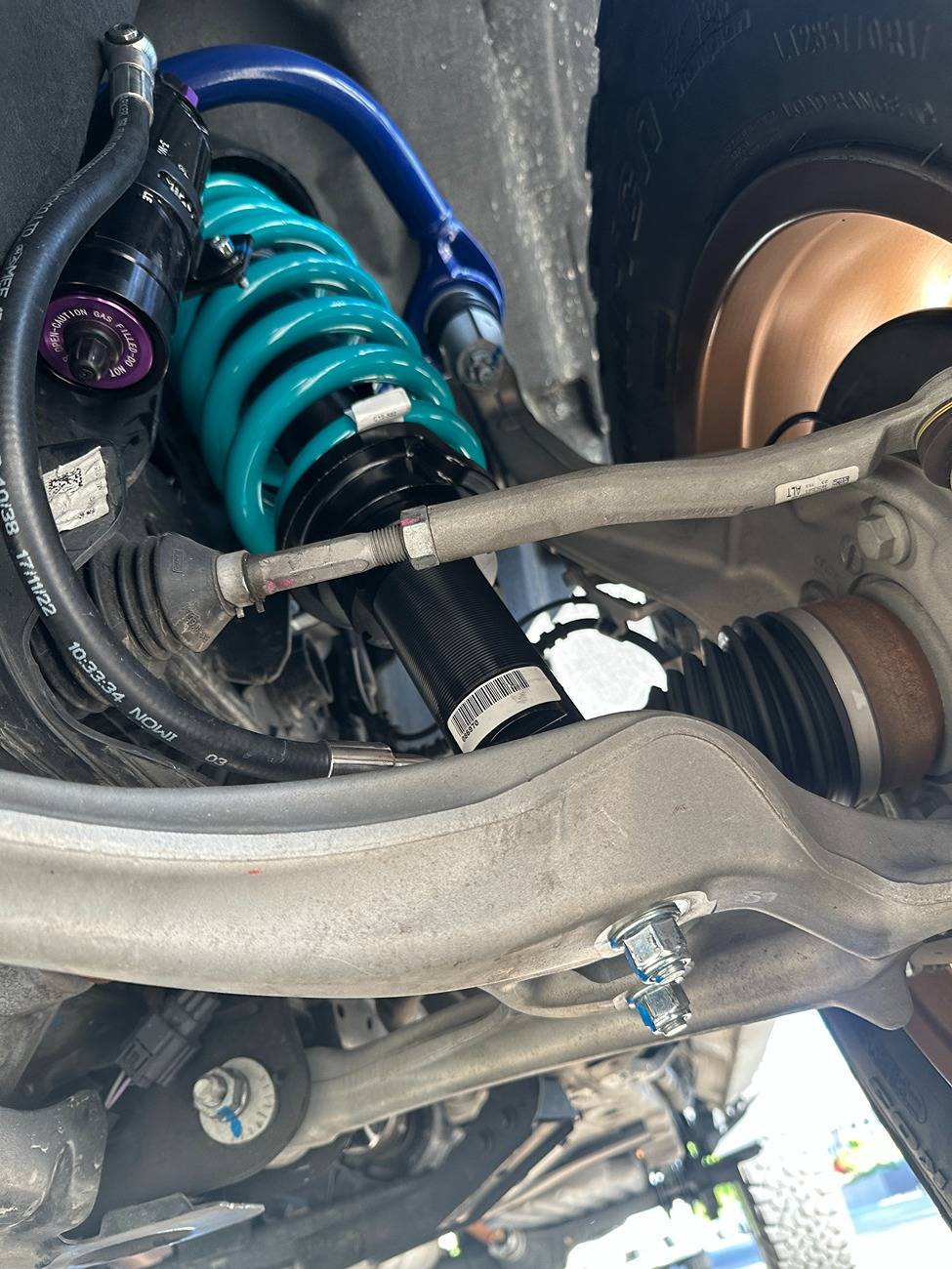

I just got my truck back recently from installing the Dobinsons lift kit. This lift
I ended up getting new wheels and tires at the same time. Went with these Method wheels with 0 offset 701 in bronze
For tires, I went with ko3 BFG AT in 285/70/r17 size
While I was at it, I replaced the upper control arms with these from SuperPRO USA UCA
The rear sits a little higher. I could probably crank the front lift a little bit higher to sit truly level but right now it doesn't bug me and i don't want to put extra strain on the components up front. I'm also going to put a RTT on the rack so that may sink the rear just a little bit.
The ride is much better than stock in my opinon. I really like the stance and I like that the 0 offset gives just the smallest amount of tire poke out the side. I've only been driving it a few hundred miles but so far I'm very happy with the dobinsons kit.
The sample size is too small but so far it seems like I may have lost ~1 MPG with the lift and tires.
I hadn't seen many people on here post about the Dobinsons kit but the company has a pretty great reputation and after talking to their reps at Overland expo I pulled the trigger. It's definitely pricey, especially with the reservoir option but I have no reason to regret the purchase so far.
