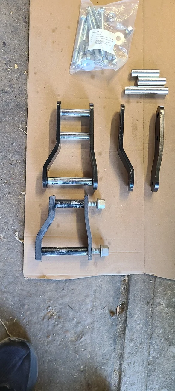

It looks great and the shackles are plenty solid, like one would expect. They are indeed angled exactly like the 6th gen ranger rear shackle and the hardware fits perfectly. This is good because its giving more options for mods for people down the road.

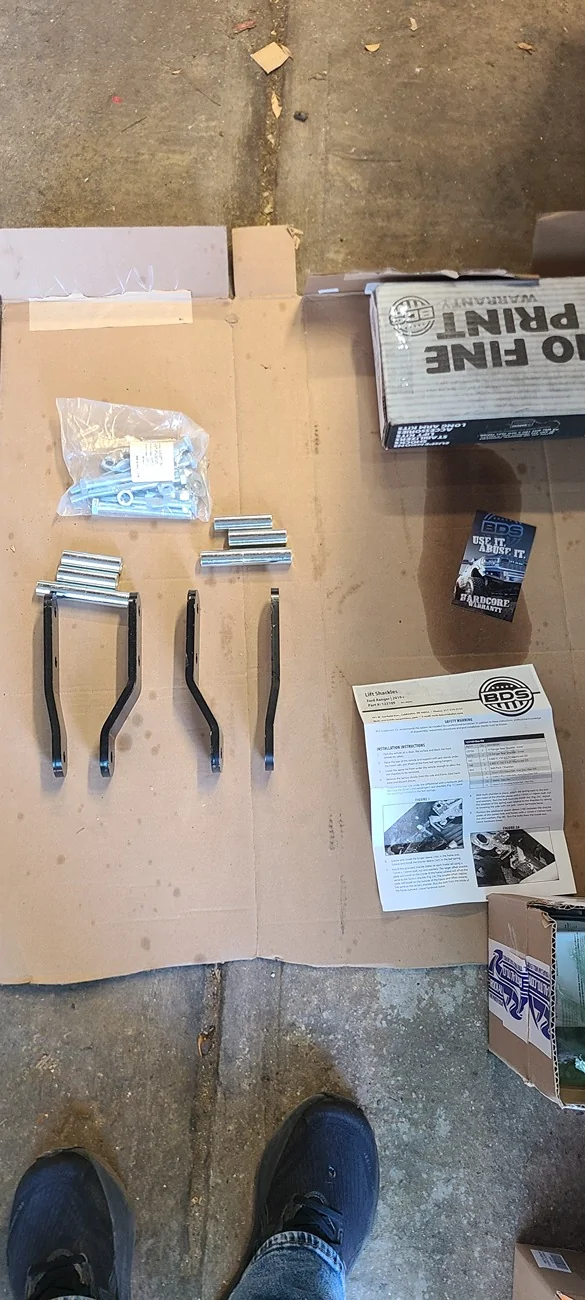

Here are the shackles laid out with the hardware and instructions. They are well packaged and the instructions, though generic, give you basic steps and importantly, the torques at the end.

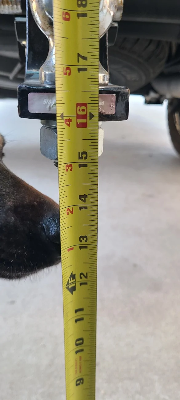

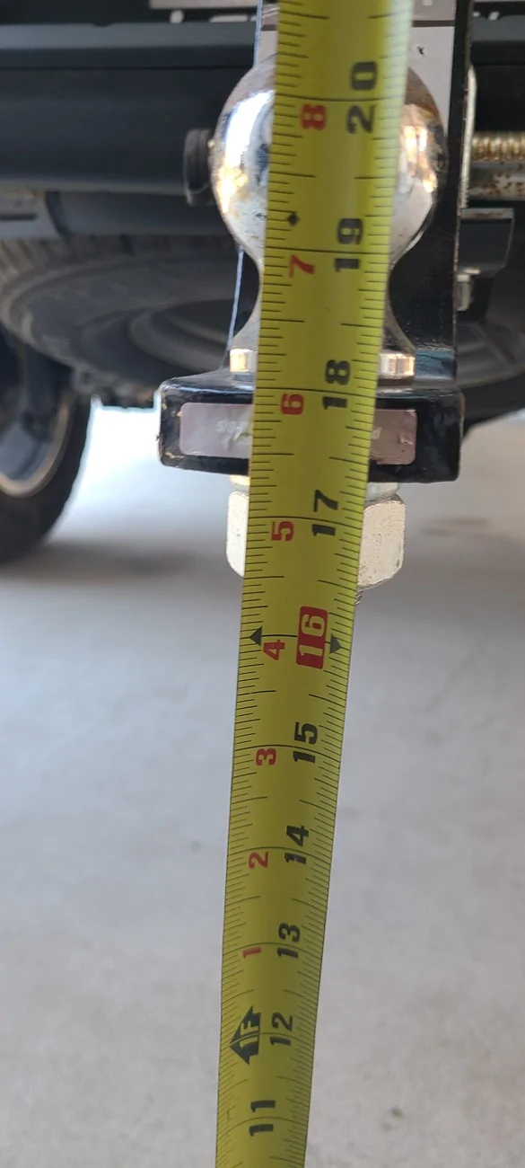

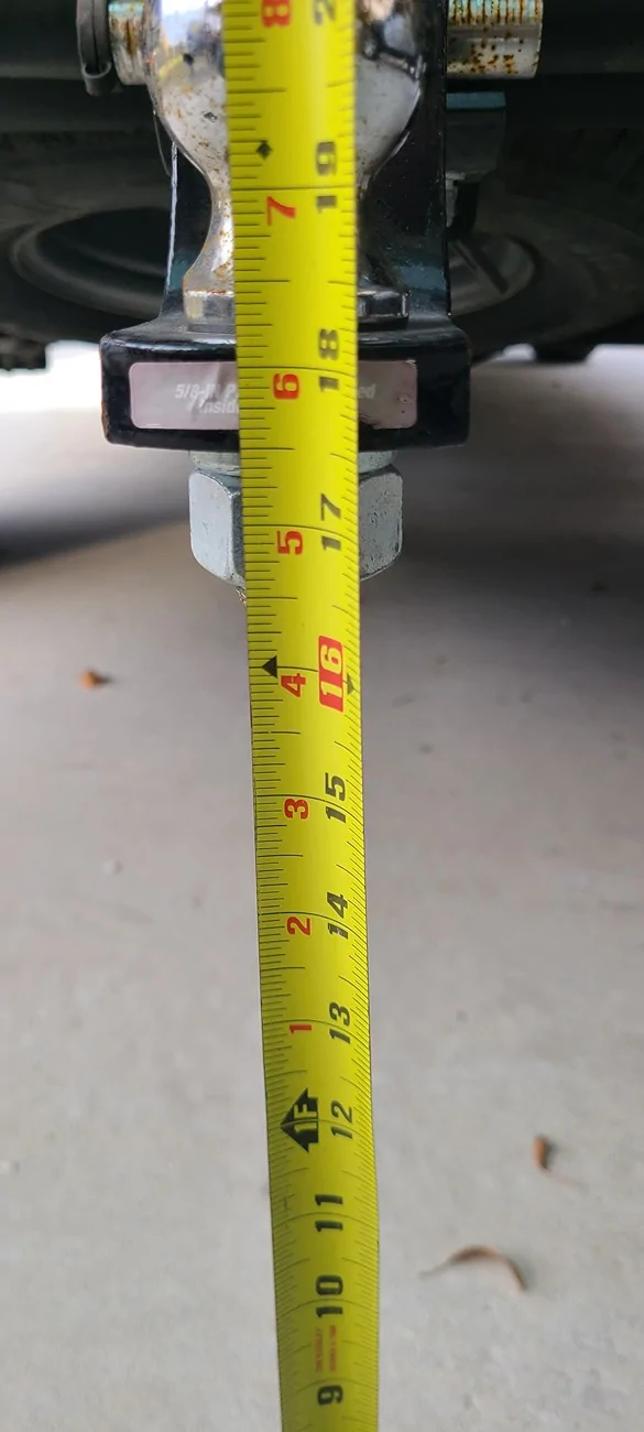

This is the hitch on the stock shackles. I figured this is a great refetence point since its easy to measure from.

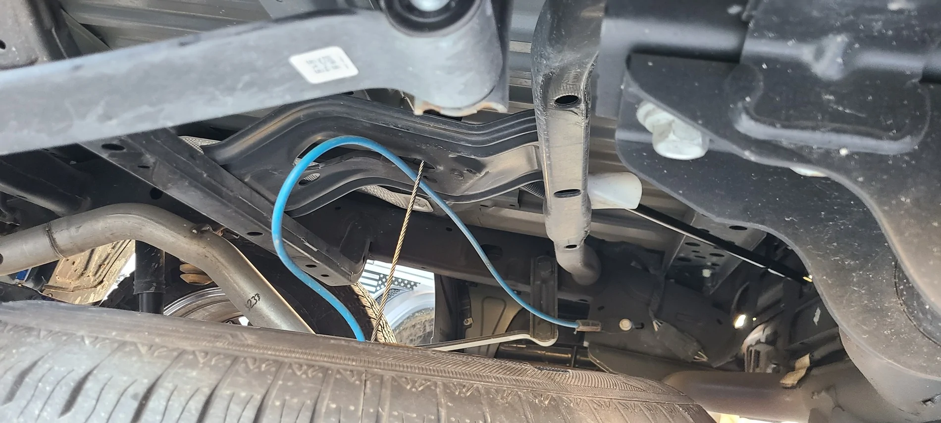

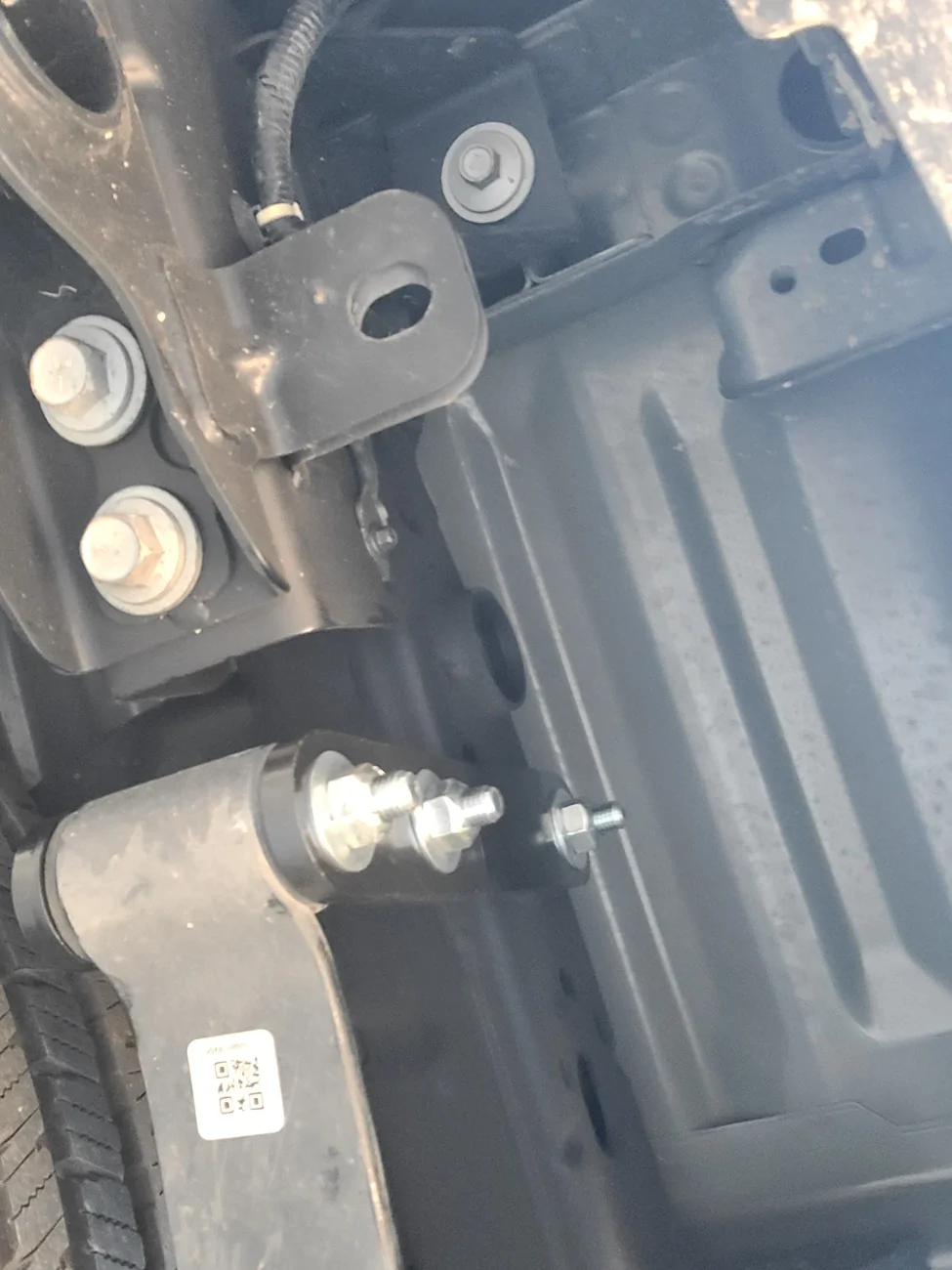

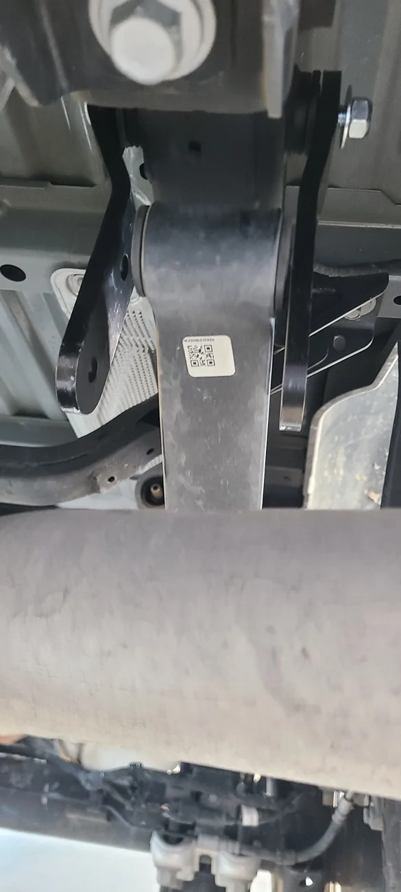

When you lay under the back, you will immediately notice the spare makes it impossible to remove the driver side shackle so go ahead and lower the down. While you are there, check the air pressure on it since its accesible. Its also a good time to clean and grease your spare hoist if you need to.
Ford Ranger 2019-2023 5th gen ranger BDS rear shackle lift kit fits on a 6th gen 2wd 20260131_123258

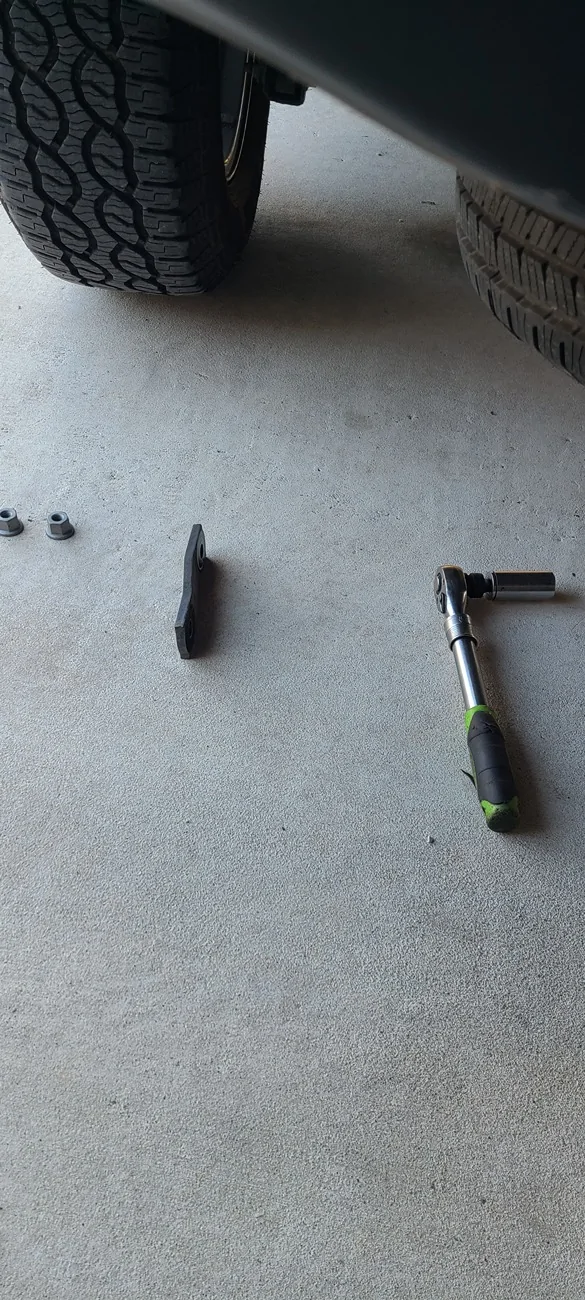

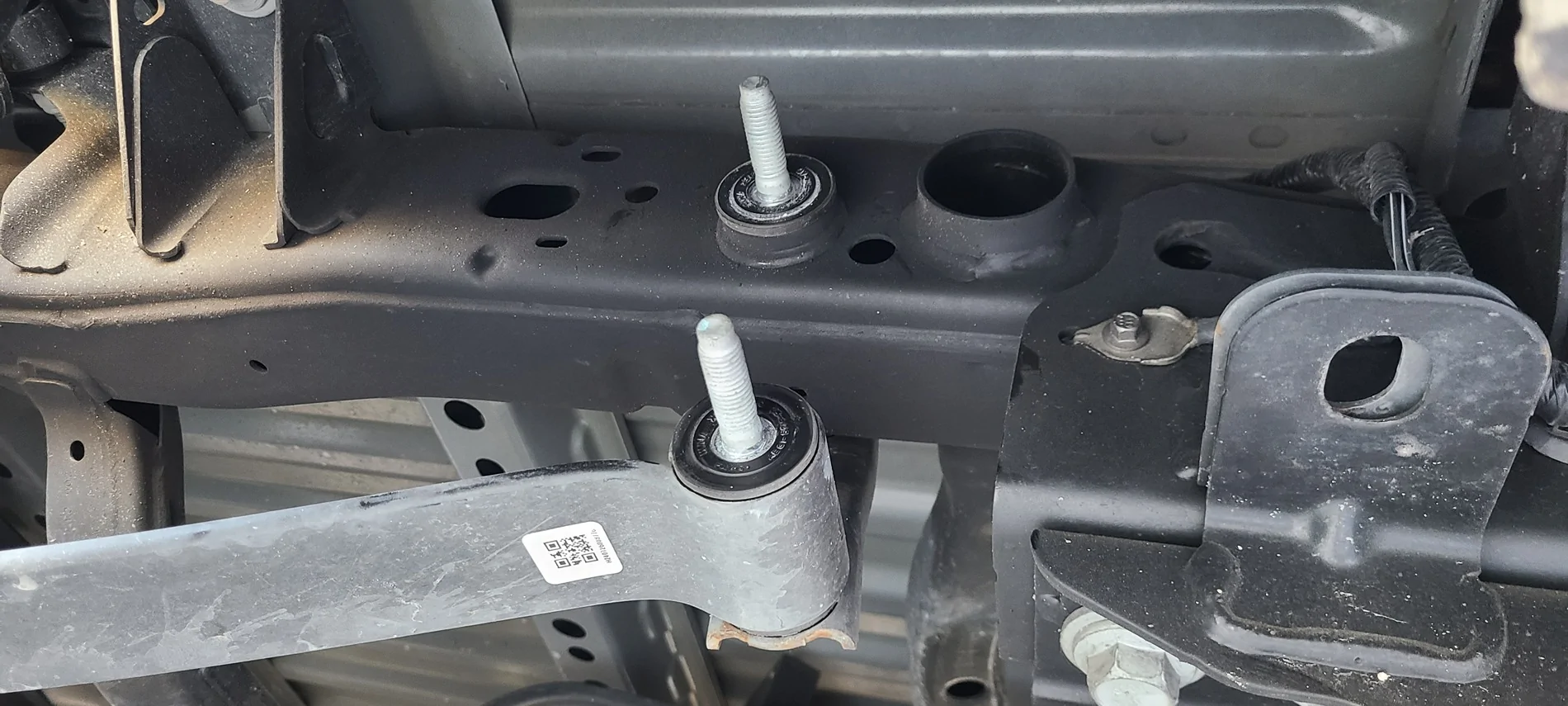

The stock nuts on the stock shackles are not very tight. I was surprised. I think i used a 3/4 socket and extendable ratchet to loosen the nut but you can do it with a normal ratchet. If you play with the jack, you can find where the height lets you easily tap the captured bolt assembly out with ease and maybe you can just push it, if you get it super close so there is no tension.

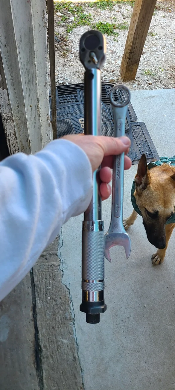

Here, you do the inital torqueing to 52 foot pounds on all 6 bolts. Of course, you torque the nut and hold the bolt head, both use 3/4" tools.

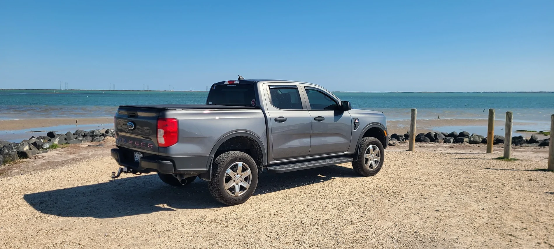

Here is the hitch height after the final torque showing i got, basically, 1.5 inches of lift with the shackle install.
Ford Ranger 2019-2023 5th gen ranger BDS rear shackle lift kit fits on a 6th gen 2wd 20260131_135428
I am sure it will settle a little more over time. If i remember, i will measure at the 500 mile recheck of the hardware torque that the instructions say to do.
Ford Ranger 2019-2023 5th gen ranger BDS rear shackle lift kit fits on a 6th gen 2wd 20260131_134629
And now you done with your install and the truck looks great.

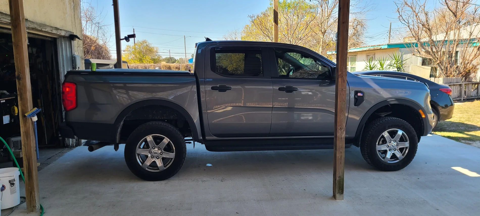

Thats where mine was,but I also have the complete Rival skid plates,so you may be closer to actual level.
With the BDS shackles,mine sits an inch and 3/8 taller in the back.
Really an overall perfect stance for me.

That is incredible! What wheel offset and tire size are you running?
White willy
Apr 11, 2025
116
191
Earth
2025 Ranger
Thank you,
They are 17x9 with zero offset,and a 285 General Grabber X3 tires.
