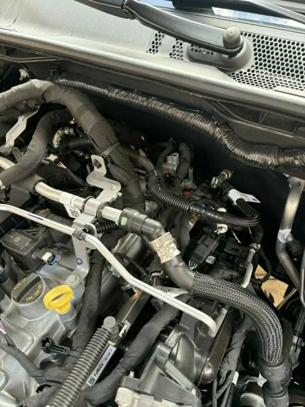

KevinH-TX
Kevin
Apr 1, 2026
Pearland, TX
2026 Ranger XLT 2WD
Are the direct injectors now on the left side of the head, coming in from the top? The high pressure fuel line appears to head over there, after teeing off from the port injection fuel rail.
yerkool
Warren
Jan 21, 2026
93
106
SoCal
2025 Ford Ranger Crew Cab FX4
I have a late 2025 Model 2.3Ltr(Vin# date on mine says 12/25)
The port fuel line is on the driver side VERY visible, can’t miss it, The DI injectors are further down.
KevinH-TX
Kevin
Apr 1, 2026
Pearland, TX
2026 Ranger XLT 2WD
Why does the fuel line cut across the top of the engine, to the passenger side?

yerkool
Warren
Jan 21, 2026
93
106
SoCal
Welcome to Ford engineering, I would prefer it that way for me incase of future repairs for that particular deal on injector issues.
