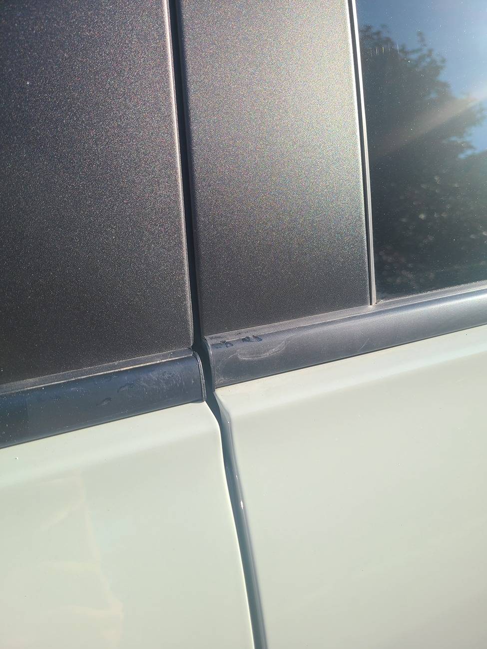

2024 Ranger XLT
Hey all, just took delivery of a 2024 XLT. Overall pretty happy with it, just noticed an issue with fit and finish of the driver side doors. Anyone else have this problem? No leakage thankfully but still ticks off the OCD.
Ford Ranger Doors not lined up - XLT 20240808_082351

Sometimes the whole body structure is out of spec to the point that what your seeing is the best compromise possible. I'd look at the wole opening shape around the door, and the gaps as a whole. Might be a larger issue.

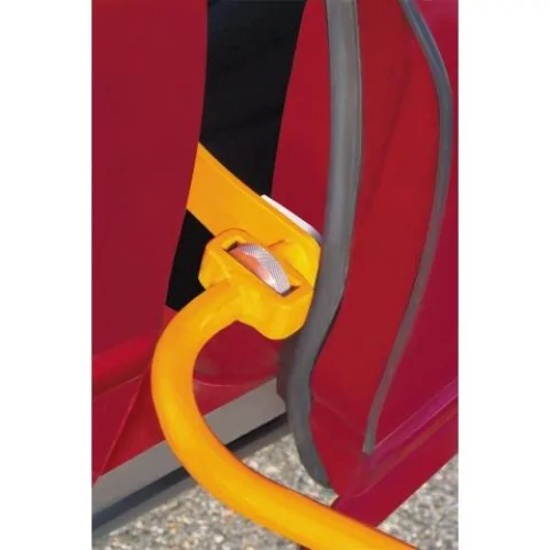

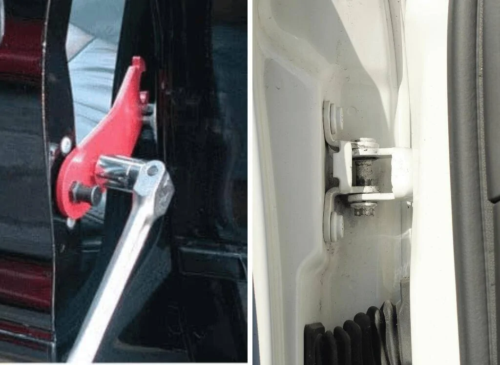

If they do it the easy way, there are several tool s available and they simply check the chassis locking lug for alignment with the actual locking mechanism, as demonstrated with either tool 1 or 2 pictured below;
Ford Ranger Doors not lined up - XLT IMG_1272
Ford Ranger Doors not lined up - XLT IMG_1270
loosen the jam nuts slightly, lift the door and retighten the jam nuts.👍🇺🇸
