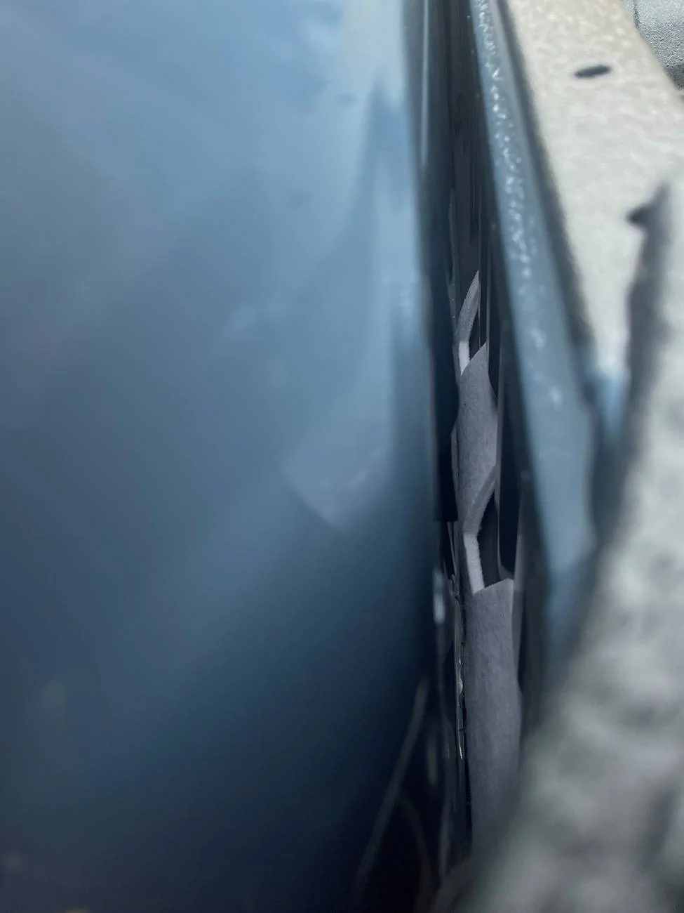

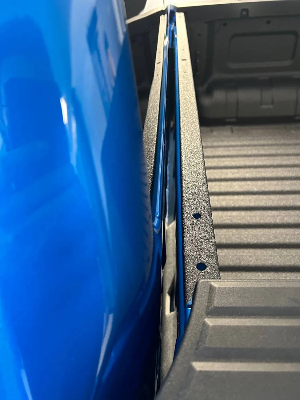

Has anyone seen this insulation stuck between the bed and the cab of the truck? I believe it’s keeping the pressure relief door from opening when doors are shut. Just want some feedback before I get a tool to grab it and yank it out

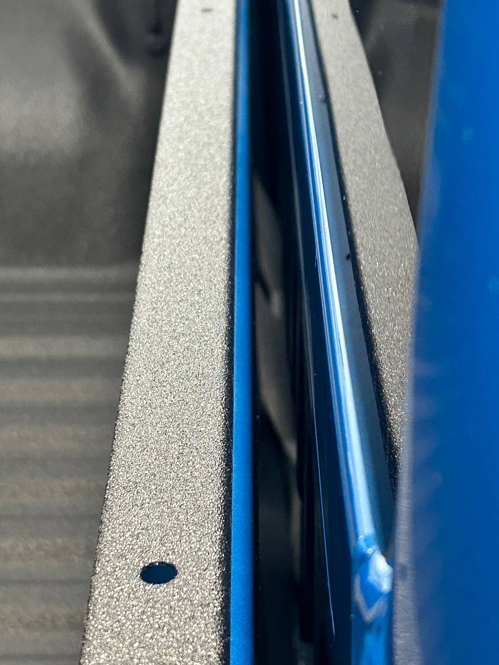

I just checked and mine has the same fiberous foam piece in the same spot. It is starting to seem like an expected piece. I didnt notice it before, but my truck is white so it blends in.

Just checked my Lariat and has the exact same thing...was wondering why I felt like I needed to slam the doors to get them to close...I had to lock my cameras focus in on something else to get a really clear crisp shot of it.
Did removing the foam help with closing the doors?
