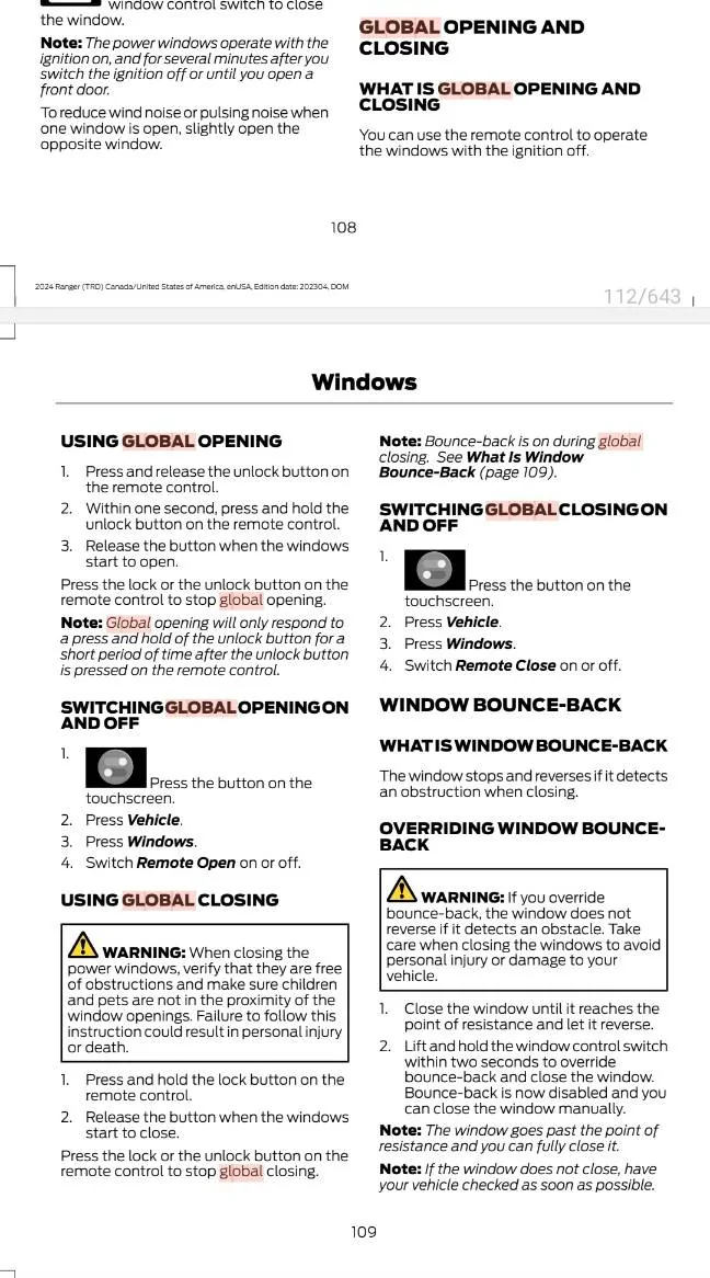

I read this post with interest because I am unsure how this works. In my Bullitt, I press the unlock button twice, holding the button down on press #2 and the windows open. When I lock the car I press the lock button twice holding it down on the 2nd press and the windows close. I tried that on my 2024 Lariat and it doesn't seem to work. Any help would be appreciated.

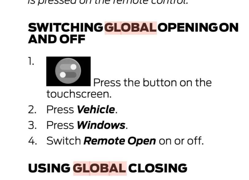

Here is a screenshot from the manual. Hope it helps. Full manual pdf is available from ford online, and a paper copy is usually available thru ebay for 50 or 55. It sucks that it doesn't come with the truck

Thanks so much, John B. I appreciated the screen shot. I will give it a try tomorrow.

Where in Sync 4 do you turn this on? I looked and could not find it.

So this is an issue and Ford is aware of it. Took mine (Lariat, 2.7,FX4, August 14 blend date) in about a week and a half ago to show them that "Windows" wasn't even appearing under Vehicle settings. Dealer took pics and provided to Ford support folks. Took it in this morning to have them try a software fix but it didn't work. So the Field Service Engineer is working with folks in Detroit as I understand it. They'll either have a fix for it or may even be addressed in a vehicle software update. No date given, but I understand it's actively being worked, and understood that it affects more than just my Ranger. As another person on this thread said, I suspect this broke when they tried to fix the earlier window closing issue, and my blend date supports that guess. (Having worked in platform/application support I can't tell you how many times a fix broke something else. Patch and pray as we say!) I'll update this thread after I get a fix or update.

Glad it's not just me. With the info and screen shot John B posted I figured I was all set. When I checked, windows did not appear under the vehicle screen. I was driving past the dealer today and decided to ask about it. The sales manager saw me pull in and came out to ask me if I needed help with something. I explained my issue and he tried and also saw "window" was missing under the vehicle option. He checked a couple of videos on the topic saying there were 3 ways to do it. All failed. He said he never saw this issue before and he'd check with the service manager when he returned on Monday and get back to me.
