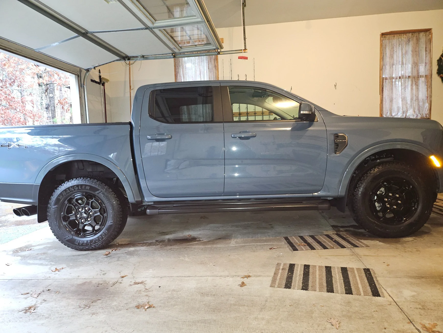

Installed the Goodyear Workhorse AT 265/70/18 on the stock rims and no lift/level or wheel spacers .They ride so much better than the Territorys. A bit pricier than the Territorys but I was able to sell the stock Territorys for $550 (900 miles) which helped. The new tires fit fine and in my opinion look good. I would not go any bigger for 100% stock.
Very nice!
Wow that is a noticeable improvement.
The stance looks good from the profile pic.
They fill the wheel wells pretty much perfect.

Very happy with the look and ride. That is it for mods for me. Added Ford splash guards, tilting rear seat headrests, Borla exhaust, tires, Westin running boards, Putco black chrome letters on tailgate, console box organizer, if I want anything else I might as well go the Raptor or wait for a v6 hybrid. 30mpg this truck would be close to perfect.

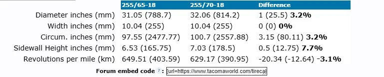

Stock 2025 Rangle XLT FX4 Off Road. Can I put Yokohama Geolander
255/70R18
on my truck without any other mods?
My tires are the Goodyear 255 65 R18.
If my googling is correct the Geolanders are 2 inches taller?
And I bet that won't work without something else like a lift, maybe
more than that.
Any clues would be appreciated.
Yes. I have my snow tires on now which are 255/70r18 on my stock lariat rims. They’re the same diameter as my spring-fall tires which are 255/75r17 I have on method 703 rims.
Would you happen to have any other pics of your truck with those 265/70/18's? Just wondering what the truck looks like from other angles. When I get my ordered Lariat, I'm not so sure the 1.5" level is needed, since yours appears to look fine without it. My '24 F150 Lariat needed a 2" level bad because the 150's come from the factory with way too much rake. It looks to me like the new 6G Ranger doesn't have as much rake as the previous 5G.
