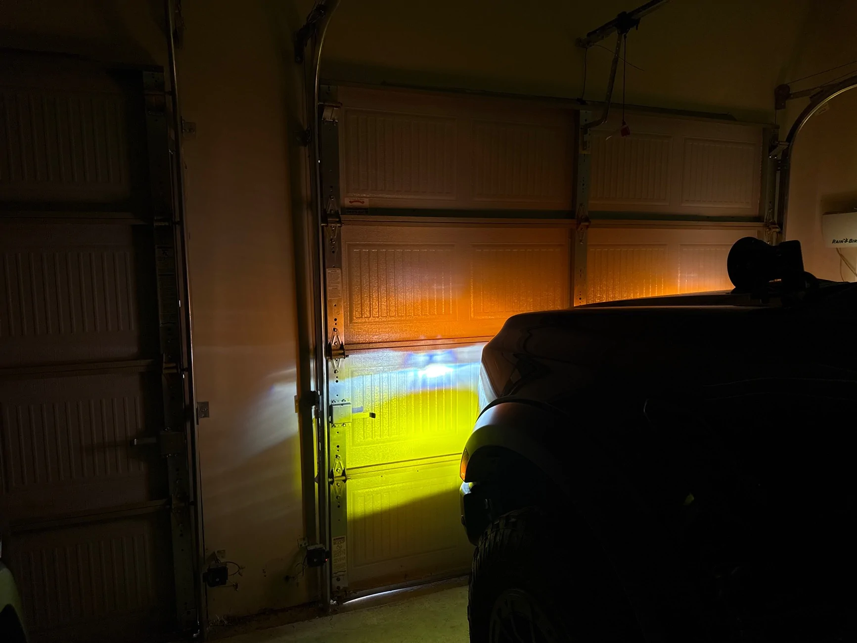

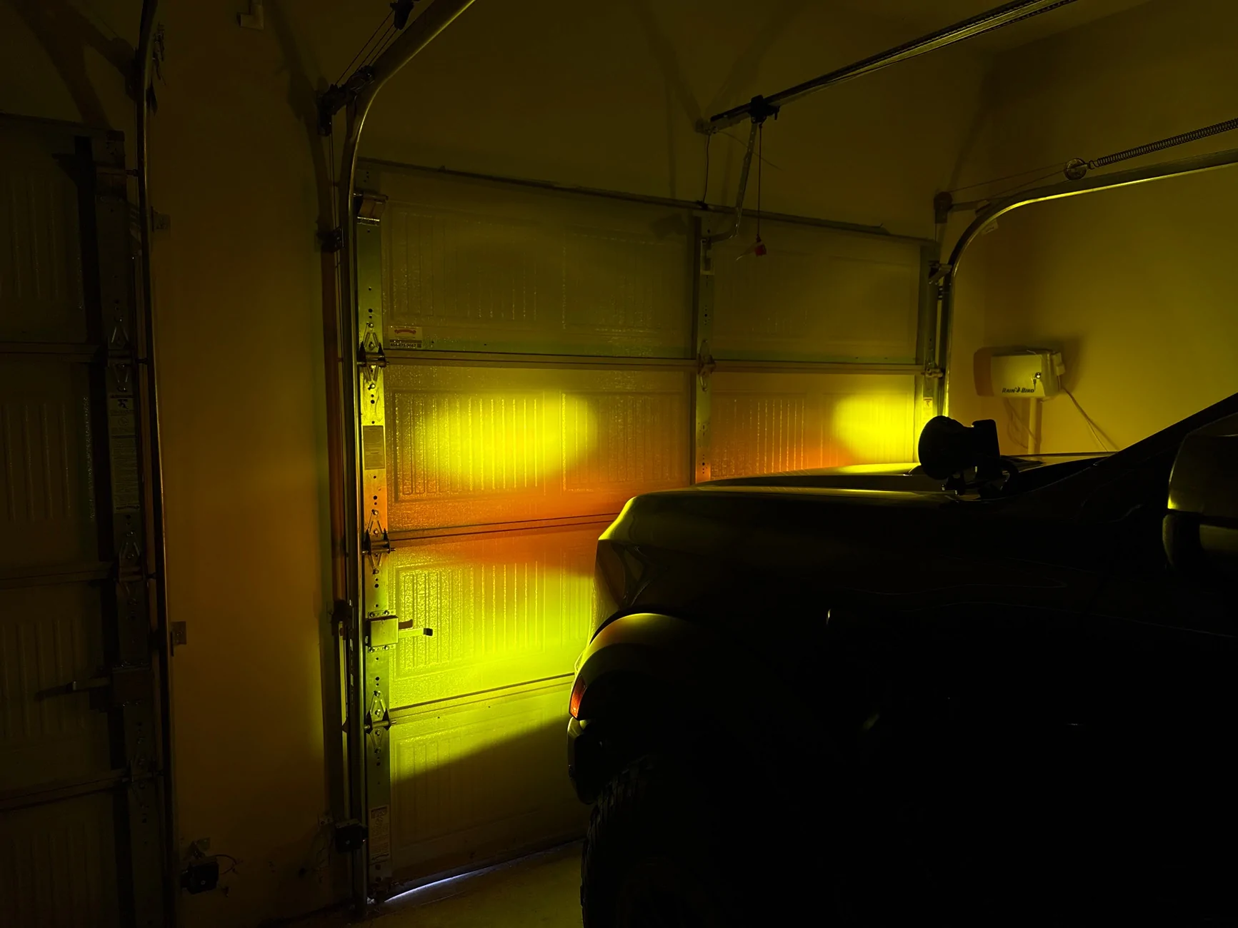

attached a few pictures. First is the S1s and my Ss3 max in Driving pattern. Note the ss3s are on the a pillar. Next is low beams and S1s. Even with only about 18 inches from the bumper to the garage door, the S1s shine high enough to meet the bottom of the low beams
Nice, but to really show the aim you'll need to park on a level surface about 25ft from a wall and look at the beam pattern there. Basically repeat the steps of how you'd aim your headlights manually. That will tell you definitively how your fogs are aimed, and if need any tweaking to not blind incoming traffic.
If these could be aimed I would! The aiming mechanism for our fogs are attached to the OEM housing. These are bolted into the 3 bolts that the factory housing used, but with no aiming ability. I’m sure you could fashion some spacers of some sort if really needed.
