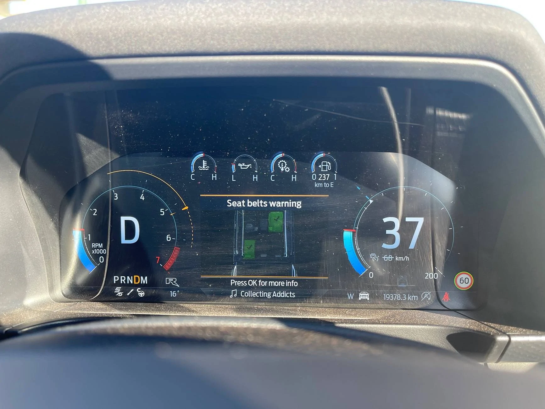

Has anyone tried to turn the little number values for the displayed small gauges. Underneath the fuel gauge it shows DTE. I’d like to also see oil pressure, coolant temperature etc.?
i have seen it turned on but I don’t know what forscan function it is.
I have been able to get most things to display the numerical value except for the oil temperature and oil pressure values, for some reason they are the only ones that I can't get a number below.
I enabled the axle temperature graph as well and it's now available as one of the middle two graphs. All of the changes were in the IPC module and I just searched for "temperature" and changed the values.

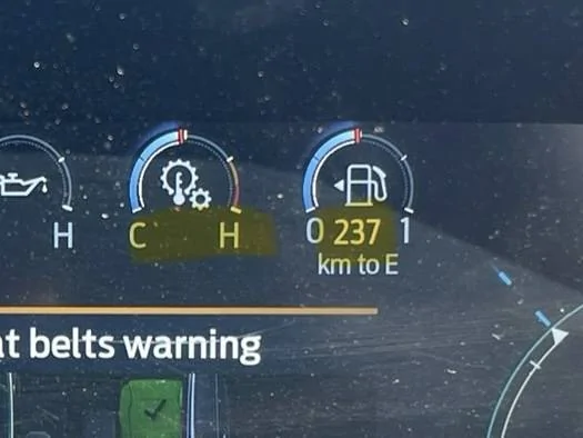

Thanks for the heads up. I tried doing that and had a mix of good and bad results Fuel has changed to, 0 and 1 instead of E and F, I managed to get transmission temperature to work though.
Do you know what you specifically changed?
Ok I figured it out. I needed to force the gauges to alphanumeric then all the gauges showed up correctly. Still would love to get engine pressure.
