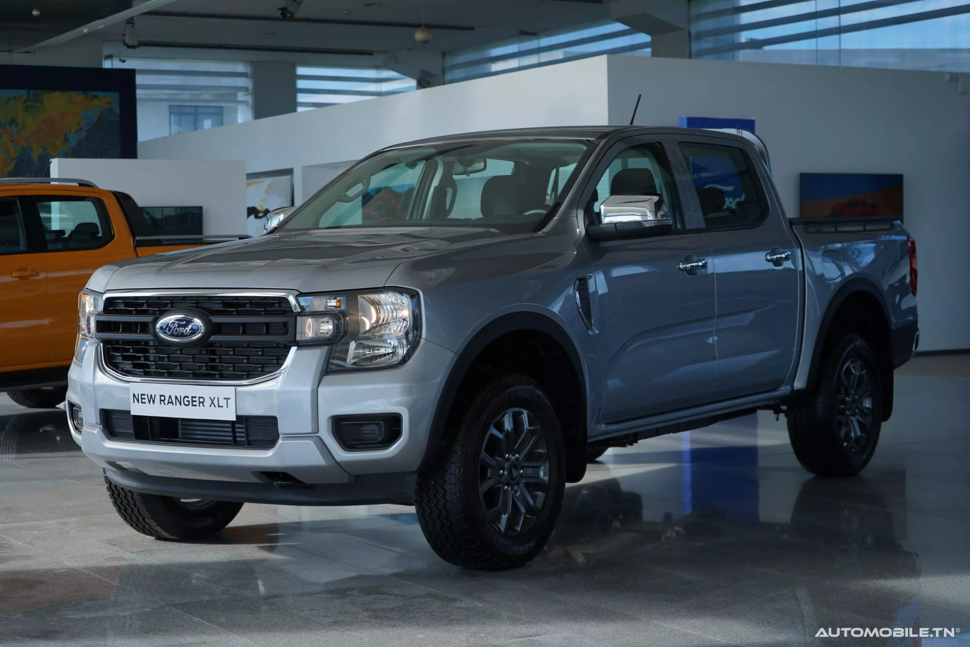

About my ranger it’s a 4x4 AT 2L diesel tuned to 210hp and for the anecdote it cost 53k$ and with financing it reaches 62k$
here is the same model in ford showroom:
https://galerie.automobile.tn/max/2025/01/ford-ranger-2.0-l-170-ch-4x4-xlt-bva-89452.webp
Very cool truck and i wonder if it being a diesel is why you dont have the trans buttons?
I will tell my friend
The only good thing is that it’s a diesel but I am angry about the false advertisement about the xlt trim ! As a previous Ranger generations owner, when I hear or read XLT I assume a certain number of options that I didn’t find when the truck is delivered…
