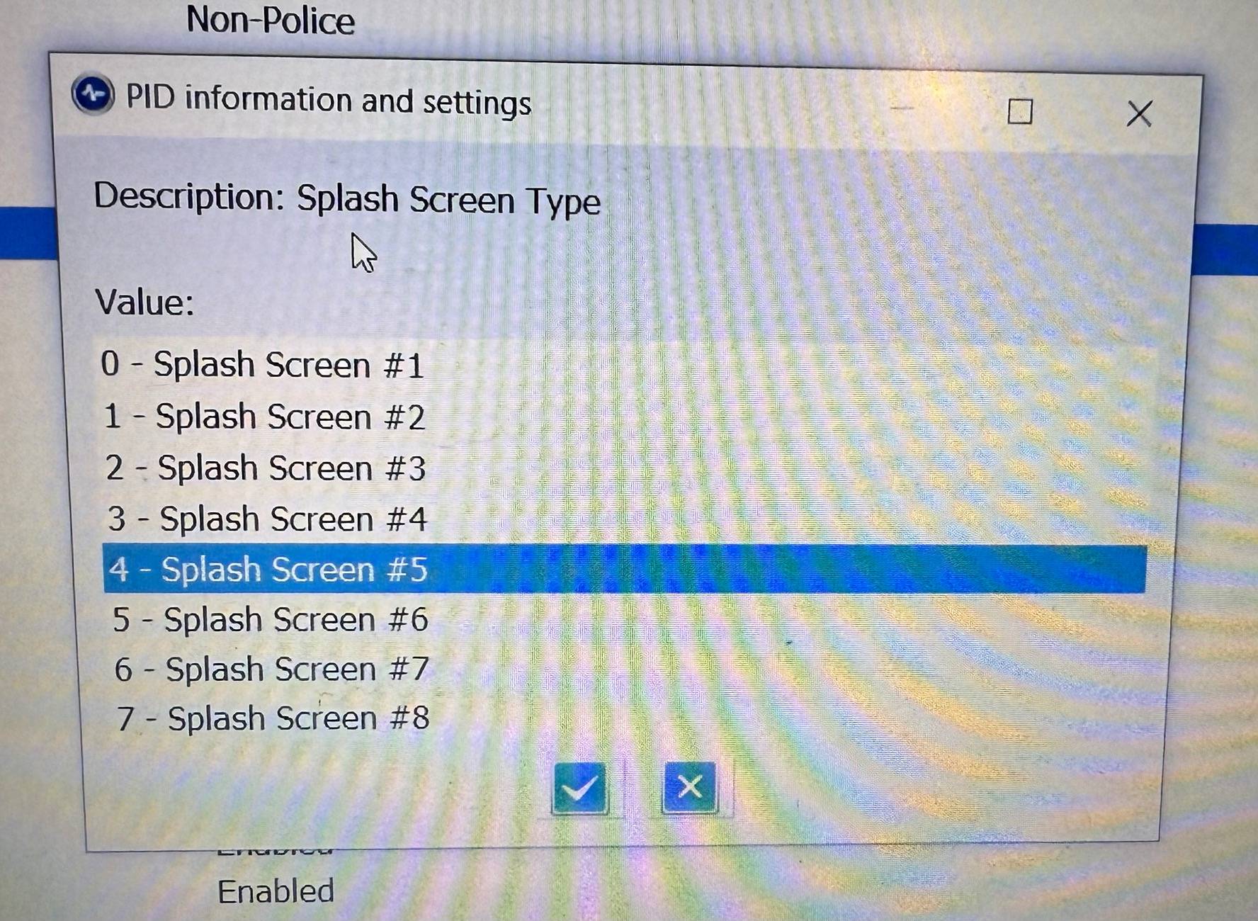

there is a ton of options under the splash screen choice on forscan, though not specific to the ranger other then the ranger one we already have. a long list of all the ford models but i didn't try them, though i thought about it. i was going to change the focus st one since the truck is tuned and then i thought about hte focus rs since that has the the 2.3 but i decided the splash screen already has the same color truck i have so might as well stay with it.... but, there is a lot of choices if you wish try them out
Can you send me a picture of how those options show up to you? Here for me it just shows 8 options, none of them with a real name, just "Splash Screen #".
Ford Ranger FORScan NA Ranger 6th Gen (2024+) Crowdsourced Spreadsheet IMG_0885
I tried them all and none of them seemed to change anything. I always get the exact same animation.
@Sequoia can you help me with that?
Oh, dang, i was thinking of the screen onnthe gage cluster, not the center one. Sorry, wrong splash screen
How to change the one on the cluster? I could not find it.
