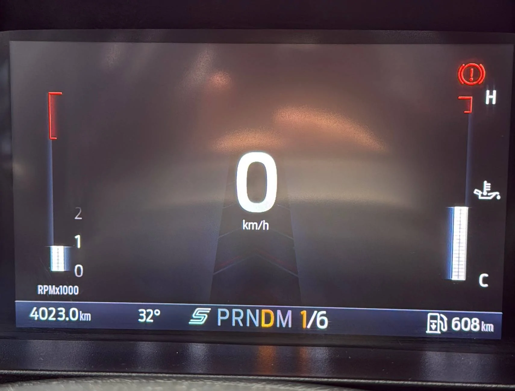

Today I had my first Forscan exploring session.
Here is what I got so far:
- TPMS enabled and fully working
- Turn off cornering light (front fog light turn on when steering the wheel)
- 5 lane change blink
- Changed the wheel/tire (from 255/65r18 to 255/55r20)
- Gear shift indication always on cluster
- Added 04 new driving modes (Sport, Sand, Rock Crawl, Mud)
Later i'm going to try some other stuff.
i need to try those new driving modes and also put the gear indicator on full time. i also want to change the blink to 5

Are u sure that this works?? You would be the first one without a additional box to show the gears permanently!
It worked this morning. Now it's gone again. ?
That's whats happening to you guys?
