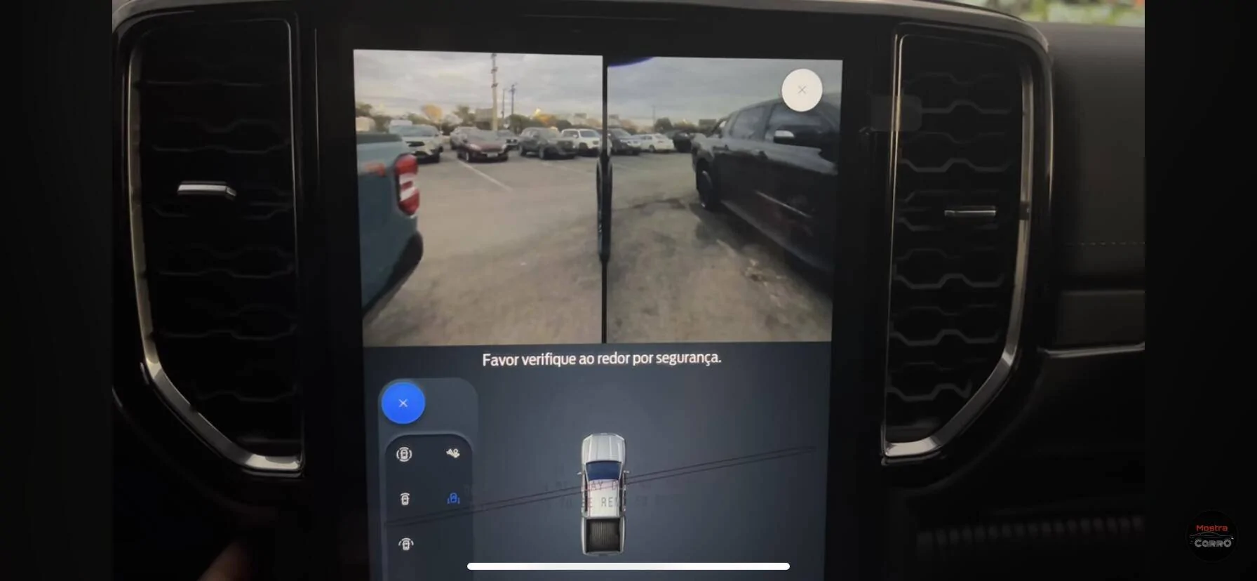

The manual view (klick the button) is working for me. But not the automated one when trailer is connected and turn signal used.
How did you manage to get it ? What are the Forscan changes?
