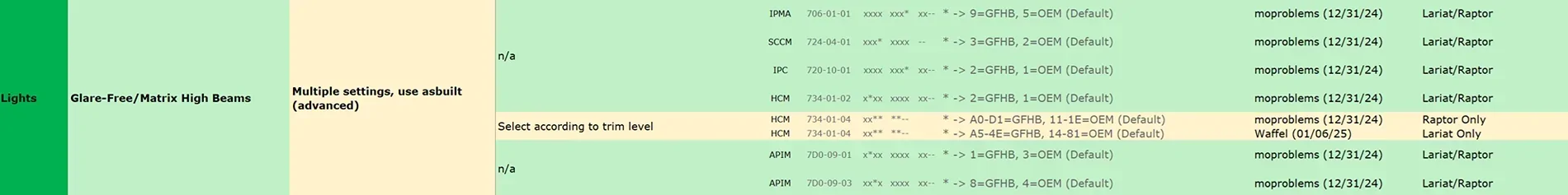

@Patriot_USMC Try following these steps exactly. Don't listen to Google AI or where ever you got those steps.
Ford Ranger FORScan NA Ranger 6th Gen (2024+) Crowdsourced Spreadsheet 1788868592339-rx
Do these in this order. IPMA, SCCM, IPC, HCM, APIM. The settings below are for matrix lighting.
IPMA
Ford Ranger FORScan NA Ranger 6th Gen (2024+) Crowdsourced Spreadsheet MATRIX LIGHTS STEP 1
SCCM
Ford Ranger FORScan NA Ranger 6th Gen (2024+) Crowdsourced Spreadsheet MATRIX LIGHTS STEP 2
IPC
Ford Ranger FORScan NA Ranger 6th Gen (2024+) Crowdsourced Spreadsheet MATRIX LIGHTS STEP 3
HCM
Ford Ranger FORScan NA Ranger 6th Gen (2024+) Crowdsourced Spreadsheet MATRIX LIGHTS STEP 4 AND 5
APIM
Ford Ranger FORScan NA Ranger 6th Gen (2024+) Crowdsourced Spreadsheet MATRIX LIGHTS STEP 6 AND 7

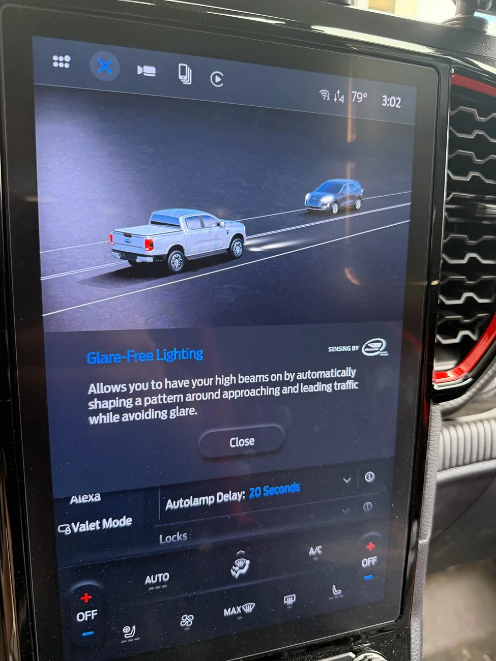

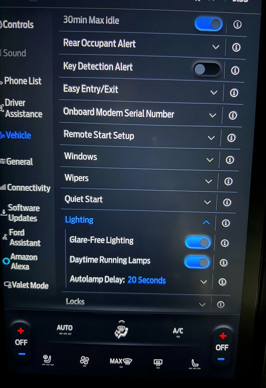

After I changed the modules I needed to cycle the ignition on and off a few times for it to work. You'll know it worked when you go into the Lighting settings for the truck and see "Glare-Free Lighting"

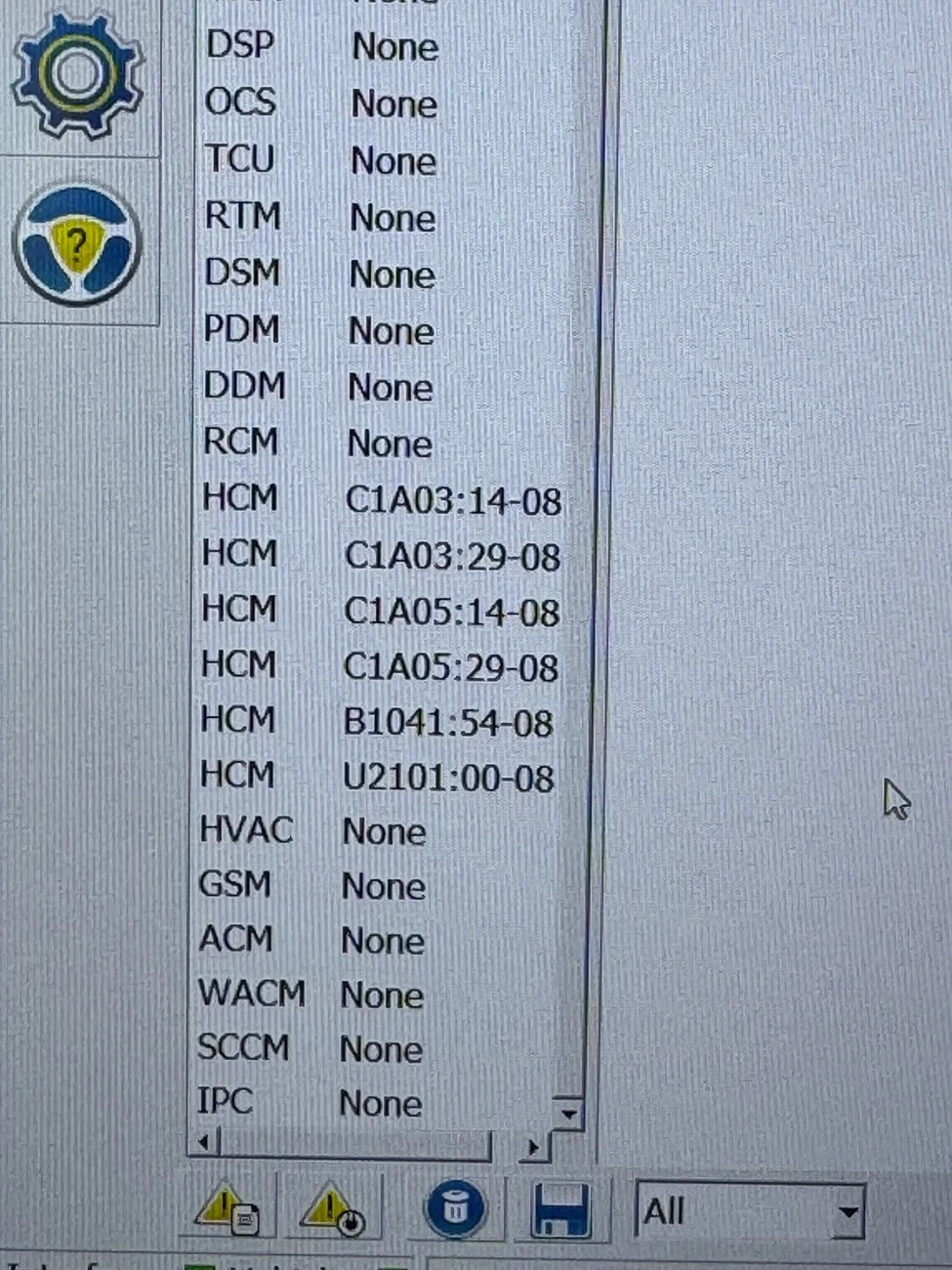

Well I was able to enable the matrix lights, but I have several HCM errors that I can’t get cleared. Ideas?
Try starting it a few times and see if it clears itself. I notice sometimes forscan takes a few key cycles for stuff to fully work

I did 3 cycles back to back, 1 minute ACC power on, 1 minute off, followed by locking the truck with the fob and walking away for 15 minutes. And I've driven the truck 5 or 6 times since and it's still the same.

Dang. Hmm, I dont know than.
