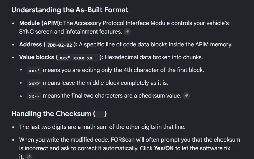

Change the * to whatever it says the change is in that spot of your as built. Your as built will be in blocks of 4 4 4. Hence XXXX XXXX XXXX. The * is what you change.

I asked AI as well, not sure if this all seems correct...

So that I understand as well say they had:
(1112, 1234, 99--)
would become
(1113, 1234, 99--)

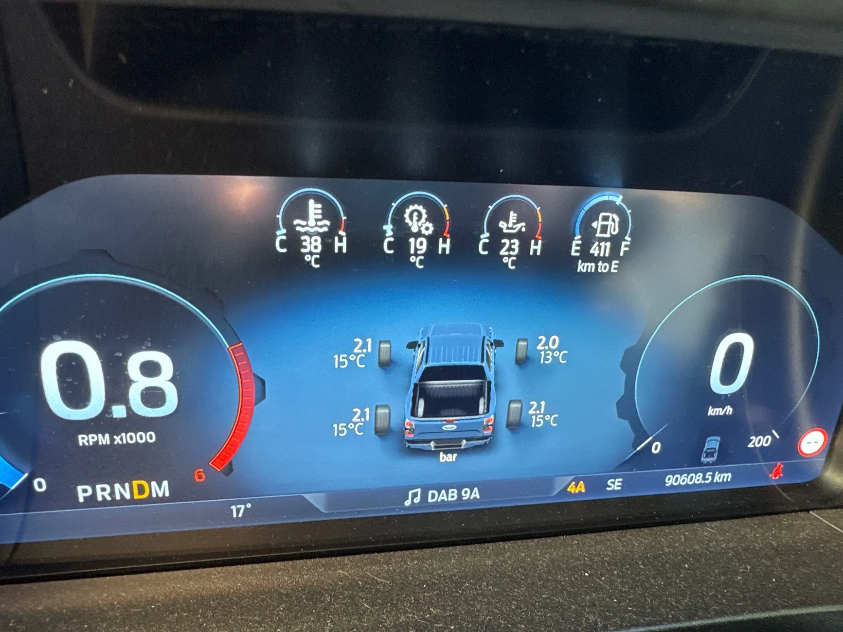

Does anyone know if it’s possible to code a numerical value below the oil temperature gauge? I used forscan to get it for the coolant temp and transmission temp but have been unable to find anything about oil temperature. 24 Ranger Lariat 2.7
joordan
Apr 22, 2024
351
160
Italy
ranger wildtrak 2023
Yes, it’s in the file. I have numerical values on all my gauges
Ford Ranger FORScan NA Ranger 6th Gen (2024+) Crowdsourced Spreadsheet imag
