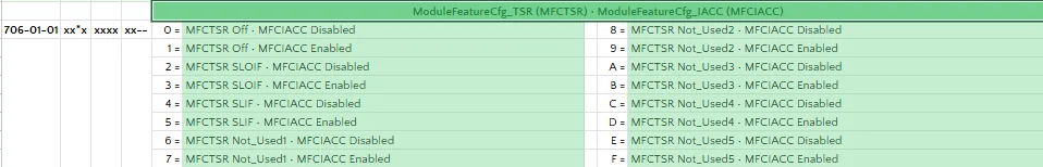

TSR would need to be enabled here in the APIM (possibly other locations in the APIM in your region:
Ford Ranger FORScan NA Ranger 6th Gen (2024+) Crowdsourced Spreadsheet 1787435010100-j9

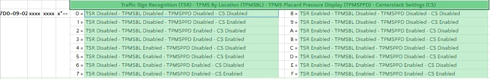

Enabled here in the IPC (possibly other locations in the IPC, too):
Ford Ranger FORScan NA Ranger 6th Gen (2024+) Crowdsourced Spreadsheet 1787435092528-at

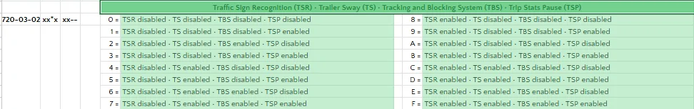

Enabled here in the IPMA (again, may require other TSR related bits to be flipped for it to work):
Ford Ranger FORScan NA Ranger 6th Gen (2024+) Crowdsourced Spreadsheet 1787435204517-r0
Your best option would be to find a Ranger that has it working, pull the ab file from it on the motorcraft site with the VIN, and do a control F on the Ranger spreadsheet searching for TSR in the APIM, IPC and IPMA tabs to see what other bits related to TSR are enabled. However, these three above are the core bits to flip to get TSR to work.

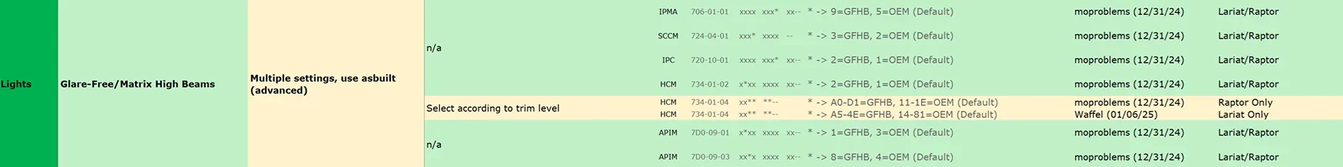

I did this tonight with my 2025. I followed the instructions on the sheet and got it to work.
Did you follow these exactly?
Ford Ranger FORScan NA Ranger 6th Gen (2024+) Crowdsourced Spreadsheet 1788749412029-f0

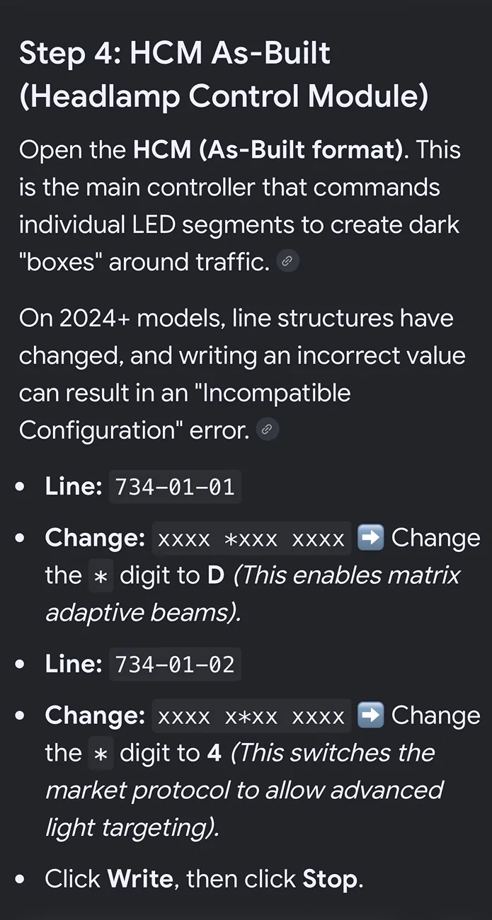

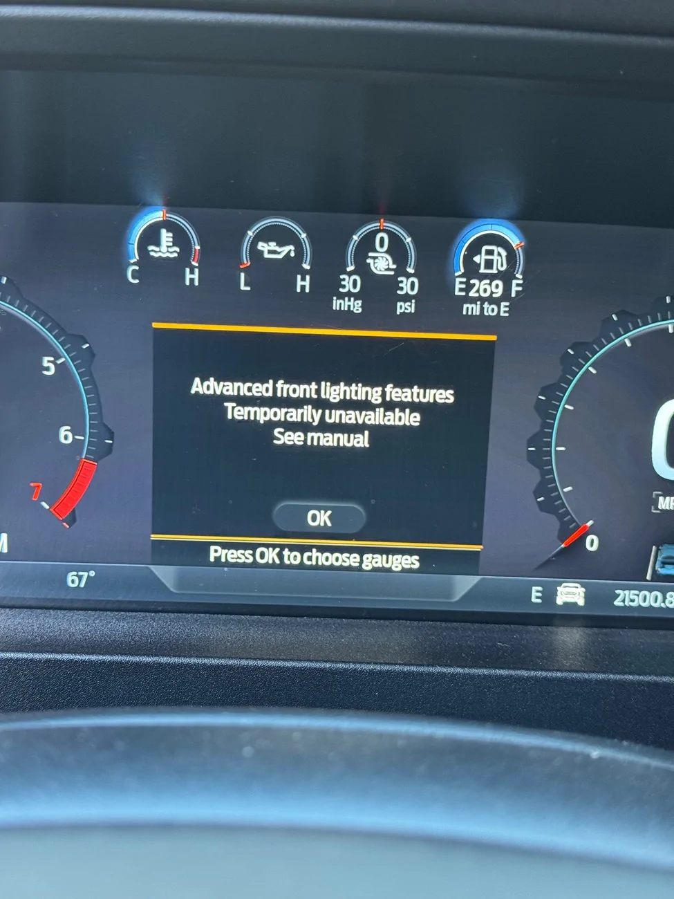

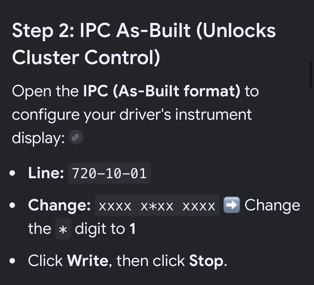

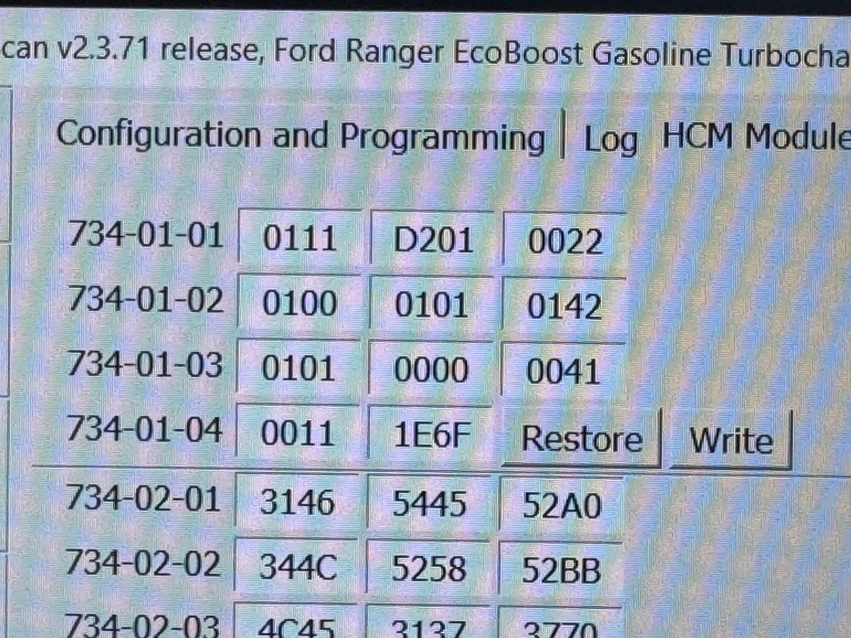

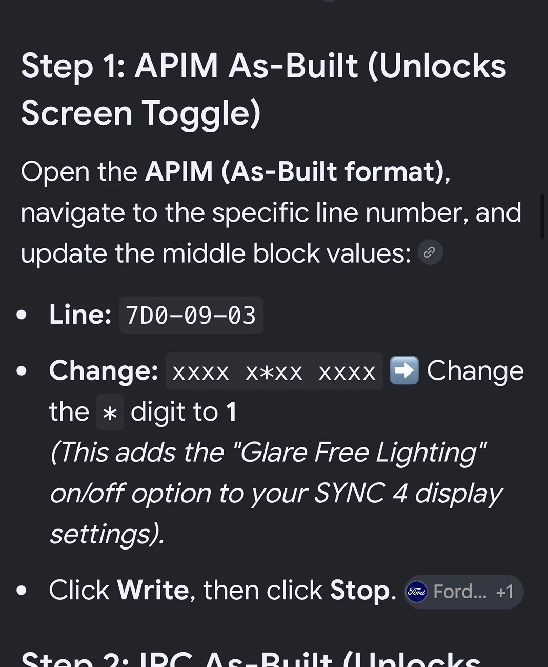

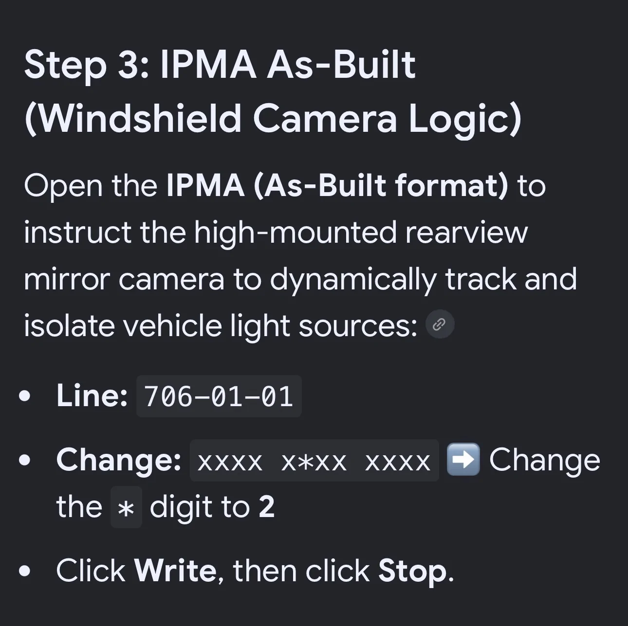

First time user of Forscan. Just attempted to enable the Glare Free/Matrix headlights and couldn’t get it to work. Now I have this error. I used Google Ai for hours troubleshooting, recalibrating ride sensors and headlights. Disconnected the battery for half hour. Headlight calibration fails immediately. Thoughts on how to at least get this error cleared? Tips on how to make the Matrix feature work would be a cool bonus. Thanks a ton for the help! 🙏
Can you post pictures of each module you changed? Maybe you changed a wrong number or letter somewhere .
