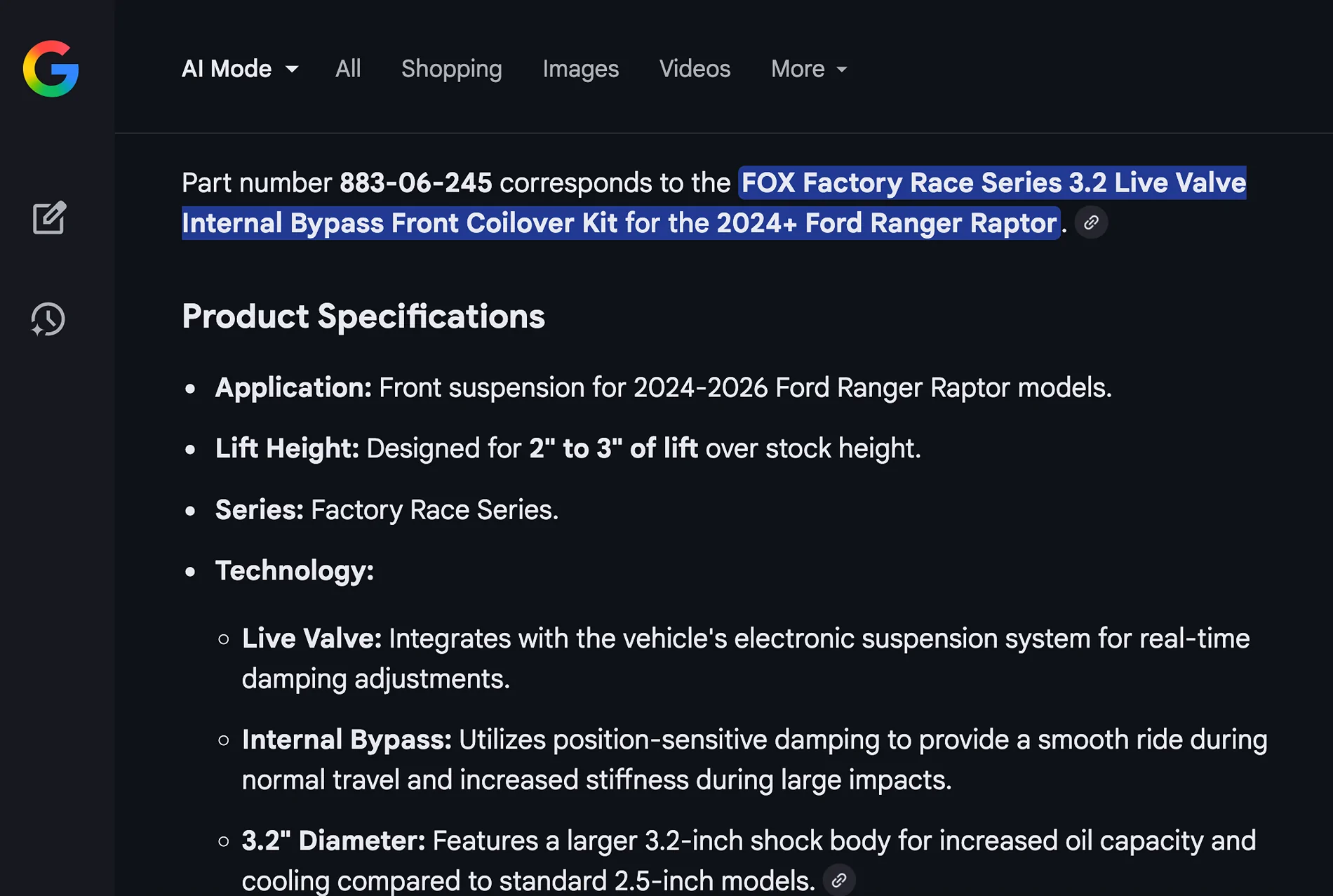

What are you asking? They are not making them, they are AI, most of the people on this thread have talked to Fox about them. Are you wanting to order some? Are you not wanting live valve?
Right now the only new 24+ Ranger Raptor option for the fronts are live valve. I don't know if they will offer non live valve.
I see it now. They just don't have the typical looking solenoid for the live valve.
But yes I am interested if they are still live valve.
