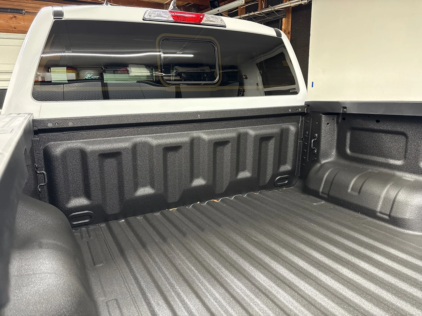

Looking for inspiration on ways to fill the height gap on the bulkhead on my bed. My cap is ready to go on but I have the Ranger 1” gap. Currently I have a piece of angle aluminum I’m considering on using, but that won’t really hold water out unless I get creative with sealant. Thanks all!

Thank you! I failed to mention I have a piece of 3/4” and 1/4” square aluminum too to consider trying. I went to Lowe’s and bought anything that I felt may make sense to fill in the area. Lol.

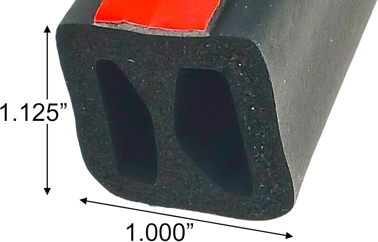

When I ordered a soft tonneau cover, they included a 1x1-1/8" hard foam strip that had adhesive on the bottom. I cut it to length to fill the width of the gap. It seals on the bottom of the cover frame. Might be something you could look into.

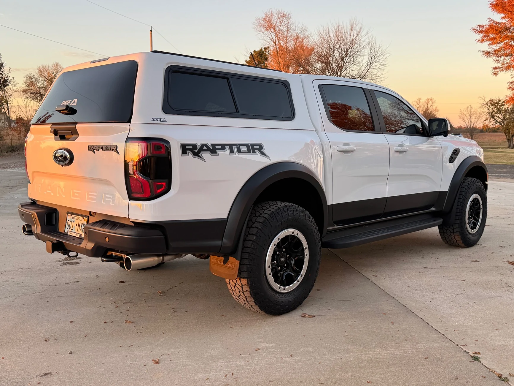

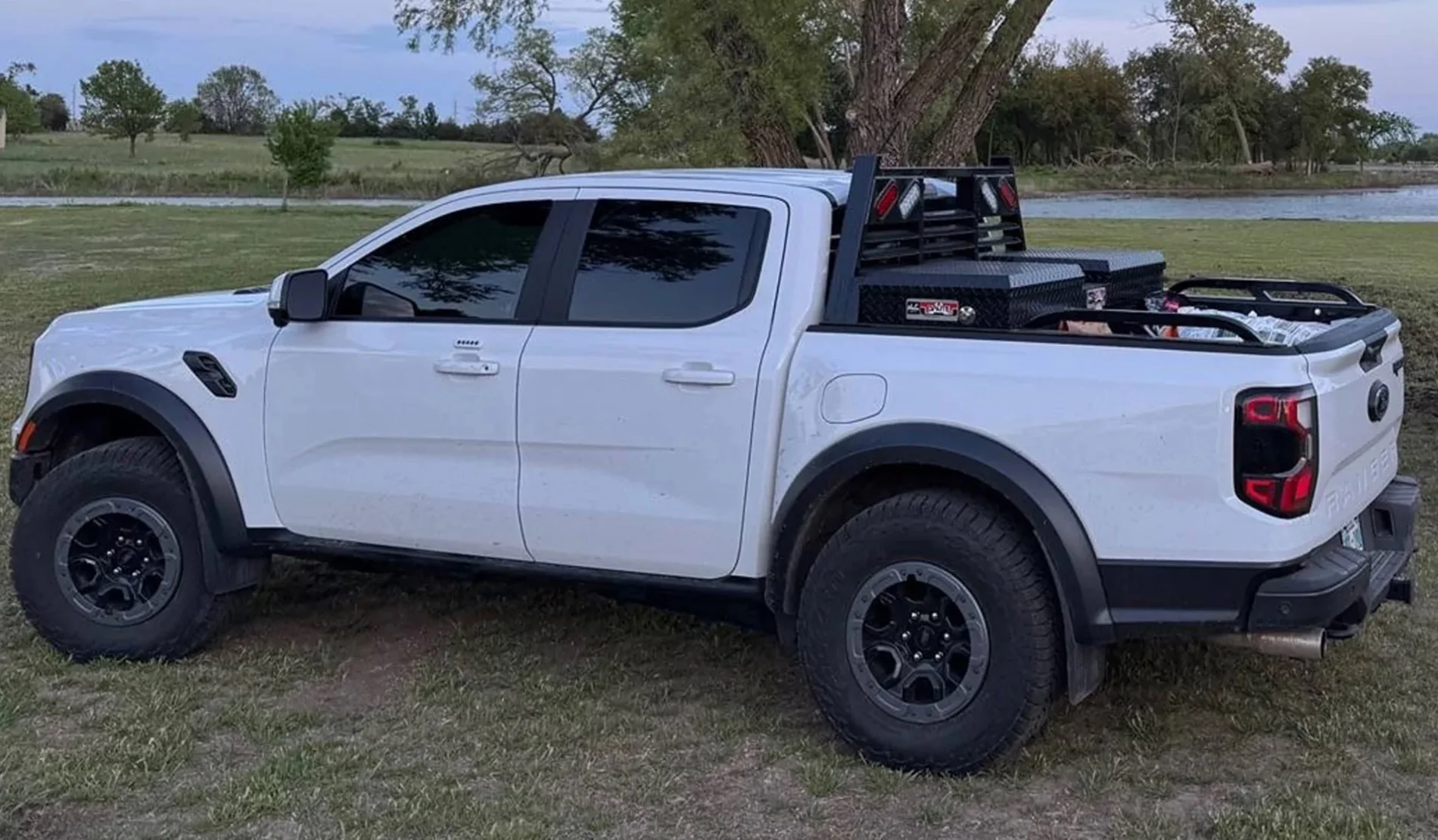

Fixed on both mine, took a bit different pathways to fix on each of them. Lol
ESI EPDM Foam Rubber Seal 1 inch Width x 1.125 inch Height with 3M 4011 Acrylic Foam Tape, Fills a Height Gap from .488" to 1"—5 1/2FT Length
