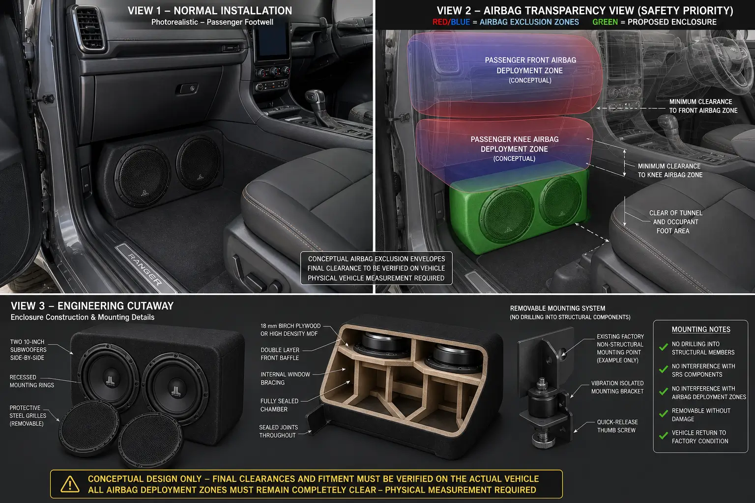

Would this ai design work? your thoughts
Ford Ranger Front passenger footwell - Planning a sealed enclosure for a 12" sub ai design

What is wrong with the under the rear seat enclosure location? Way more practical than effectively eliminating front passenger seating capability.

Bass may be largely non-directional at the very lowest frequencies, but non-directional does not mean position-independent.
In a car, the sub is exciting a small enclosed cabin, not playing into an open field like a PA system. Moving the enclosure changes boundary loading, reflections, standing-wave modes, and—most importantly—the peaks and nulls at the driver’s ears.
An under-rear-seat enclosure can absolutely be a practical and effective solution. There is nothing inherently wrong with it. But it will not necessarily produce the same response as a front footwell sub, because the rear-seat location has a different distance, boundary environment, and acoustic path to the front occupants.
A passenger-footwell sub can make a dramatic difference because it places bass energy much closer to the front listening position and couples it to the floor, firewall, and side boundaries. Depending on the vehicle, that can increase output in certain frequencies and avoid a cancellation that exists with a rear-mounted source.
It also helps the upper-bass/midbass region blend with the front doors. Roughly 70–150 Hz is where much of the kick, bass-guitar attack, and punch live. That range is much more sensitive to timing, phase, and location than deep 25–50 Hz sub-bass. A rear sub may play plenty loudly, but a front sub can make the bass line sound as though it belongs with the front stage instead of arriving from behind you.
The PA analogy is only partly applicable. In a venue, subs are often placed where they are practical because the space is large and listeners are farther away. But even in live sound, sub placement matters greatly—engineers use placement and arrays specifically to control cancellation and coverage. Inside a car, the cabin is tiny, reflective, and irregular, so those effects are even more pronounced.
And no, the goal is not automatically a bigger cone. Cone area, excursion, enclosure volume, amplifier power, and tuning determine how much deep-bass output is possible. The point of a front-sub setup is mainly better response and integration at the front seats—not simply more volume.
Under the rear seat may be the more practical location because it preserves passenger foot room and may allow more enclosure volume. It can work very well. A passenger-footwell sub sacrifices some practicality, but it may produce much better front-seat impact and smoother integration with the door speakers.
Neither location is universally best. The cabin is part of the system. The best location is whichever one measures and sounds best at the driver’s seat after crossover points, polarity, time alignment, and EQ are properly set.
“Bass is non-directional” is true only in the sense that very low notes are hard to localize. It does not mean the subwoofer can be placed anywhere with identical results.
