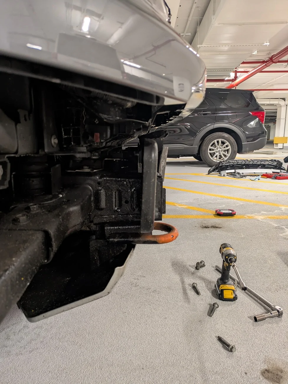

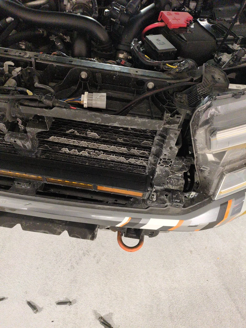

Should be able to get it apart again and try to straighten when I'm back at work, possibly not til Tuesday due to the storm. I'll get more pics for you then. Taking a chain as a backup as I'm going to try first with a tow strap/tree saver/soft shackle setup so that there's no metal involved in the pull.
Hope that goes well for ya. Is the bumper all you have to work with to get things back the way they should be?
I think so, at least that's all I'm going to do mechanically. Hoping it'll straighten things out a bit.

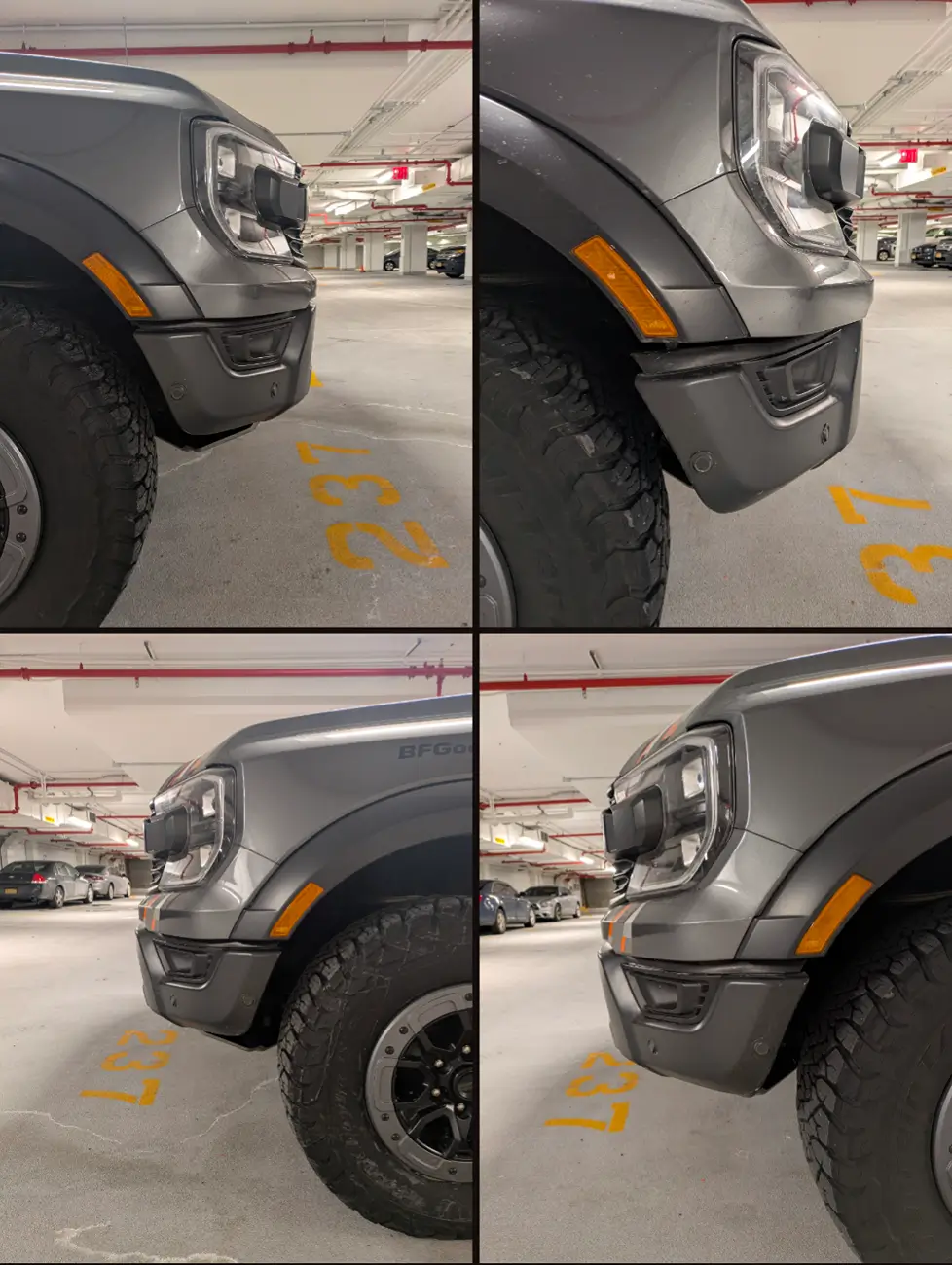

Noticably better. Before on the right and after pics on the left. The driver's side is not as dramatic a difference as the passenger.

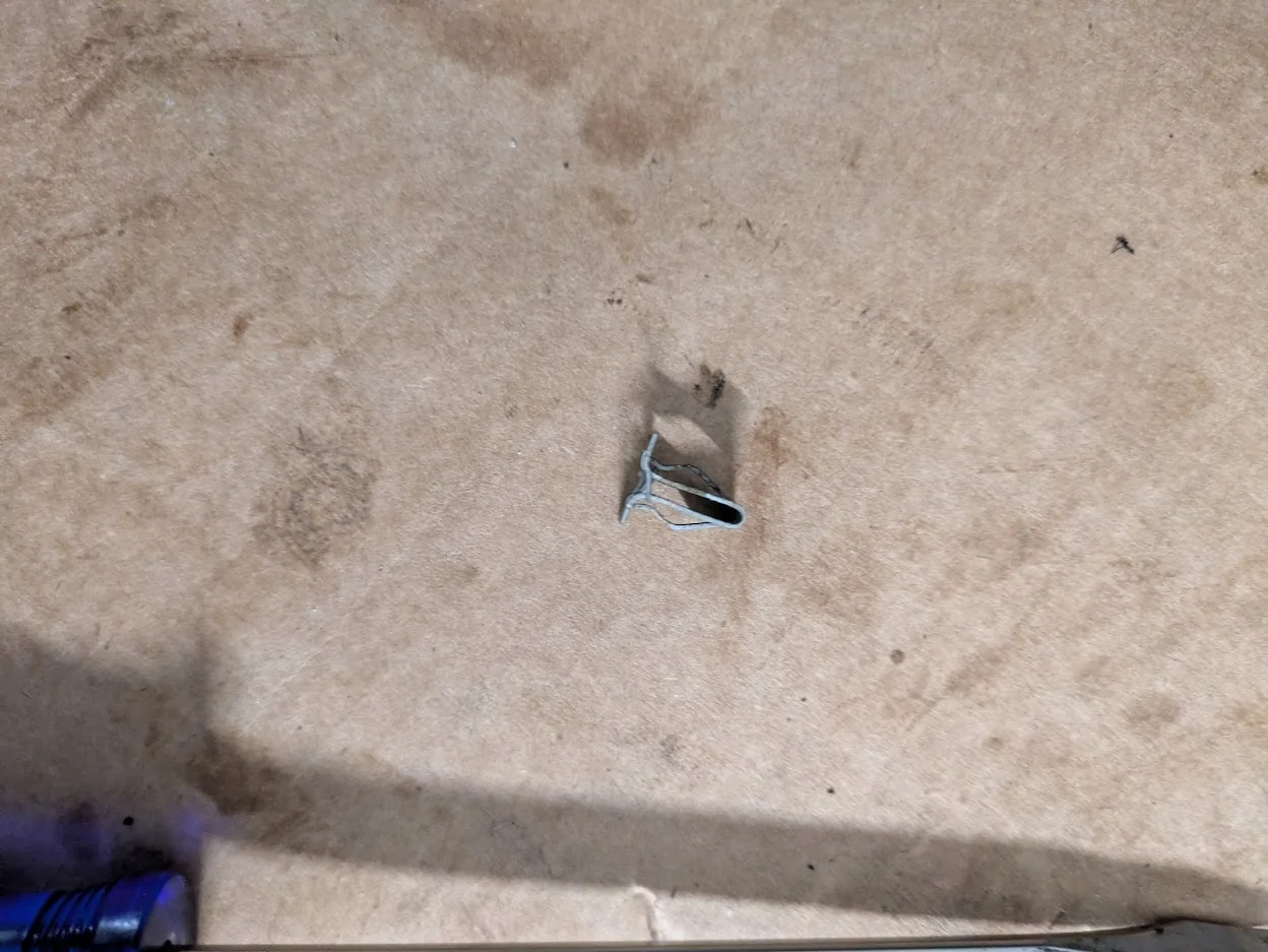

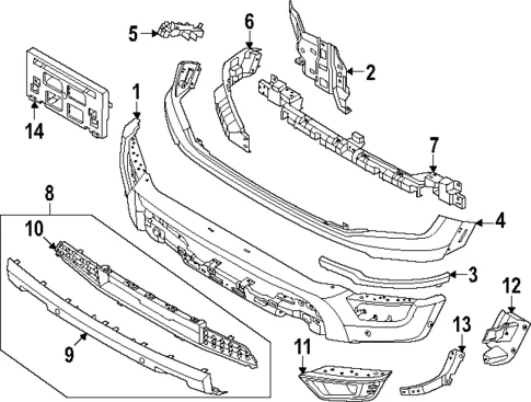

These little suckers, that allow the plastic tab on the "lower grill" (number 10 in the parts picture) to grip into the slots on the metal bumper, are a pain to remove and reattach. I would like to pick up a handful of them as I mangled a few during the three times I had it apart and back together the last couple weeks.

i have found them in the self help section at the local hardware store, oddly
Really? I will definitely go look for them. Interesting.
