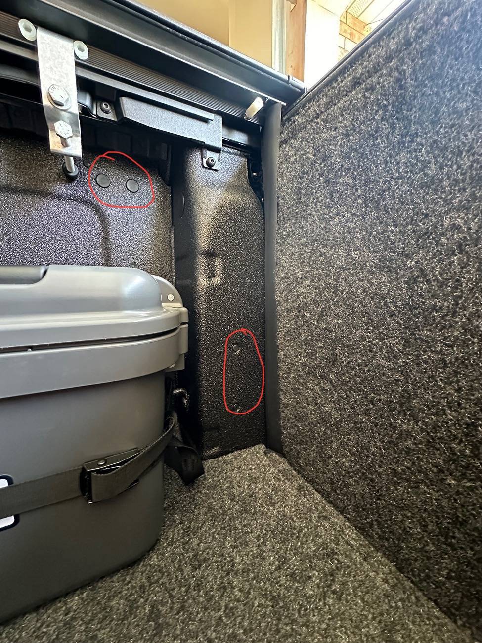

There are all kinds of holes in the bed that let in dust. See pic as an example.
I tried to plug every one of them. Very tedious work but it seems to have paid off.
I feel like an idiot that I didn't think of that. Genius idea to buy rubber plugs! I know a lot of the holes are M6, but not seeing any larger kits on Amazon that have plugs smaller than M7. Which kit(s) did you order, and what sizes did you use?

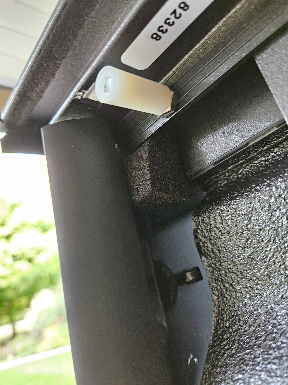

Gary - You were right! Went to Lowes and bought 1"SQ expandable weatherstrip and it worked beautifully! It's comes compressed at about 1/4 or 1/2 on the roll but when it is cut and put into place it expands to 1" forming the perfect seal between the bottom of the Tonneau Cover frame and the side of the Keko bracket. I stuck a 2" long strip vertically on the side of the bed in back of, adjacent to, and against the Keko bracket so it could expand out - and a tad bit to the side. It formed a perfect seal. Decided not to go thru or put it in front of the bracket. It formed just as good of a seal looks a lot neater behind the bracket.

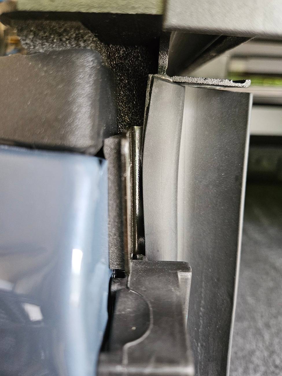

Here it is. At first glance it looks like the water would still get in - but the weather strip is up tight
Ford Ranger 1/4" gap around the whole tailgate of Ranger Raptor 20240926_182142
Ford Ranger 1/4" gap around the whole tailgate of Ranger Raptor 20240926_182339
against the Keko bracket and is sealing it.

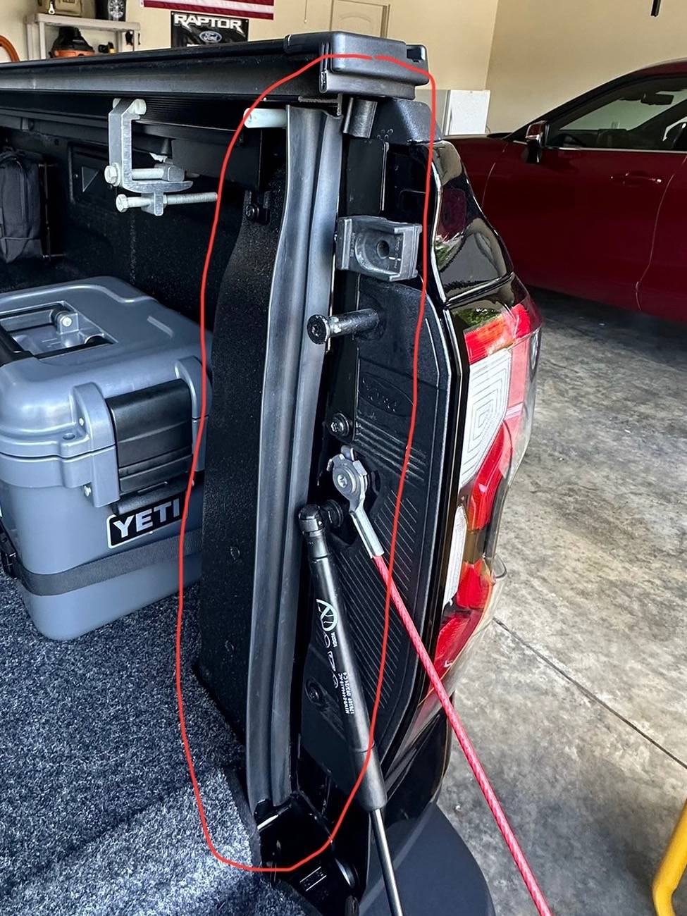

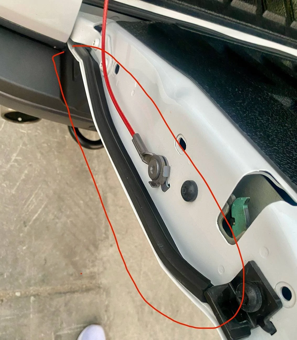

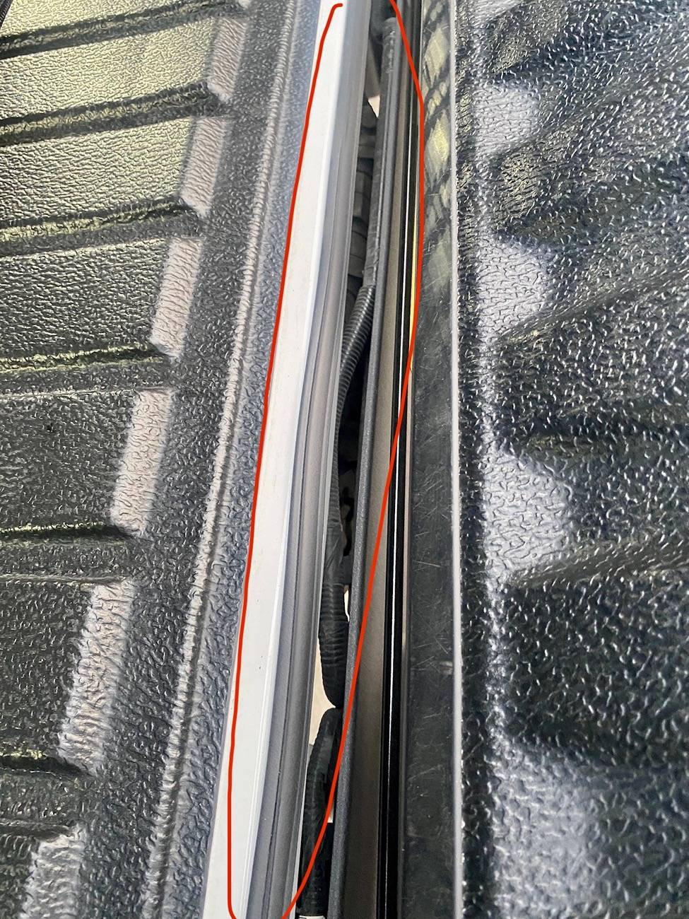

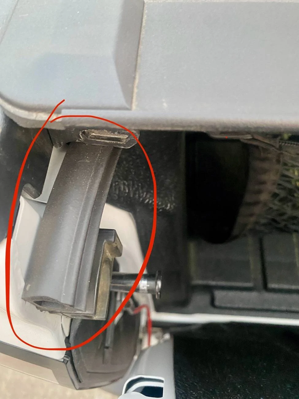

Got this kit because it was affordable. Despite a review saying it wasn’t compatible with the 2024 Ranger, I tried it, and it works. Installed it where it seemed best, and now the dust problem in my Raptor bed is gone.
Looks sweet ! Do the two pices on the sides of the tailgait (nice idea!) come in contact with the bottom piece ? And I'm assuming you can't see through the side gaps of the tailgate ?

Yes, the gap between the tailgate and the sides of the bed is sealed, so you can't see through anymore. Also, it’s possible to have the two pieces on the sides of the tailgate make contact with the bottom piece, but due to the protrusion of the hinge on the lower part that closes the gaps, I chose not to extend the seal below that point. As I mentioned, I installed it without following the instructions, just in the way I thought would be best.
