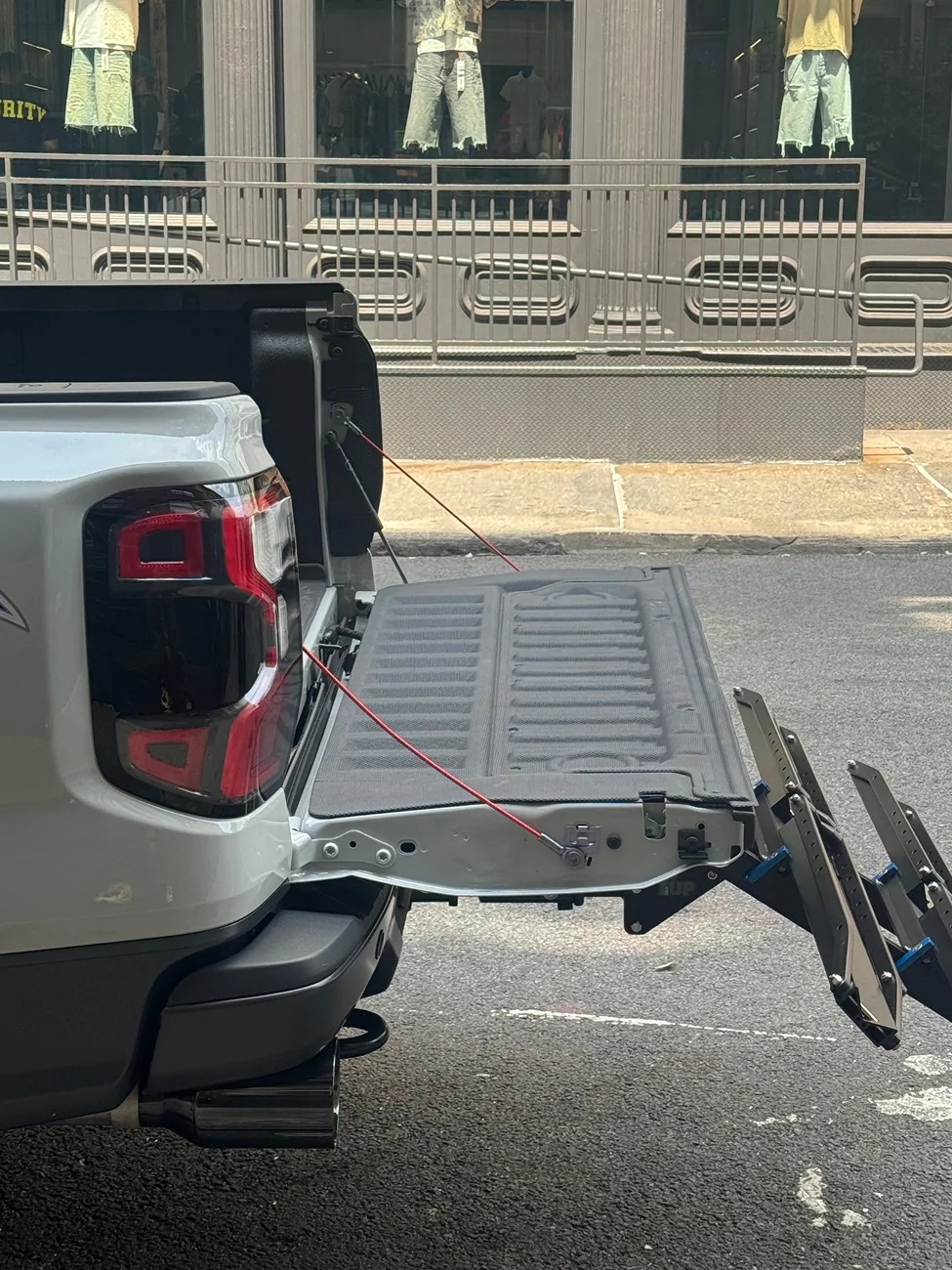

I just noticed this on my new 2025, only it's a lot more slack than I saw mentioned by anyone here. I can get a full 2 inches of lateral movement out of the driver's side cable measured in the center. I can sit on the tailgate and the cable remains loose, it's not doing anything.

Can confirm, mine is like this too. The theory about the passenger side being tighter because of the gas strut, makes sense. I thought it was stretched out because I always sit on the driver side of the tailgate
